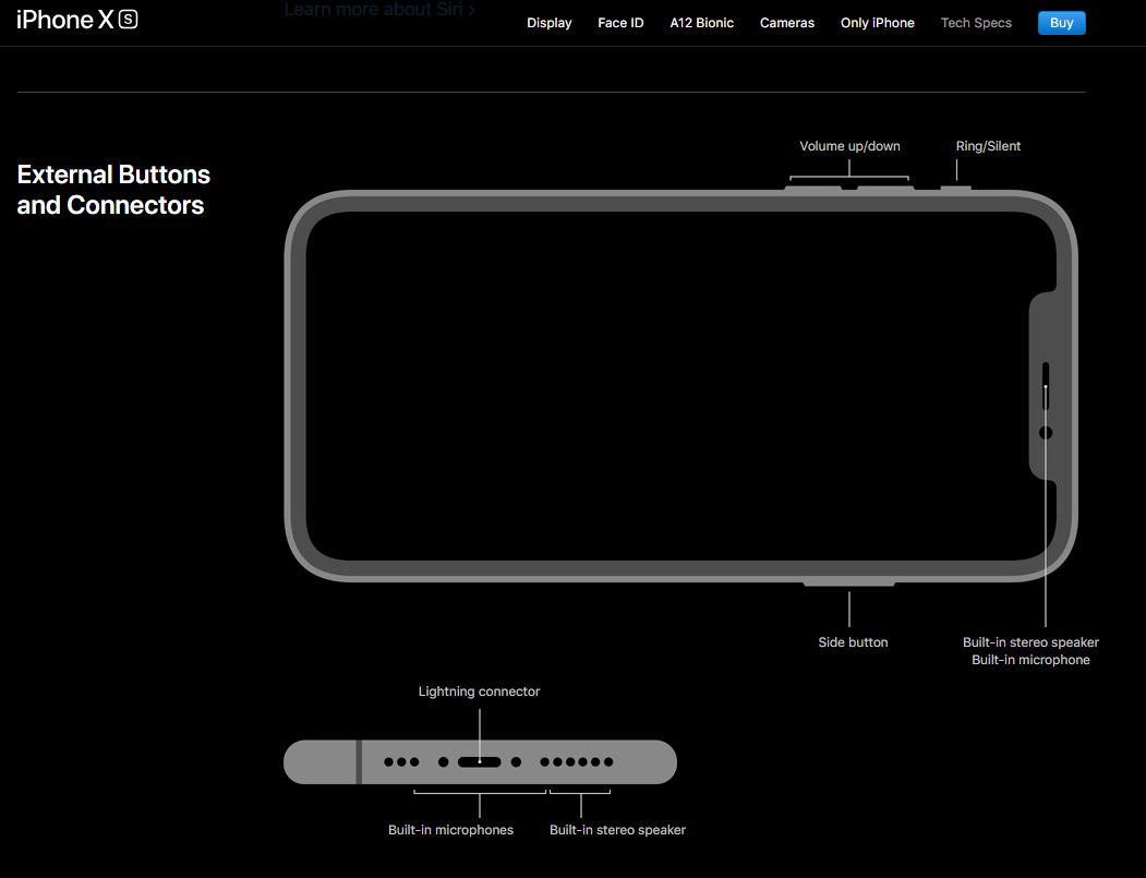

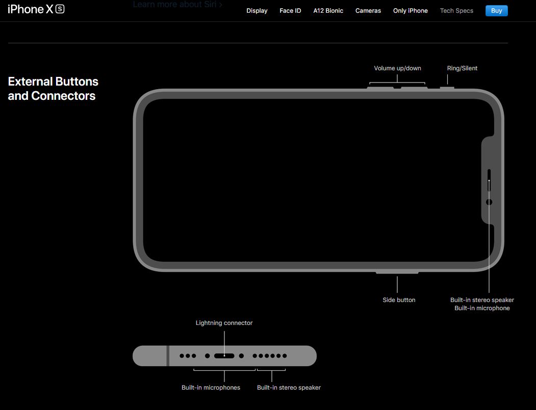

I went to apple.com and had a chat with someone in support about the issue and they said there was no speaker in the upper ear piece.
Can someone confirm that they have sound coming from upper speaker when playing music/podcast
Shouldn't have to confirm an Apple advertised feature since the iPhone 7.
