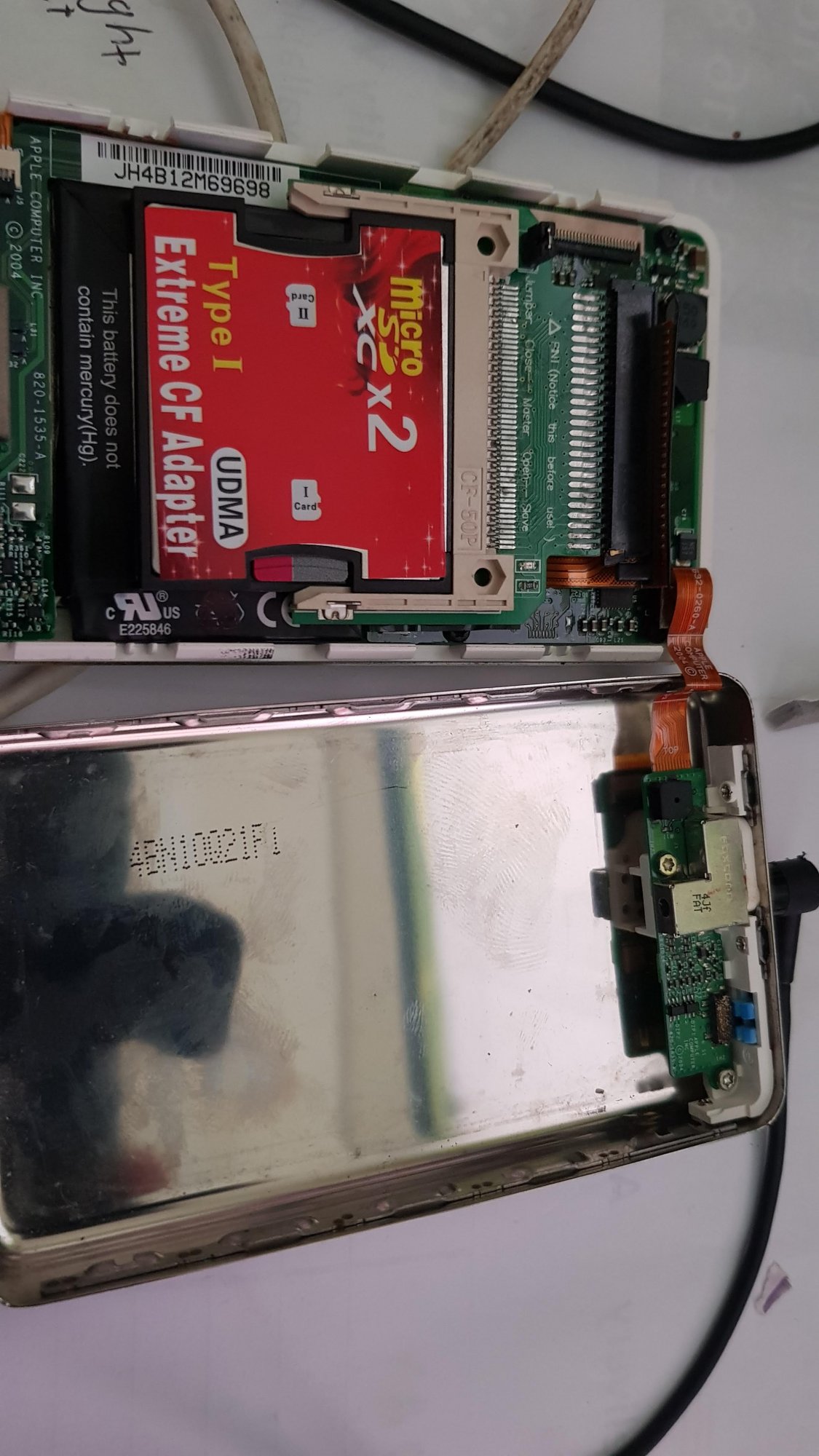

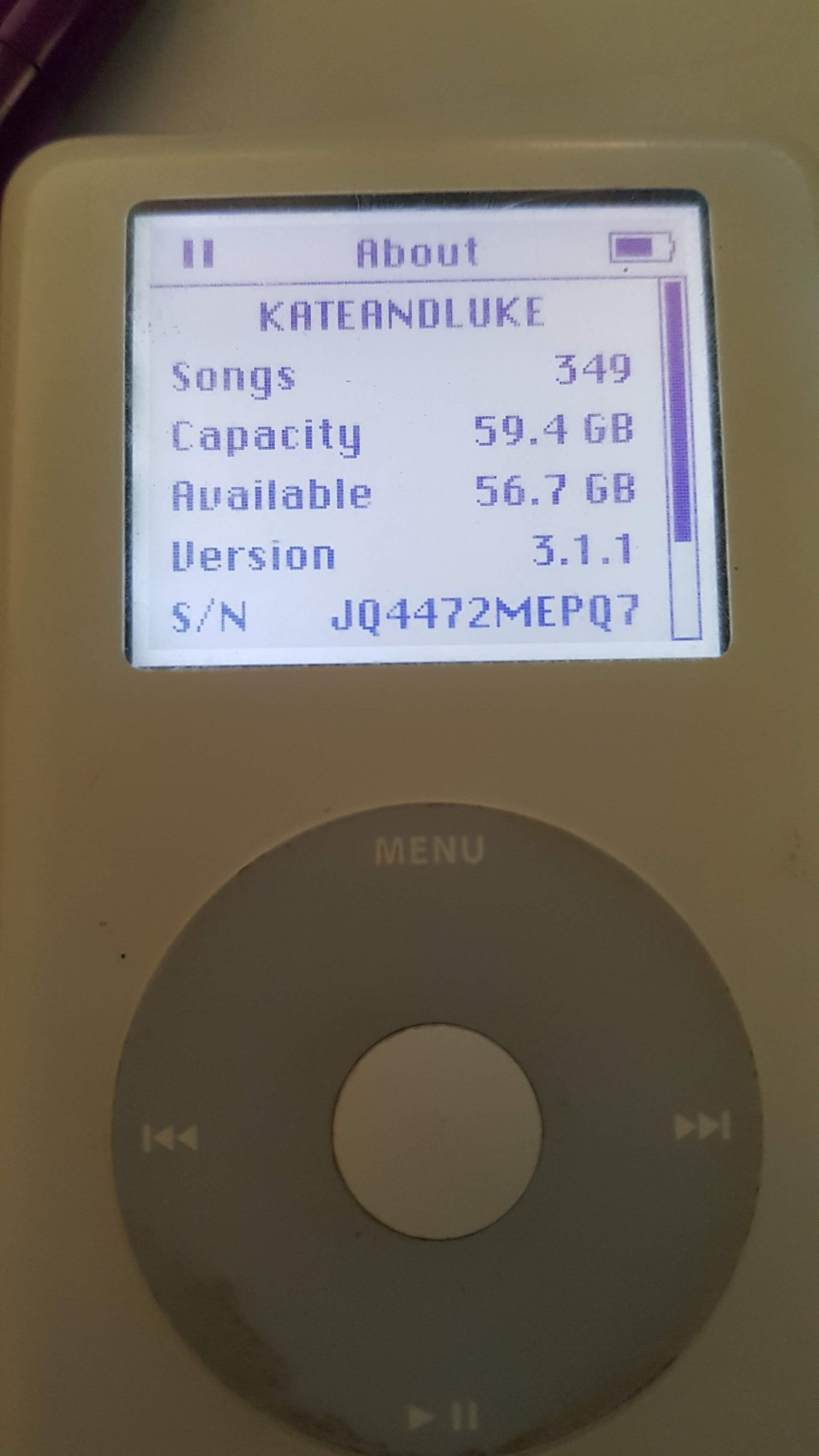

SUCCESS !!! Actually unsure exactly what I did different.
But now have a functioning 4th gen Classic upgraded from 20gb to 60GB!
1) With the ipod connected to the computer with it's usb cable:
2) Deleted all partitions with AOMEI Partition manager.
3) Rebuilt MBR with AOMEI.
4) Created a Partition as Fat32, with "SSD" Checked, and Optimized.
5) Rebuilt MBR with AOMEI.
6) Started restore in Itunes.
7) While Restoring, I went back to AOMEI and set up the MBR Rebuild with 1 button left to confirm actual start.
8) As soon as Itunes restore stopped, I started the MBR Rebuild.
9) Got the "Plug into wall charger: Icon ON the iPOD !
10) Plugged into Wall Charger (the one with the firewire type cable)
11) Immediately saw the iPod screen showing a restore progress.
12) Under 30 seconds later, I have a working 60GB iPod !
I do NOT guarantee that every step above is needed. But it worked for me.
A BIG thank-you to everyone who offered ideas and advice !
Pete

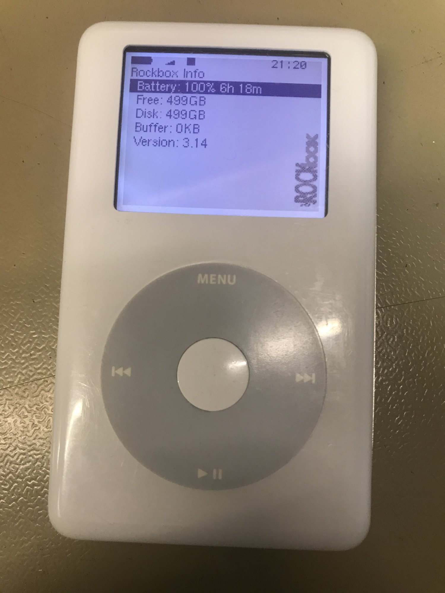

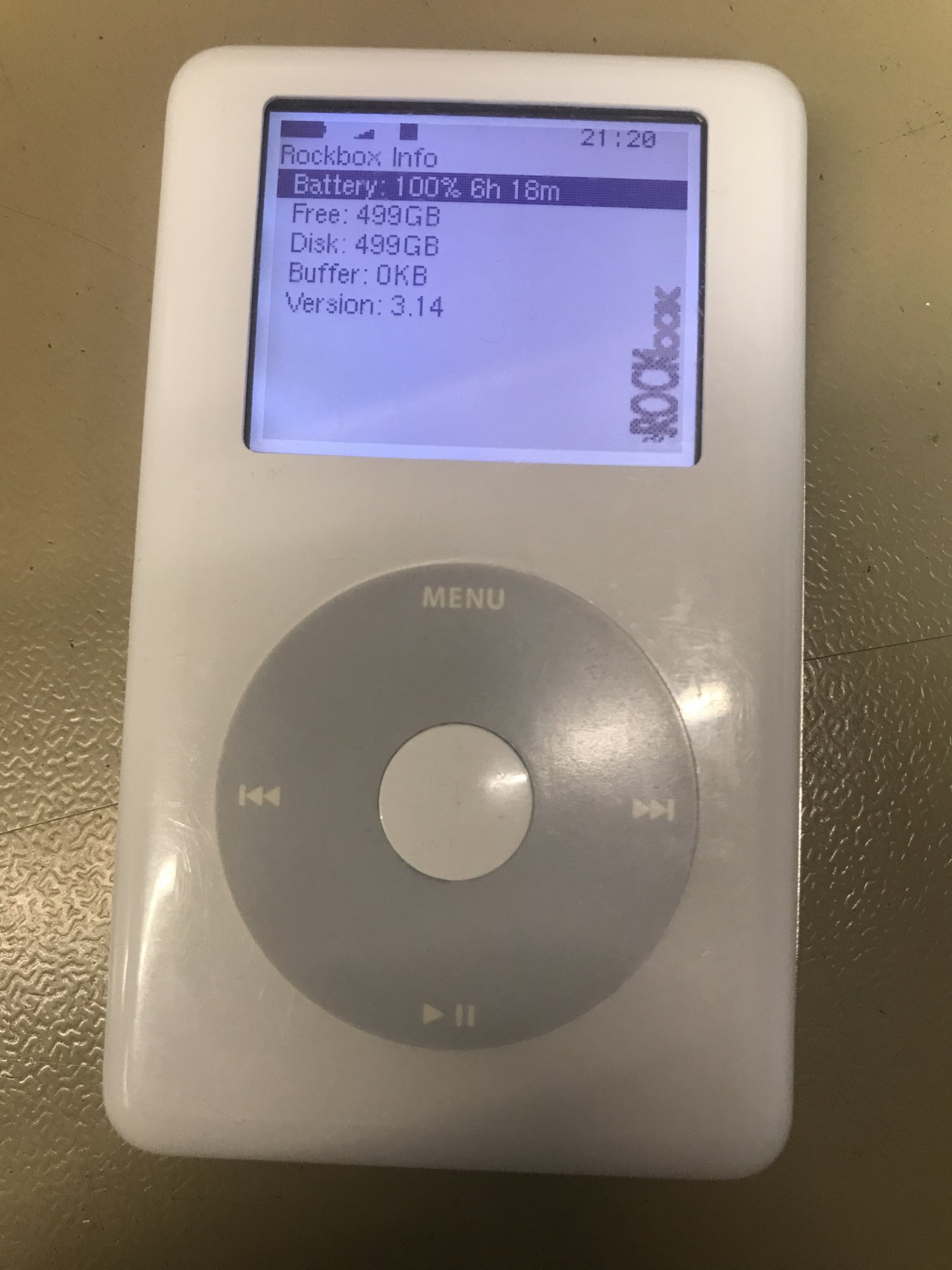

Followed to the letter Pete's suggestion and voila! 4th gen with 500GB SSD formatted Fat32 and restored iTunes Windows 7!

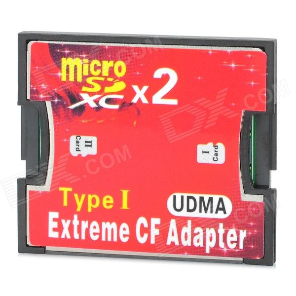

Hello,
i had the same issue for a while and found a solution.
  1. Setup your CF adapter with SD card arrangement you would like to use. If you want to only use one MicroSD make sure you put the SD card in the correct slot. If you are unsure check the size/capacity of the CF card. If its 30MB then move the SD card to the other slot in the adapter and you should have the same capacity of the single card. Dual card set-ups need to be matching (I am using 2x 64GB) and when mounted should show the combined total size.
  2. Download Easeus Partition Master - and plug in the iPod with installed CF adapter and CF card in to your PC.
  3. Drive should now pop up and use the above partition tool to format the drive to FAT32. Remember to apply the settings or the drive wont format.
  4. Now this may sound weird but right click on the iPod drive in the Partition Manager software and hit rebuild MBR. Do not hit apply yet.
  5. By this point iTunes has most probably complained about the iPod and wants to restore the iPod. This is the tricky part. We want iTunes to restore the iPod and when the restore progress on the PC hits 100% we want to hit the apply button in the partition management software before the iPod reboots.
  6. If it worked then you should be greeted with "plug iPod in to wall" icon and doing this allows the iPod to finish restoring and you will have a iPod you can now install Rockbox on.
I have no idea why the adapter needs this process and normal CF cards do not need this process.
source:

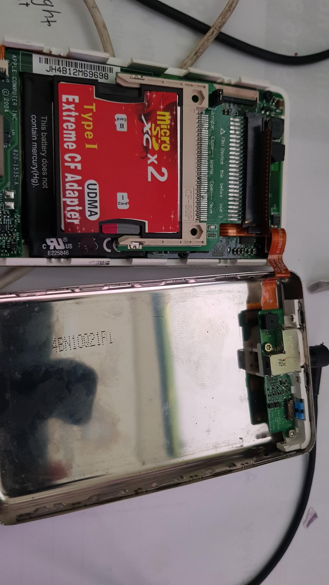

Thanks so much for this help. I can confirm the method above worked for me with getting my 4th Gen Classic iPod (820-1535-A logic board) to work with the following parts:
SanDisk Ultra 64GB Micro SD Card
I was having all sorts of problems prior to this solution. While I was successful getting my iPod working with a 1GB SanDisk Ultra II CF Card, I could not get it working with any other CF Card, nor with the CF -> Micro SD adapter and two different Micro SD cards.
Starting with a FAT32 fomat, the restore from iTunes would leave the storage appearing unformatted and the iPod wouldn't boot cleanly. I'd virtually given up hope of getting it to work, however since I managed to get one CF card working (super easily too....) I felt that I had to keep looking. I suspect that the CF card which worked is possibly more ATA compliant than the other storage I was using, hence why it just worked as it should.
I actually used AOMEI to perform the MBR rebuild when iTunes restore hit 100%, and everything worked as described by togruber. I've now got a 64GB 4th Gen iPod classic and I'm super happy.
