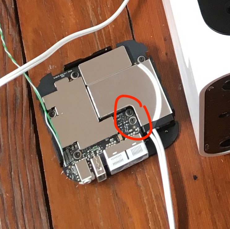

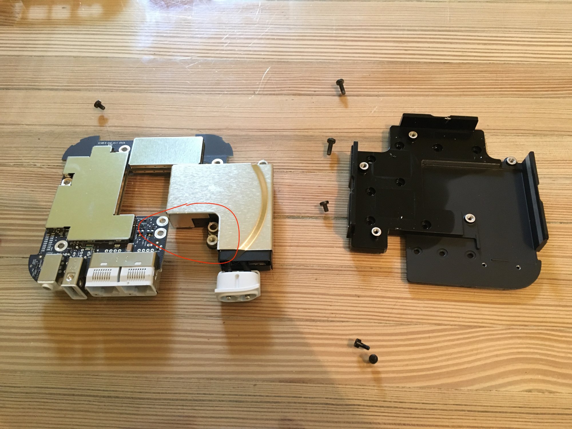

Cracking into this project but one more thing is unclear to me. The power supply: I see where you removed the housing and wired it directly but how is this connected to the io board?
It seems the metal housing from inside the plastic housing is used for this which is how the unit seems to work from factory.
Thank you in advance.
I’m not the most technical but handy enough to be dangerous.
Edit: seems the metal housing keeps it all together. Thank you!
When the logic and power supply boards are screwed into the heatsink, they connect via contacts on two of the screw holes. These pics kinda show the contact points:

Thank you for the follow up! Dig into some articles and found this information shortly after posting.
Have made 2 of these iPod HiFis already. Still need to take another pass at the reset button since it was being finicky.
Thank you for clarifying the steps on this great project.
