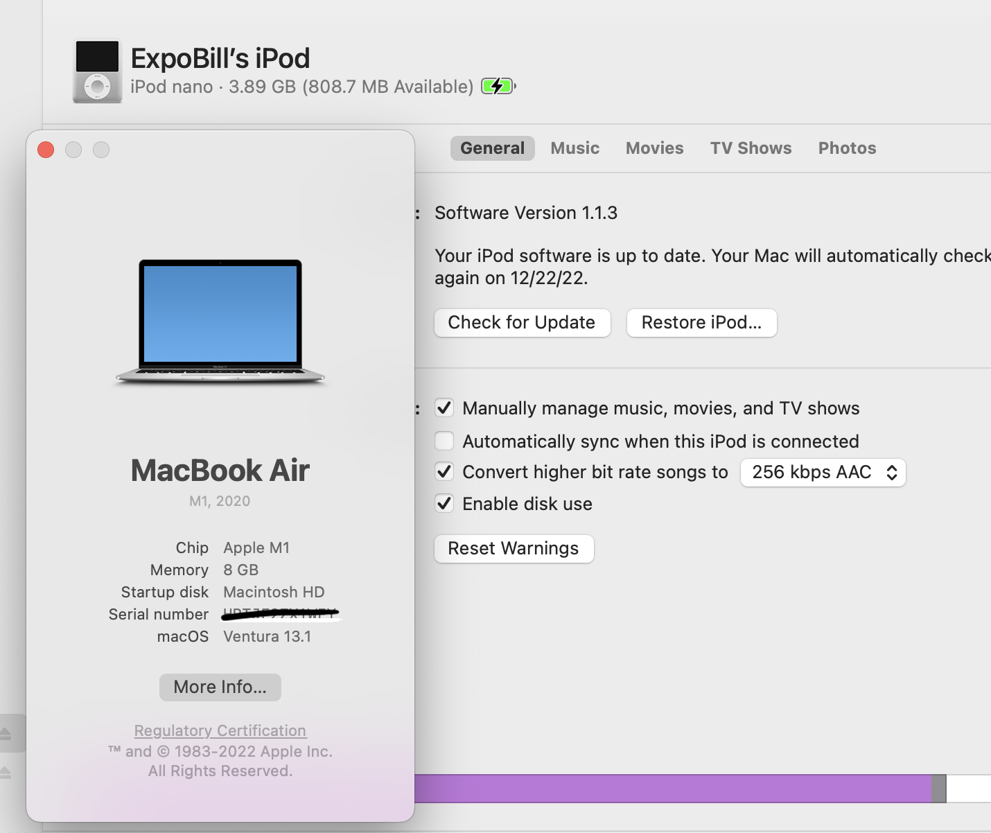

MBAir2010
macrumors 603
May 30, 2018
6,433
5,920
there
my iPod 2016 syncs with MBA_M1 well:
I can try to give any advice eon how to sync, but min just "syanc'd'
