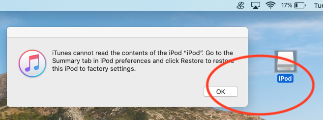

ISSUE: My 7th gen iPod Nano will NOT connect to iTunes now after I installed iTunes 12.9.5.5 on my Macbook Pro 15 (mid 2012) running Catalina 10.15.7 using Retroactive.
When I connect the iPod Nano to the MBP 15 I get this error message:
iTunes cannot read the contents of the iPod “iPod”. Go to the Summary tab in iPod preferences and click Restore to restore this iPod to factory settings.” (SEE IMAGE BELOW.)
IMPORTANT: I hesitate to "restore" the iPod Nano because it DOES CONNECT TO ITUNES and does update, etc. when I connect it to the iTunes that's on a bootable external drive running Mojave.
BOTTOM LINE: Everything works fine running iTunes on Mojave but not Catalina. The difference between iTunes on Mojave and the iTunes on Catalina is that I had to use Retroactive to install iTunes on Catalina.
I have looked all over the place trying to find a solution. Seems to be an obscure issue.
Any suggestions, please?

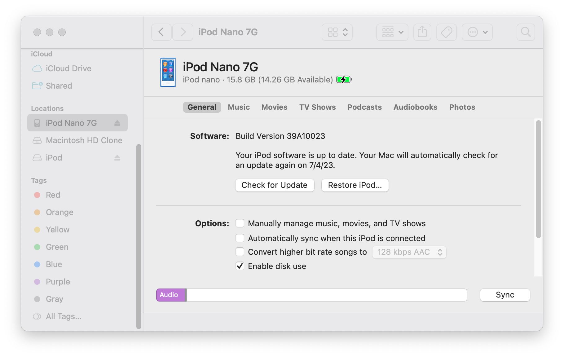

Because of the way it launches iTunes 12.9.5, the Retroactive iTunes installer invites you to give /bin/bash Full Disk Access, and if this access isn't granted then iTunes won't be able to sync your devices. Look at
System Preferences... -> Security & Privacy under the Privacy tab. Scroll down to Full Disk Access and make sure that
there is a checked entry for bash, and if there isn't then use '+' to add /bin/bash to the list.
Finder and iTunes both want to access your iPod when it's plugged in. I suggest ejecting your iPod and exiting iTunes if it's running. Then open a new Finder window and plug in your iPod. When the iPod shows up in the Finder sidebar, click on it and look at the General tab. Make sure that Automatically sync when this iPod is connected is unchecked. Then start iTunes and check to see if you can sync to it. If it doesn't work, reboot and try your iTunes sync again.
