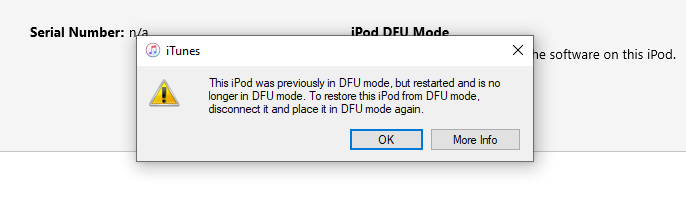

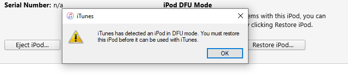

Hi,
I'm facing a weird situation, where iTunes gives the following message when I try to restore my iPod Touch 3rd gen: "The iPod was previously in DFU mode, but restarted and is no longer in DFU mode. To restore this iPod from DFU mode, disconnect it and place it in DFU mode again"
As you can see from the screenshots, the iPod was in DFU mode when I tried to restore it. I also tried directly with an ipsw file, but iTunes pops up the same massage. The strange thing is, I tried with another iPod that works fine, put it in DFU mode, and I got the same message. I changed the laptop, tried various cables, but the error persists.
Thank you for any advice!

Is iTunes up to date and does the PC/laptop have internet access?
edit: btw, which ipsw did you try? iOS 5.1.1 or 4.1? Those two are the only ones still signed by Apple.
The iTunes is up to date and yes, the internet connection is stable. I tried both but I guess won't even count, the message is displayed immediately, exactly the same with an iPod Touch 2. I know the differences between recovery and DFU mode, always put it in DFU mode (black screen). Could it be related to something else rather than the device itself? As I said, could be a coincidence but two devices, same problem...
Thanks
Just a quick update. I successfully restored my iPad Mini and iPhone, just to verify if something's wrong with my iTunes-cables-firewall-internet or something else.
Regarding the iPods, I'm facing the same problem as above, I really have no idea what could it be.
That was a good move. But it's so strange that both iPods suddenly behave this way... I honestly have no other ideas.
They are both now stuck in DFU and when trying to restore you get the warnings from post #1?
Have you tried keeping them on a charger for some time just to rule out it needs a certain battery percentage (I seem to remember to have gotten a notification that for a restore at least 40% or 60% were required).
Did you recently update your iTunes and did previously use an older version with your iPods?
If you hadn't already switched the laptop, I would have suggested to start iTunes while pressing shift to temporarily create a new library for the sake of testing.

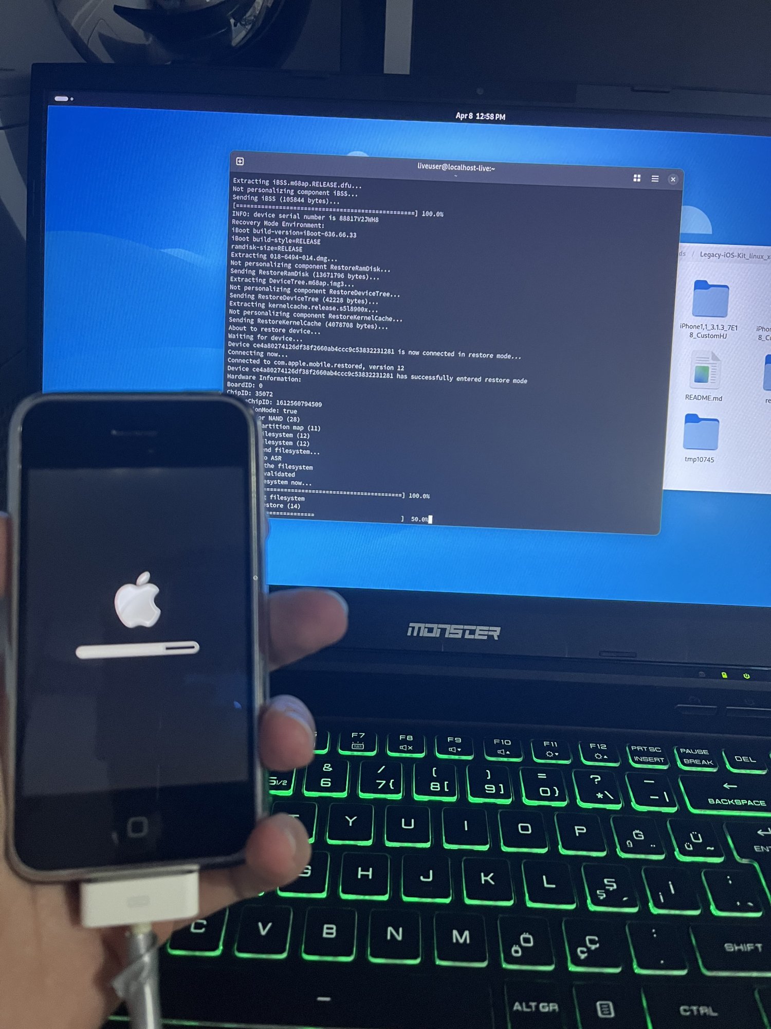

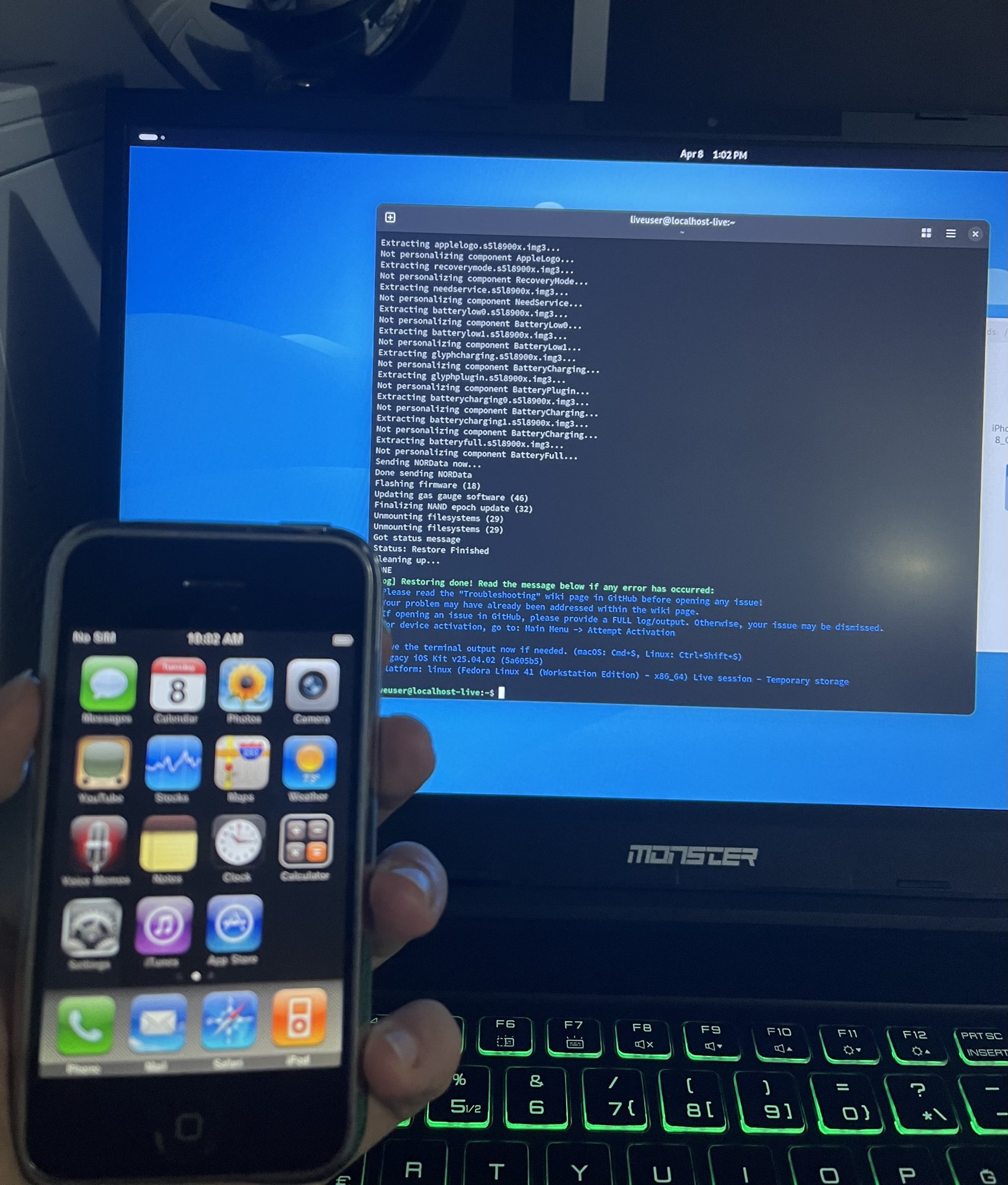

I got this error too with my iPhone 1st gen. I tried installing old versions of itunes but they are not working anymore because of server issues (windows 10). Then I installed legacy ios kit to an usb bootable linux and I successfully restored and activated my iPhone 1st gen.
