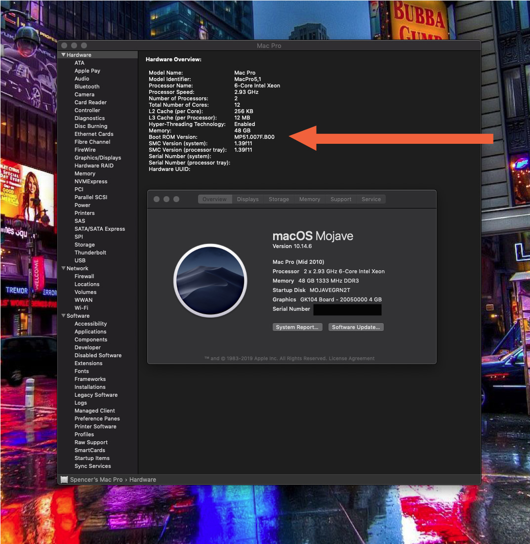

I have Mountain Lion 10.8, Mavericks 10.9 installed in my 5,1 2010 cMac Pro with the BootROM 144.0.0.0.0. They all work just fine with no beachballs or freezings. I don’t have Snow Leopard anymore and could not comment on this. When I still have my 2009 4,1 cMac Pro, my Snow Leopard DVD installer, 10.6.0 will install and work in a 2009 cMac Pro. But this 10.6.0 installer does not work in a genuine 5.1 cMac Pro. I already tried that and does not boot completely. As tsialex mentioned, the Snow Leopard needs to be 10.6.4
I also used to have Yosemite 10.10 and this OS also worked fine with the BootROM 144.0.0.0.0
On another note, I transferred my High Sierra SSD HFS+ to my second 2010 cMac Pro with an old BootRom of MP51.007F.B00 and High Sierra works fine with no problem. Also transferred a HFS+ HD with Mojave 10.14.6 installed to my second cMac Pro with an old BootROM MP51.007F.B00 and also works fine. No beach balls or freezing. All softwares are working Okay on my end. To be clear, if you intend to install High Sierra on a genuine 2010 cMac Pro, you need to update the BootROM meant for High Sierra.
High Sierra running on BootROM MP51.007F.B00
MOJAVE in Old BootROM
Thanks

It seems you are using High Sierra and Mojave with an old EFI BootRom MP51.007F.B00 that seems to be slightly older than mine ( MP51.007F.B03 ) , how is it possible ?
If i understood correctly , maybe you had those OSX installed on a Mac pro with some more recent EFI BootRom but you have transfered the Hard Disks with those two OSX , on an older Mac Pro 5,1 which still has that older MP51.007F.B00 EFI BootRom and it works as you don't use APFS format Hard disks ?
tsialex wrote : "High Sierra and Mojave won’t work with older BootROMs unless you selected HFS+ install with High Sierra and hacked Mojave to work with HFS+."
I understand it might be possible to install High Sierra selecting HFS+ install ( although when i try to install it , it doesn't ask me if i want HFS+ or APFS install and only asks me to update the firmware ! ) or transfer a HD with High Sierra already installed on it from one Mac pro which lets you install it , to boot another Mac pro which has an older EFI BootRom but from what Tsialex says, Mojave needs to be hacked to work with HFS+, is it what you did ?

To simplify, you can perform the BootROM update. Just follow tsialex’s excellent guide below.
On your 2009 4,1. cMac Pro, you can update the firmware from 4,1 to 5,1 Under 5,1 firmware, your 2009 cMac Pro will still function and “behave” the same way before the firmware update .
For Logic Pro X, the Apple support page below confirms Logic Pro X 10.3.1 or later works in High Sierra. Thanks

EDIT: When you plan to do a firmware update ,read the chapter about firmware updates in the technician guide , together with all the information by tsialex, it will guide you smoothly through the firmware updates.
Officially Mojave is the latest OS supported for these machines, so install Catalina might be a bit complicated (and maybe not even necessary for your purposes).
About the Metal graphics card , you will need for Mojave: there are so many that will work, but purely for audio, i think its really not necessary to invest lots of money in it.(see thread about GPU for Mojave).
