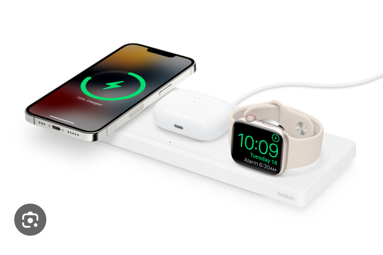

I always leave my devices charging overnight and never had an issue. I use a Belkin 3 in 1 Wireless Charging Pad. My iPhone 15 PM and Watch Ultra are charged every single night.
Do you have the flat pad, or the coat hanger style?
