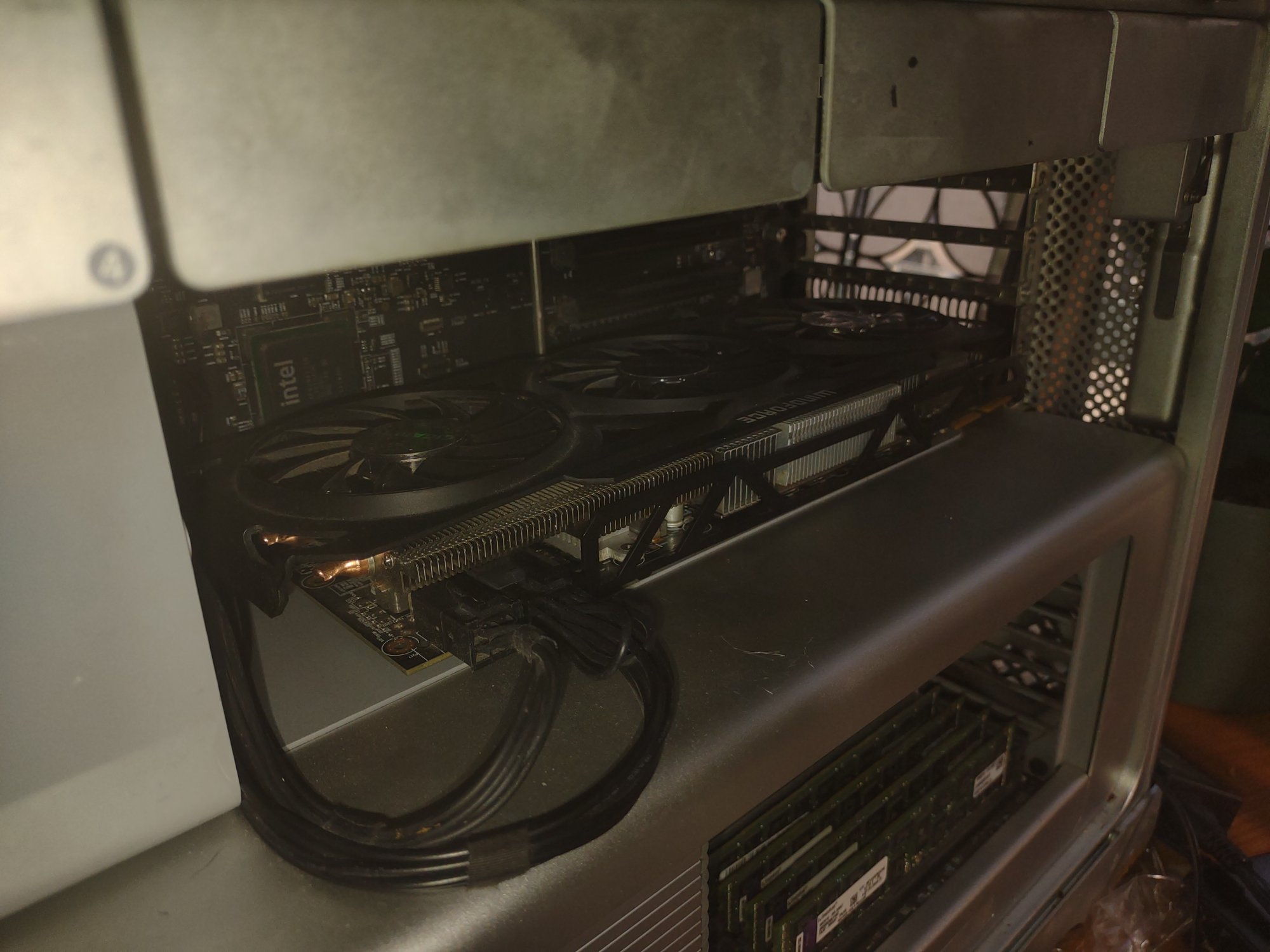

Well, the fan blades turn if I push them with my finger Other than that, they move about as much as my father. He has been in a box underground since 1991.
Is there a way to reactivate the fans.
Background info: This gpu has been resurrected twice with 9 minute oven baking at 390 degrees. Most recent oven treatment was a year or two ago

What is the temperature of the GPU and what are you doing with it? Seems like a very open cooler design and maybe the card has a fan stop feature until it reaches a specific temperature. The Mac Pro has the PCIE fan so it get's some air.
Try to push the card using Unigine Heaven Benchmark and report back if the fans start spinning. :)

The fans should be always on when the mp is running.
Do you have proper power cables going to the mobo?
all the apple cards, pc flashed cards and even non flashed cards like radeon 570/580 should always have spinnig fans on gfx.

I have just remembered something. I had a problem with the adapter 2x 6pin to 8 pin pcie power going to my rx580. I thought the card died because it seemed to be dead. Turned it was the power adapter. I have original 2x 6pin cables and then 8 pin adapter. So replace the power cables first. Some pc shop tested my rx580 in a pc so the card was fine.

I'm not sure if I'm being helpful or not, but please accept my thinking below, possibly leading to some help.

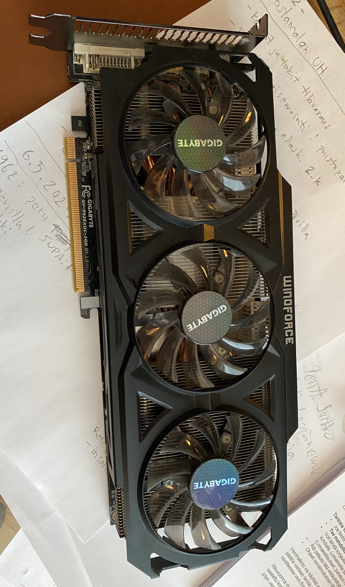

I happen to have this same card, a least I think I do. It's a Gigabyte Radeon R9 280X, either rev2 or rev3, I can't tell it only from the picture attached. I've got a rev 2. It's printed on the PCIe connector plate on the card.
It's a 250W TDP card, and in ypur config it seems to be powered only by 2x mini 6-pin connectors from the cMP motherboard according to attached picture. That would not be enough to operate the card at some high performance and power demanding situations. cMP mini 6-pin can give 100-110 without shutdown I have read. 2x is 200W-220W before cMP self-shutdown, plus the approx 30W from the PCIe slot. We are in the ballparks of a cMP self-shutdown already.
I really don't know if that too low of a power feed to the card would have caused this mentioned and unexpected behavior of the fans not operating normally or not, but it might have.
GPU card TDP is 250W and the card is measured to consume a lot more than that in some tests, so it would need to be fed with more power than just 2x mini 6-pins from the backplane.
My card seems like yours, doesn't it?

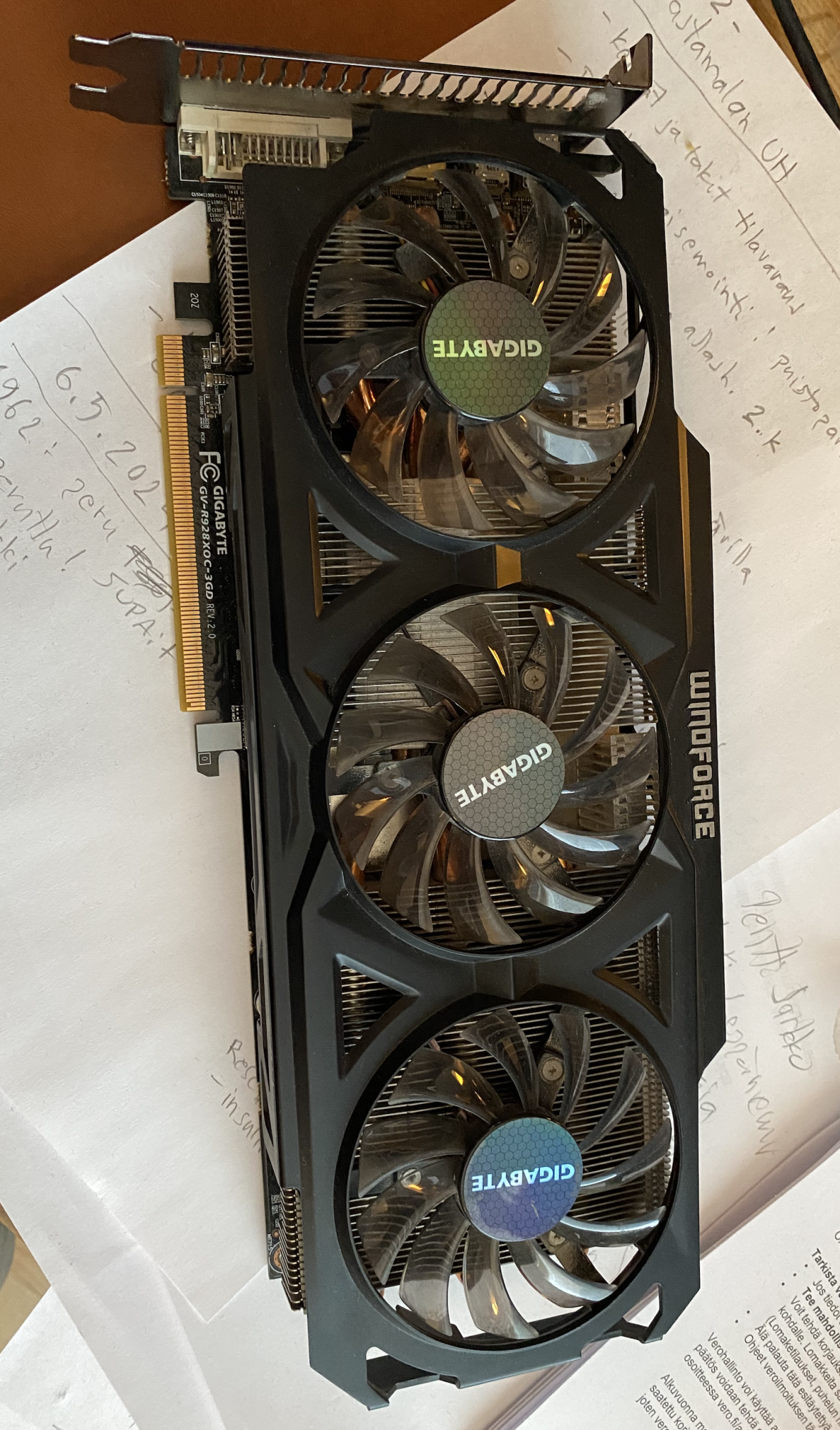

each mini 6-pin can deliver 75w max
