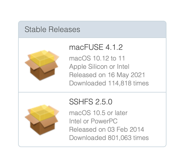

On the topic of MacFUSE, I find it strange that the current release of its useful companion SSHFS is over 7 years old.
That and the news stories a couple of years ago about MacFUSE oscillating between open- and closed- source kinda put me off this stuff in general (though I don't remember actually having any substantive complaints about the software).
For the benefit of those in the future getting redirected here by Google (or Bing... which actually was my case), macFUSE is a 'strange beast' for a simple reason: it is 'as open-source as Apple allows it', that is, there is a point where the core of the kernel extension that macFUSE has to install requires a valid signature and a notarisation by Apple — or else, you get all those suspicious warnings popping up all over the place, scaring users off (and — since it's a kernel extension — there might be certain configurations where macOS won't even install an unsigned/unnotarized kext anyway). Benjamin Fleischer, the original developer, had a tough choice to make. Obviously he wasn't going to keep his Apple developer digital signature around to be used by anyone — which would get blocked by Apple in no time anyway (and not even entitle him to a refund). The first alternative to that (and I believe that was what he did in the past releases) would be to do both: release the open-source code of the kext (you can still grab it) but also bundle a signed/notarised binary version for those who trust him, to avoid macOS to trigger DEFCON 5.
For some reason, this became impractical in the current release cycle. There exist a gazillion reasons for that. Maybe Apple frowned upon a 'parallel' release of open-source code and a code-signed/notarised kext that allegedly was compiled from that source code — but the truth is that nobody can know that (possibly not even Apple, if they wished to check on their own). At the end of the day, if you used Fleischer's compiled/signed/notarised binary, you'd have to trust him that he had, in fact, compiled it from the open source code he also provided; you couldn't know for sure. You could check that the kext was signed by him and notarised by Apple, and that nobody tampered with the code, but... what code? You cannot possibly know.
It is also possible that Apple didn't limit themselves to frowning. They might have alerted Fleischer and told him that his distribution model of a kernel extension — signed and notarised by Apple — was 'not acceptable', and either he changed his approach, or Apple would revoke his current developer license and signature. Again, I'm only speculating what Apple might told Fleischer or not, but I can imagine such a scenario to be plausible, if not possible.
Thus, from the current version onwards, Fleischer simply distributed the kext without the source code. If it's a question of trust anyway, just distributing the kext in binary format as freeware is perfectly legitimate — freeware is still popular without open-source code, after all; one thing does not necessarily imply the other, and there is lots of perfectly safe freeware around :)
But of course there is nobody (except perhaps Apple) that can demand that you trust person X or Y, 'just because everybody else does'. Fleischer has a good reputation — after all, he's still behind the codebase — and macFUSE is still being maintained (while SSHFS probably doesn't really need an update — which it hadn't have since 2014! — simply because, well, the SSH protocol hasn't really changed since then... and it might only change in a decade or two, when it will need to deal with post-quantum encryption or whatever we'll get in 2040 :p ). It is trusted by very-security-conscious companies such as Keybase — who also bases their code on macFUSE (albeit on an older version, forked by them, exactly because of the issue of signing & notarising bundled software in the same installer).
