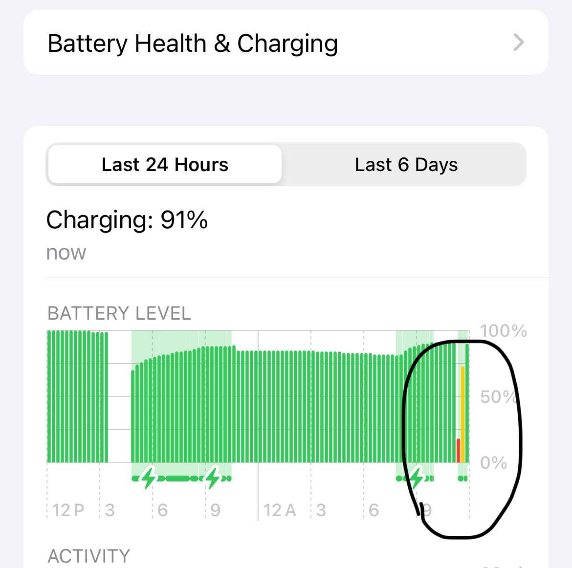

982
iPhone was constantly restarting for some reason for few hours.
Then it stabilized. There is no panic logs on diagnostic.
Then it seems that charging takes very long time as you can see, from 6:00PM-9:00PM, the phone was on charger, but only charging from 60%-88%.
Then in the morning, it took 3 hours only charging from 83%-91%.
Off the charger for few minutes, then as soon as open Camera app, the phone will restart, battery goes down to 10%. Restart again, back to 90%. However, when iPhone shows 90%, phone will restart as soon as Camera app launches.
Finally, put phone back to charger, now charging normally.

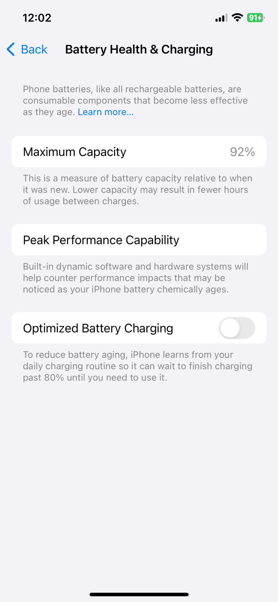

The battery health shows as 92%. Apple won’t replace battery health is above 80%. So if the battery is the issue, then what should I do?

If it’s now working normally, just a software glitch. I’d ignore it.
I don’t know. Not it stuck at 95% for like 20 minutes and won’t go up.
I might have to reset iPhone and see if it is software glitch.

Try another charger. If a charger is only putting out a couple mA, it will register as charging but take forever to do it.
If that doesn’t help — reset the phone as new

Definitely try charging with a cable and see if the problem persists - that will tell you if it's specific to wireless charging/charger or the battery generally
You can pay to have it replaced. You just can’t use AC+ coverage.

Good suggestions thus far. In addition to trying a different charger, preferably use Apple genuine cable and ‘brick’.
Beyond the already made suggestions, I recommend doing a calibration:
  1. Charge to 100%, and keep charging it for at least two more hours — or however high it will charge.
  2. Unplug your iPhone and use it until it automatically turns off due to low battery.
  3. Again, charge your iPhone uninterrupted (i.e., don’t disconnect from charger at any point) until 100%.
If necessary, you can repeat this process back-to-back.
Highly likely battery is defective.
High drain app like Camera will reveal defective cells with high internal resistance.

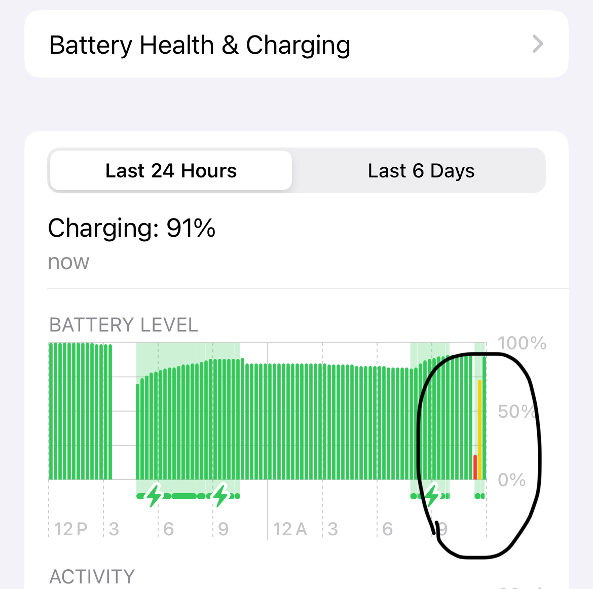

View attachment 2366436 View attachment 2366435
Take It to Apple or call for a diagnostic, and that way there’s a repair log of the issue occurring if they don’t see any failing tests.
It could be a failing battery; sometimes batteries that are swelling behave this way, despite reporting normal charge health. Apple diagnostics may report a different failure if that’s the case (if the issue is bad enough or persistent enough) —
likewise you can inspect the enclosure for signs the case is being pushed apart. Apple Store techs can also do that; these days swollen batteries are harder to see until quite swollen thanks to stronger adhesive / oled doesn’t show a color distortion like LCD when pressure is applied from behind.

Did you use any cheap or unknown quality chargers? Those can cause damage to PMIC.
I tried:
1. Old iPad 10W charger with USB lighting cable
2. Google Pixel USB-C charger with USBC-Lightning
3. An battery bank.
Currently, it seems the phone will charge, but once it hits 90% above, charging gets stuck. It will stay on for very very long time and not going to 100%.
For example: it will charge to 95% and stuck at 95%. Then reboot , it drops to 93%… the stuck at 93%. Once it drops below 90%, it will charge back to whatever it wishes (above 90%) and stay at same percentage.
I think it maybe the battery being old and start showing. I need to wipe iPhone clean, to rule out software problems.

Mine reached 92% about 2 years ago and showed all kinds of crazy ups & downs, and said it was time to service & all that. It's at 86% now, still lasts all day, and I couldn't care less. I'll replace that battery when it starts on fire.

If you have a Mac with the application “CoconutBattery,” you can connect your phone to your Mac, open the iOS Device tab in CoconutBattery, and it will tell you some stats on your phone’s battery health.
The built-in battery health indicator in the iOS settings is garbage, so I would not rely on it. Also, with multiple 3rd-party repairs, I doubt Apple will repair the phone, but you could have another 3rd-party shop do the battery replacement.
