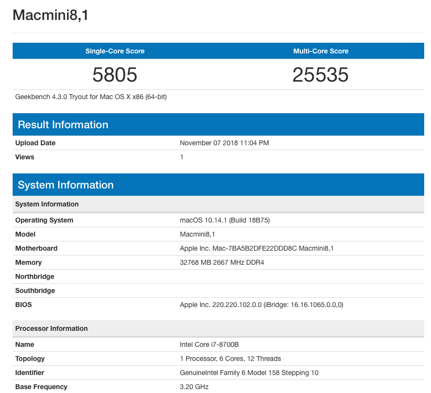

I just upgraded the RAM to 32GB by looking at Dr. Stealth's photos in #461 and referencing the iFixIt guide for the 2014 Mac mini. I didn't realize I had to unplug the PSU and one other cable before pulling the logic board out... but thank goodness the cables disconnected without breaking anything. Other than that it wasn't too difficult. I haven't encountered RAM slots with the rubber around them, and inserting the RAM was a little finicky. But if you've installed RAM before you can tell when it's clicked into place correctly.
I used this RAM: https://www.amazon.com/gp/product/B071KP8CGJ/ref=od_aui_detailpages00?ie=UTF8&psc=1
Ran Geekbench, everything looks good and feels fast. Very excited to sell my Hackintosh.

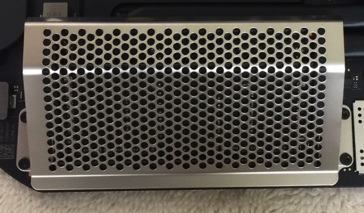

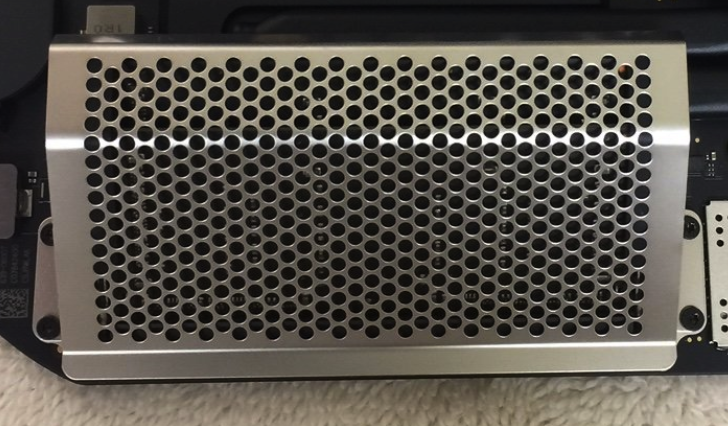

The fan may just screw out and lift up. Screen is probably for grounding or an added dust filter? Just guessing. Biggest question is what holds that cage in place.

Heat dissipation and general protection.... Like This.
I am sorry but what are they protecting against in an essentially sealed machine? And it serves little if no purpose for heat dissipation. The reason you have exhaust shields like that are to protect your legs from touching the hot exhaust pipe, not to dissipate heat. That cage serves no purpose in the Mac Mini but to make it more difficult to upgrade it just like the tamper proof screws.
