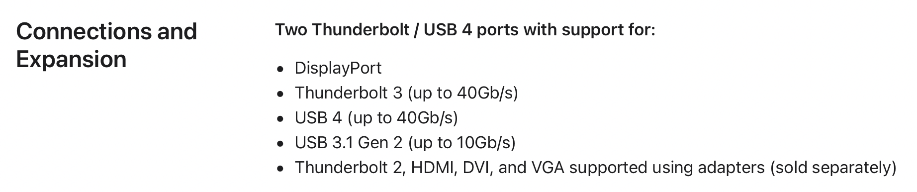

So is this a firmware issue or hardware limitation of the M1? All their website information still advertises 10Gb/s specifically.
10 Gbps is the signal speed. The data speed (after PCIe and USB protocol overhead) is between 5Gbps and 8.5 Gbps.
My Intel Mac mini 2018 can do 8.5 Gbps of data (1060 MB/s) with AmorphousDiskMark.app. M-series Macs are less than that.
