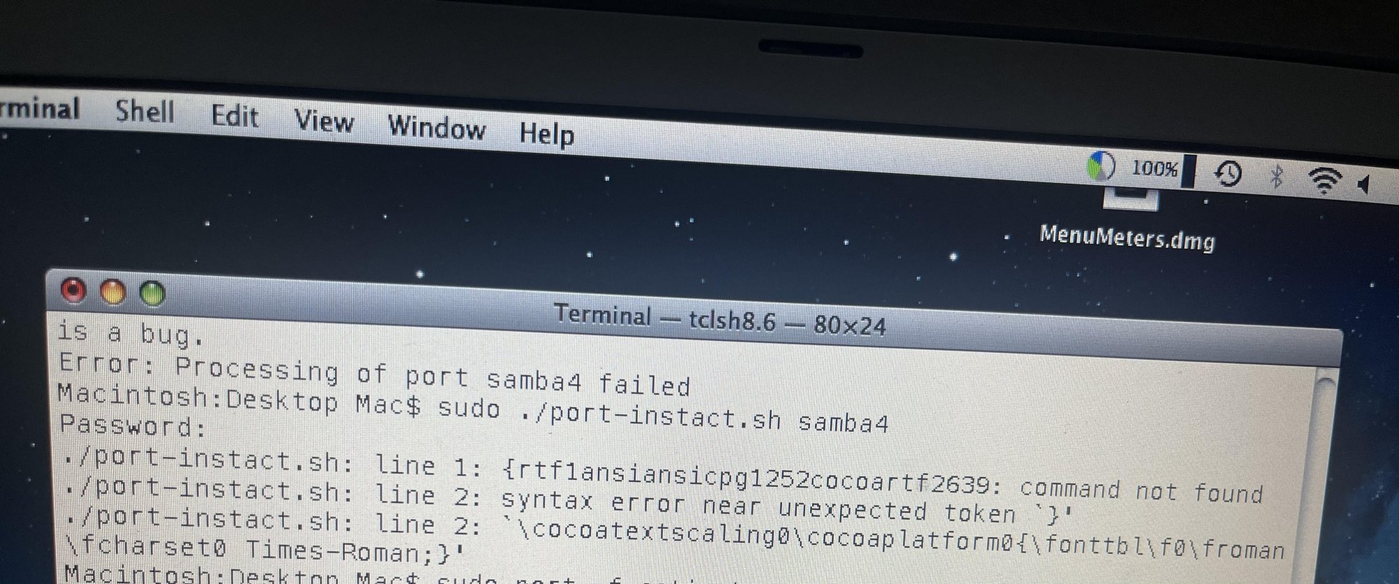

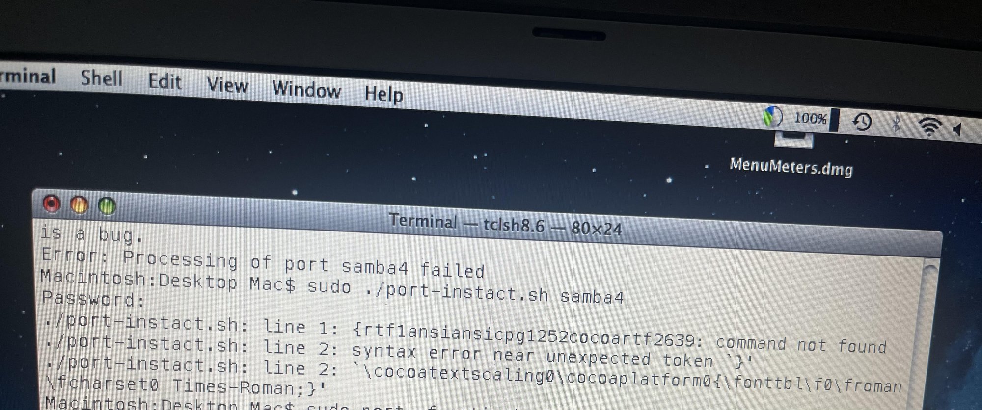

I am trying to install samba4. First time with macports.
And I am constantly having to need to manualy activate some dependencies and restra(like explained here).
Any way to automate this? I tried that script but I get some errors (picture in annex).
Sorry but I am really n00b on this
You should not need and should not really use any unknown scripts to “fix” MacPorts installation. (At least as long as you do not know what exactly that is doing.)
It is hard to say what exactly fails, unless you attach the log. (Not for the script you referred, but for what you do with MacPorts in this case.) But it could be a conflict between samba4 and samba3 or some other related port. Such conflicts happen because different ports install identically-named files into identical locations. This is not a MacPorts error normally, it is a consequence of how those ports are designed by their developers. However, it can be fixed from MacPorts side, and that can be requested via MacPorts Trac.
With samba case it can be annoying, since ffmpeg has a variant for samba, which uses samba3, so if one wants to have samba4, it will require to deactivate ffmpeg, if the latter is installed as +samba. Solution could be either to install samba3 and samba4 in dedicated subprefices (which will allow both to co-exist) or allow ffmpeg (and whatever else may use samba) to choose between samba3 and samba4. Port maintainer, hopefully, can sort that out in a better way.
