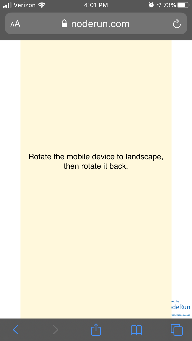

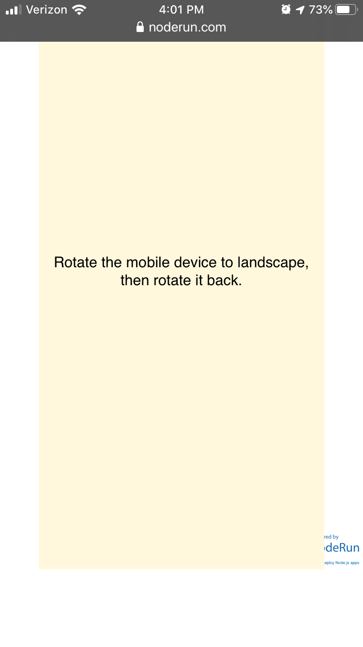

Here's the page before and after rotating:

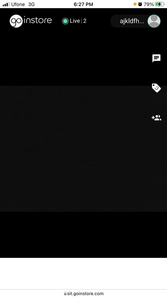

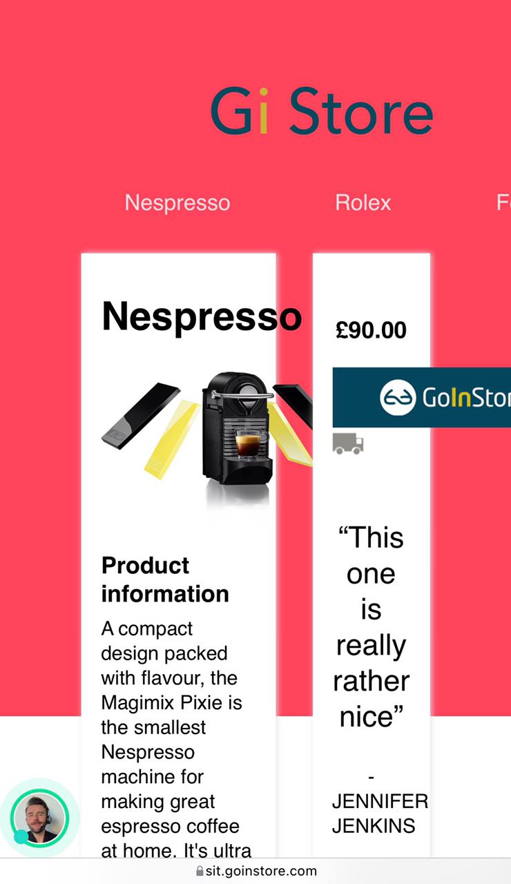

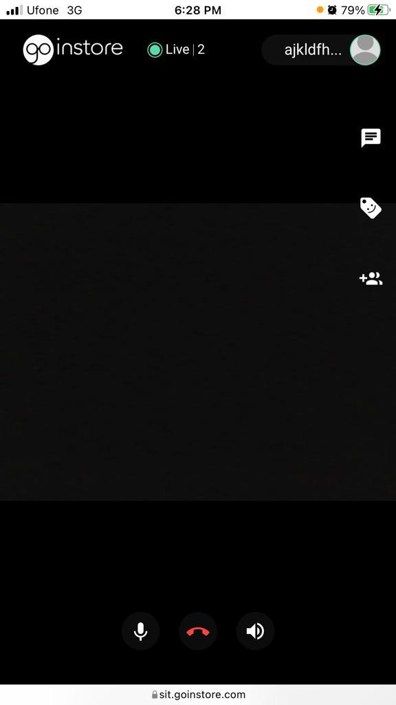

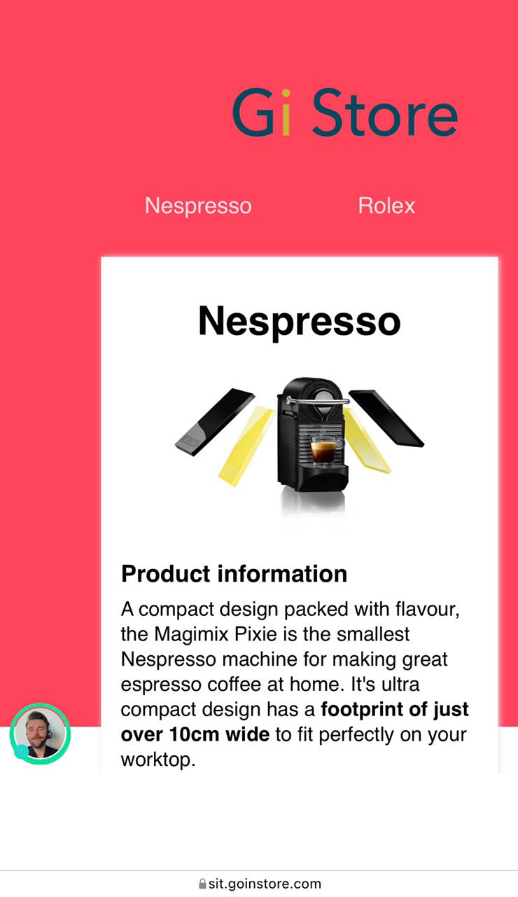

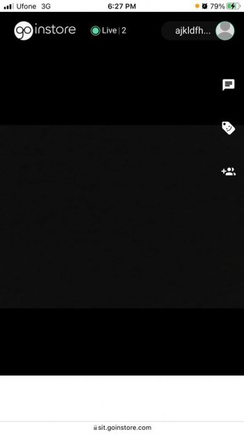

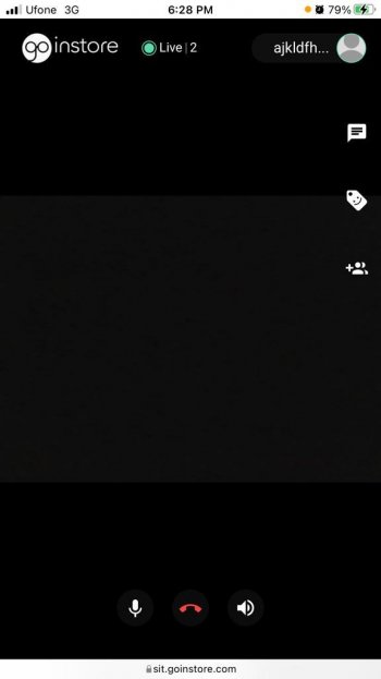

Hi everyone, I am having the same issue when I apply the css property "position fixed" on body after hiding the address bar by scrolling the page. I tried all the solutions mentioned above but none of them are working for me. If you guys found the solution please share it here.
Thanks
