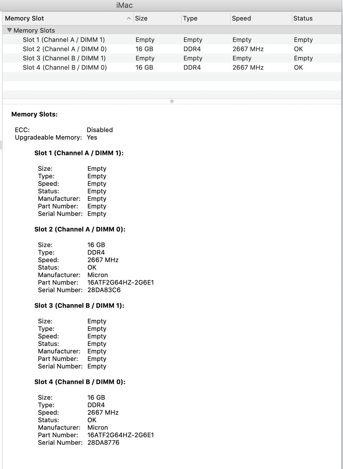

Totally confused!
I removed both OEM sticks and replaced with 2x 16GB from Crucial.....
Am I in Dual Channel Mode????
Any replies would be appreciated!
EDITED to add - 2020 iMac - i7, 5700XT, 1TB
Reactions: Talvigi
Yeah that'd be dual-channel 2667Mhz - If you ever want to go to 64GB I recommend getting as identical sticks as you can for the two remaining slots :)

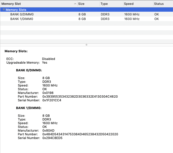

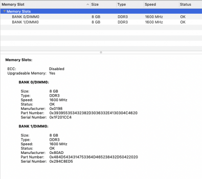

I still don't understand how to confirm if it runs in dual channel mode, can someone explain plainly, what indicators to look for exactly?
There is no indicator that will tell you "you are running in dual channel mode." (at least not easily on a Mac).
There are two separate things of relevance: dual channel, and transfer speed (MHz).
Dual channel:
Dual channel means that the memory controller can simultaneously access memory in Channel A (aka Bank 0) and in Channel B (aka Bank 1) in parallel, thus effectively doubling the memory transfer speed. For this to happen, the size of sticks in Channel A should be the same as the size of sticks in Channel B. The requirement for full dual channel is Channel A GBs matches Channel B GBs. "Channel" is also known as "Bank." You can see from your screen shot that Bank 0 (i.e., Channel A) has 8GB, and Bank 1 (i.e., Channel B) has 8GB. Therefore, by deduction, you are running in dual channel.
The other relevant information is that each memory stick is running at full speed (in your case, 1600 MHz). This is separate from dual channel.
Hope this helps
