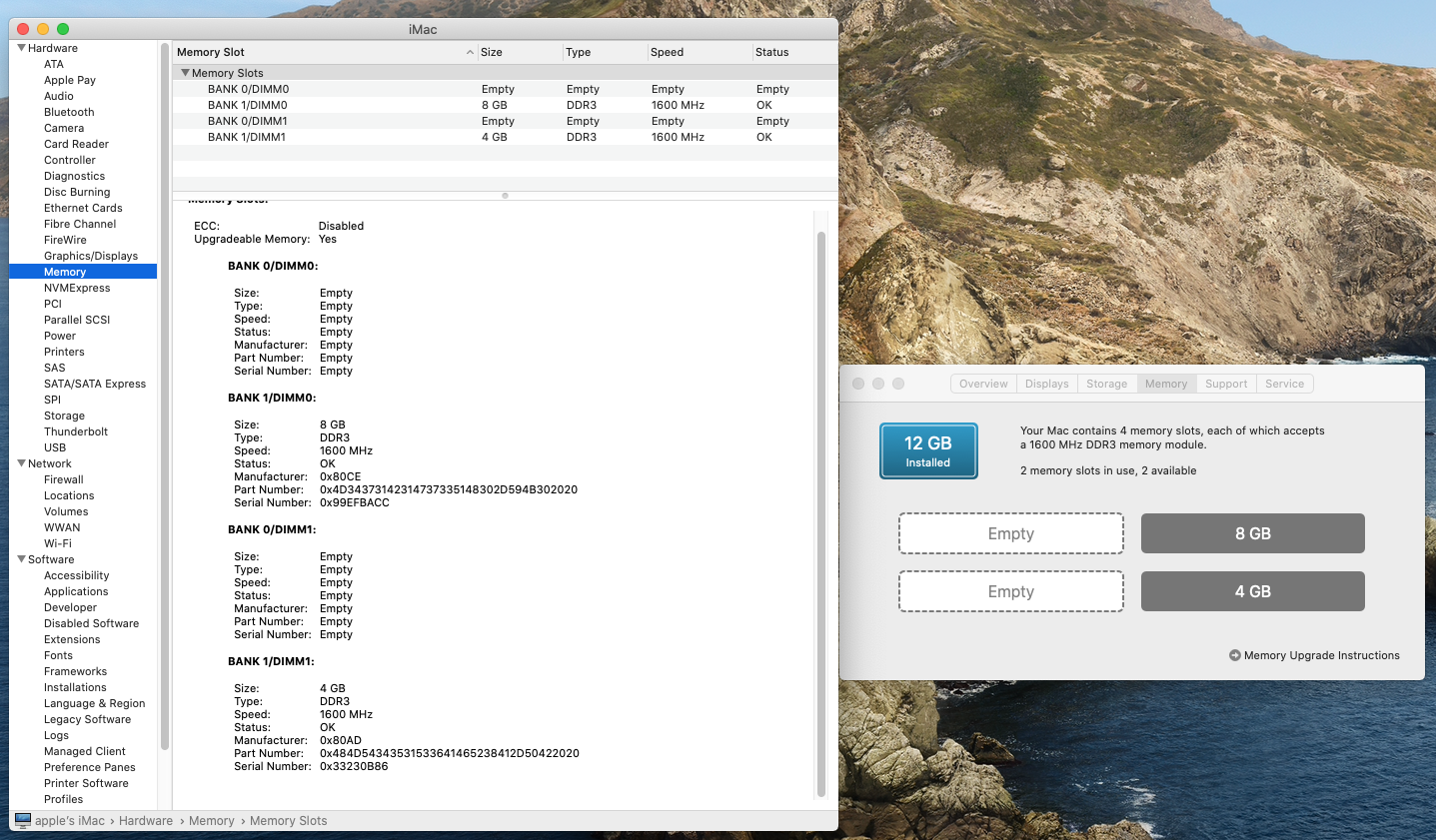

Hi guys, so all this is very confusing to me, I have an iMac 14,2 27inch (late 2013) core i5. I bought it used with two memory sticks of 4GB (4GBx4GB=8GB), but to my surprise within the same day it burned out a memory stick and turned off. I was shocked when it went off, but when i opened the RAM door and took out both ram slots; put one and checked if works? it worked. The other didn't work, so i realized it was the RAM which burned out.
Now when i looked closely, i found that one of them (the damaged one) was PC3 12800S 2Rx8, while the other (remaining one) was a PC3L 12800S 1Rx8. My surprise is that if my iMac does support PC3 than why it burned the RAM? While PC3L is alive.
And now i have two memory sticks, a 4gb PC3L 12800S 1Rx8 11-12-B4 SK-Hynix and an 8gb PC3L 12800S 2Rx8 11-13-F3 Samsung.
They are in the following DIMM SLOTS and are working fine since this morning without shutting down the system.
8GB Bank1/DIMM0 (Both RAMs are PC3L 12800S)
4GB Bank1/DIMM1
4GB Bank1/DIMM1
This "works" (obviously), but by having all your RAM in Bank 1, the memory is operating in single channel mode, effectively halving the memory transfer speed.
To get full dual channel mode you need to have an equal amount of RAM installed in Bank 0 as in Bank 1.
Thanks for the wonderful words, I really didn't expect this much fast answer. So now, please let me know what should I do? Like it's for sure that I have ordered two more 4GB Ram sticks (PC3 12800). Now I will have an 8GB PC3L and two 4GB PC3. What should be their best location? I don't know the dual channel things, I only want a snappy Mac which works fine on most of it's tasks. Thanks a lot and God Bless You.
The objective is to equalize the total GB in each Bank, as close as possible (Bank is another name for Channel.) For example:
8GB Bank1/DIMM0
4GB Bank0/DIMM0
4GB Bank0/DIMM1
If the GB is not equal in each Bank it is not ideal, but in reality it doesn't make that much difference to overall computer speed, as RAM transfer speed is only one of many factors that contribute to overall performance. Amount of RAM is generally more important than speed of RAM.
However you have a mixture of PC3 (1.50V) and PC3L (1.35V), so I am not sure how this will work. 2013 iMac is supposed to use PC3 sticks, but it is likely that most PC3L sticks will work also. I don't know if mixing them will work. Best would be to get all sticks the same size and type, but I suppose you can try.
