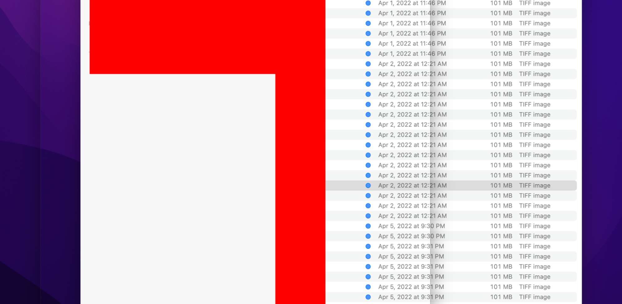

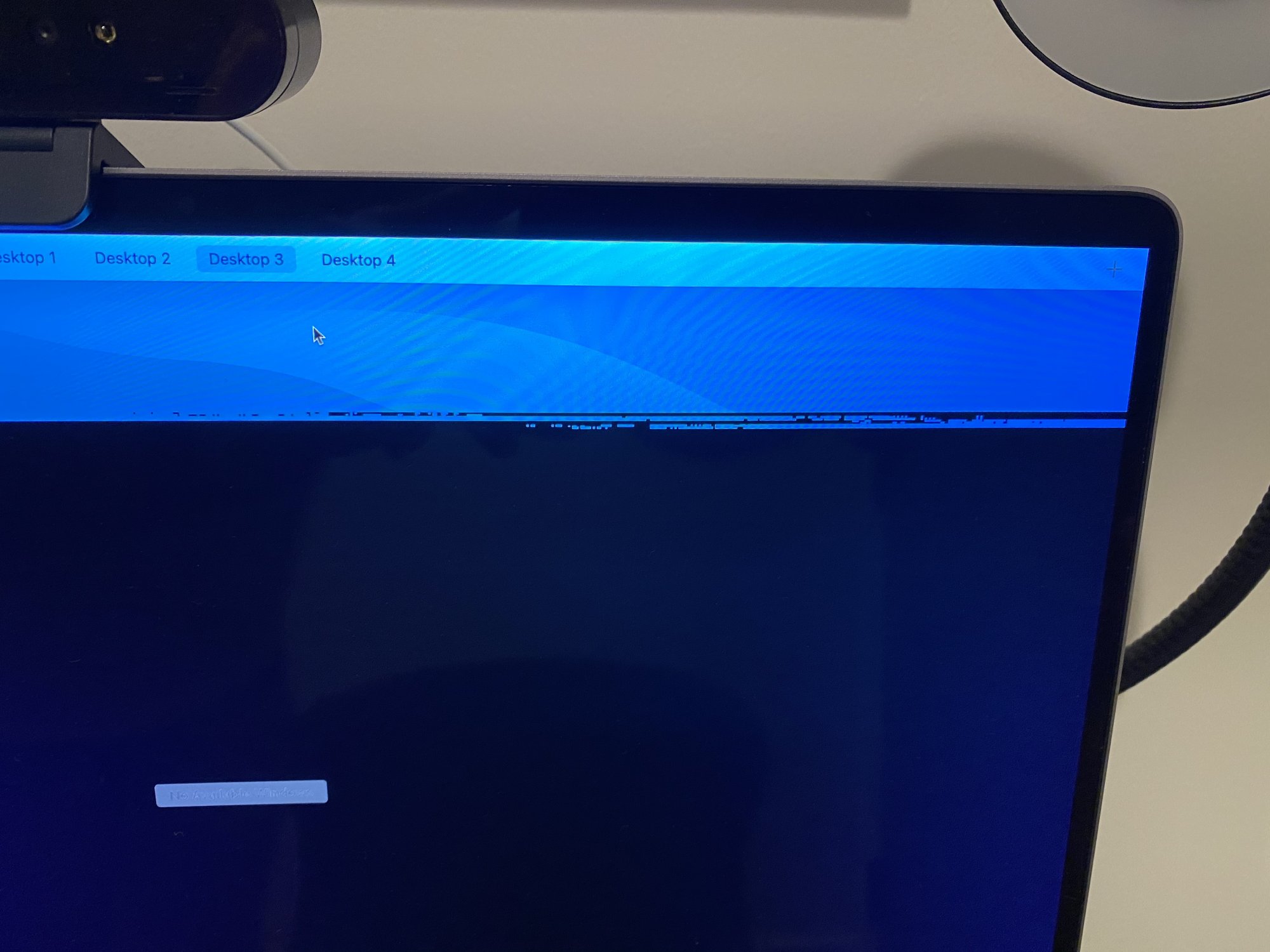

Hi,

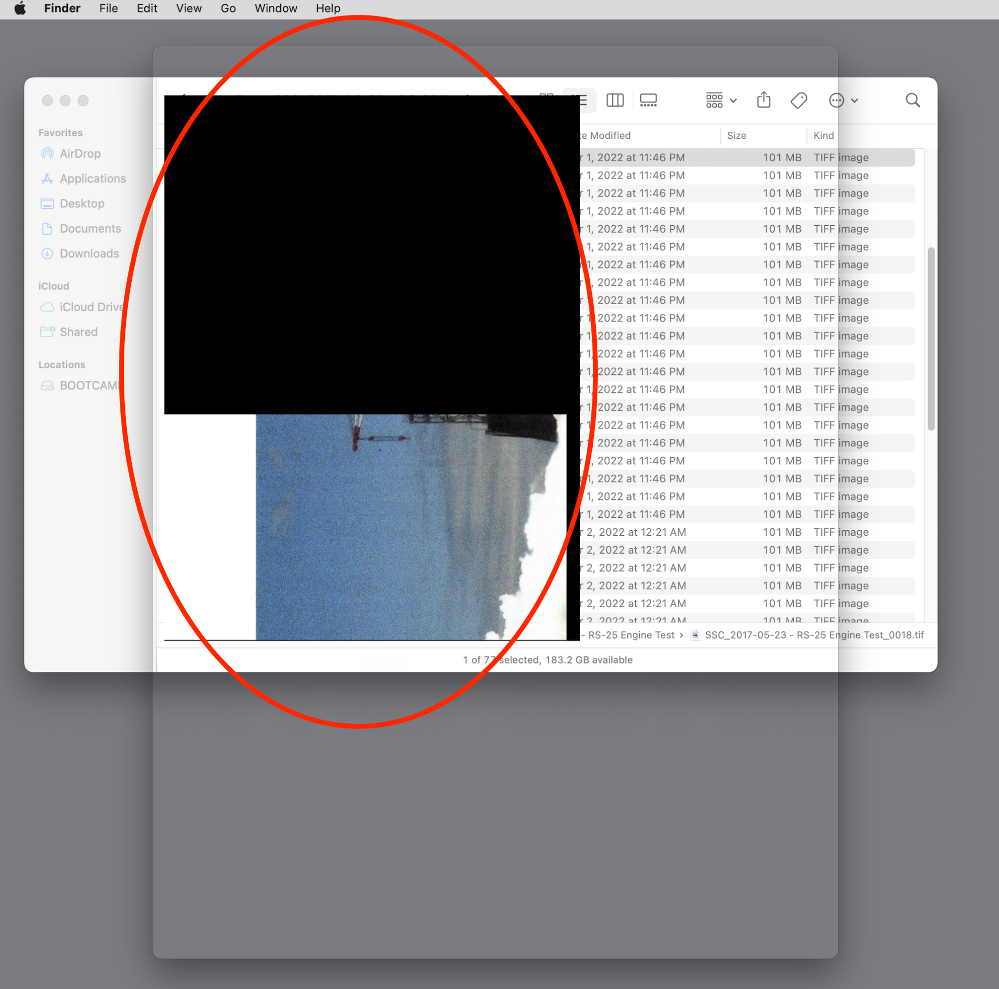

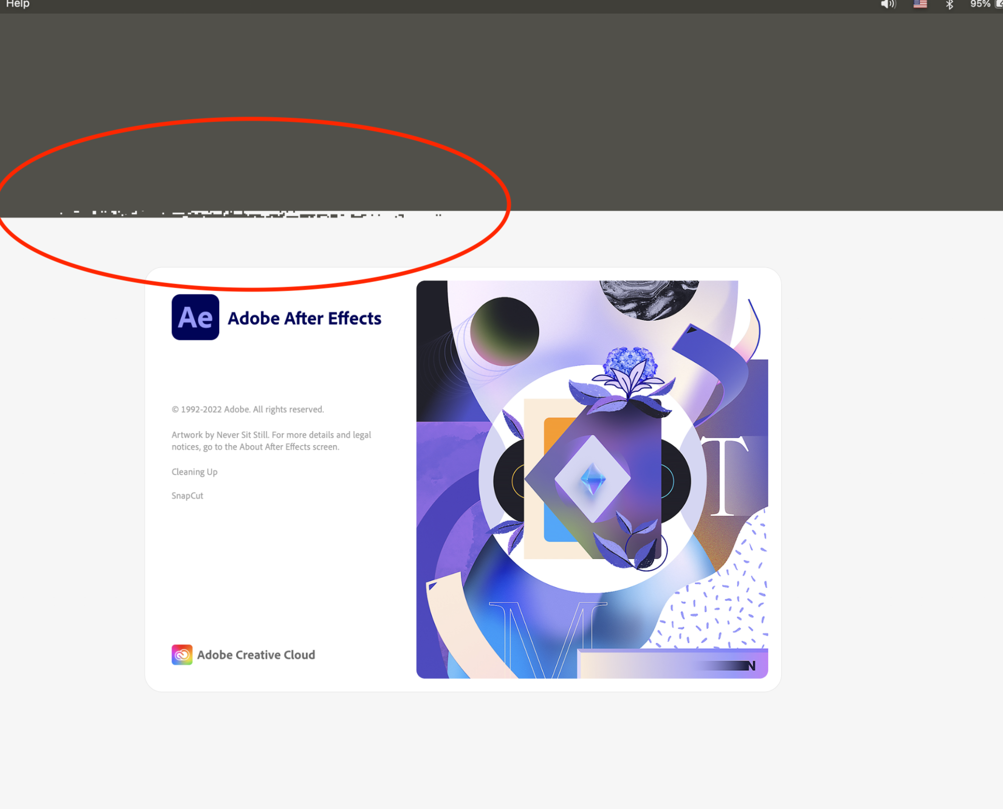

I sometimes saw this kind of crashed images or desktop background(?) when I open some apps or preview (seeing images by pressing space bar).
is this kind a gpu problem?
macOS Monterey 12.4
My MBP is basic 16" 2019 model.
thanks!

updates...
For the glitch (Red box & Black box) of quick look / preview, I figured out and I am not sure why it works...
I set some 'system preferences' same as who has no issues with it.
in Accessibility / Display setting.
- uncheck all
in Trackpad setting
- uncheck 'Look up & Data detector' (point&click)
- uncheck 'smart zoom' and 'Rotate' (Scroll&Zoom)
- uncheck 'Notification Center' and 'App Expose' (More)
yes. Format and reinstall. GPU drivers are not properly detected. Might be also a sign of hardware failure, but lets hope that not.

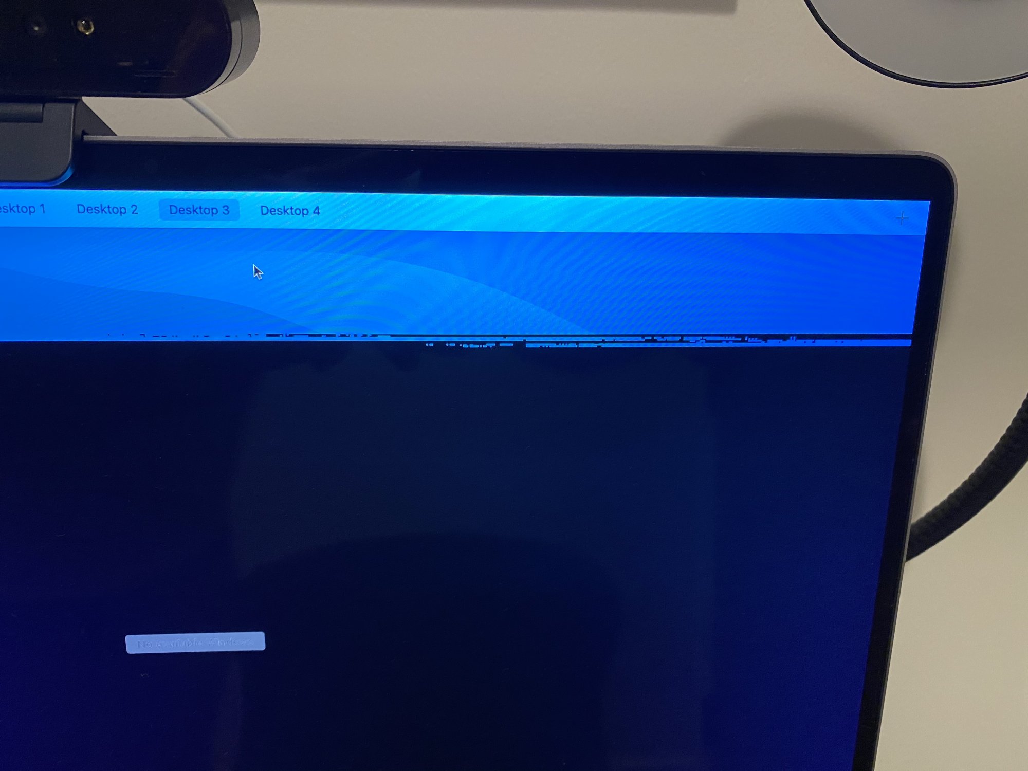

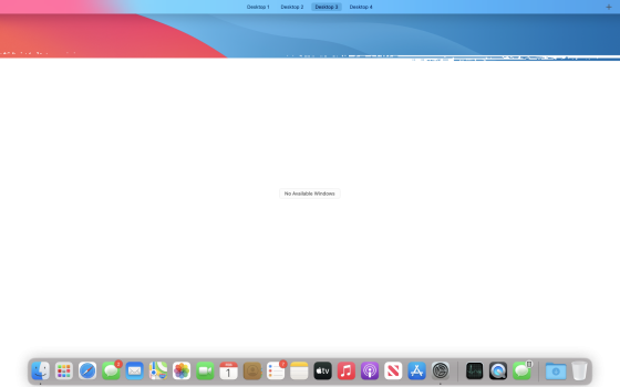

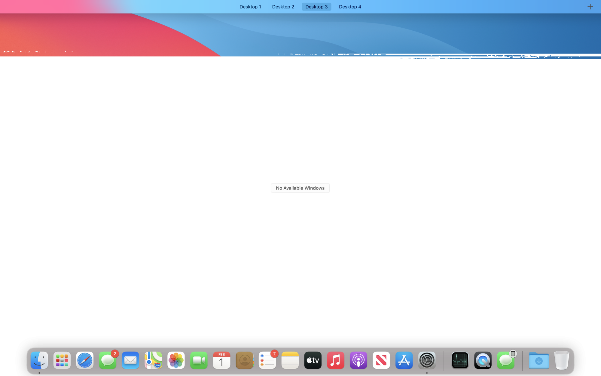

Oh wow, I had this exact problem with the 16" MBP - I had the higher spec'ed 2.4GHz i9 with 32GB RAM and the 8GB 5500. Multiple reformats and reinstalls, and the problem continued to recur. Eventually, Apple took the MBP in for a week to conduct testing, they returned it back reporting everything seemed fine. Of course, the issue recurred as soon as I got the thing home. Fast forward some, and Apple eventually decided to replace the laptop. The replacement demonstrated the SAME ISSUE, albeit less often and less severe. In the end, I decided to trade it in for an M1 Max. (As an aside the first M1 Max died after a month of use 😀 you can't make this stuff up...) Good luck, and I hope you get it sorted out.

Does this happen when you move the window, or does it happen when the window opens? If you see this on the desktop, I would suspect GPU memory overheating. If it only happens in certain apps, and particularly only when you move the windows around, it could be a driver issue. Have you noticed if it only happens on the Intel GPU or the AMD GPU, does it happen on both?

The first picture I attached, the glitch happen when the window opens and I see that on that desktop.
I tested 'preview' thing with different gpu.

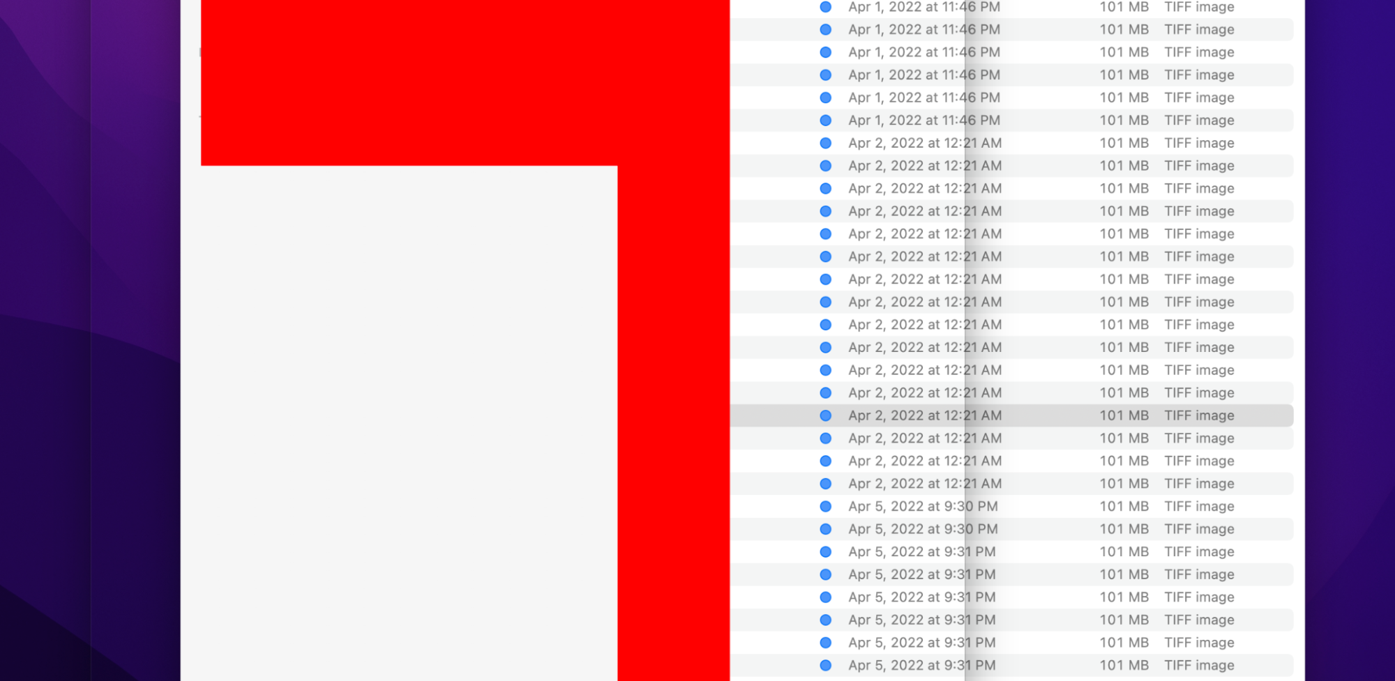

Intel GPU shows black box glitch(like 2nd picture I attached) and
AMD GPU shows red box glitch...both preview works fine after 3 sec.

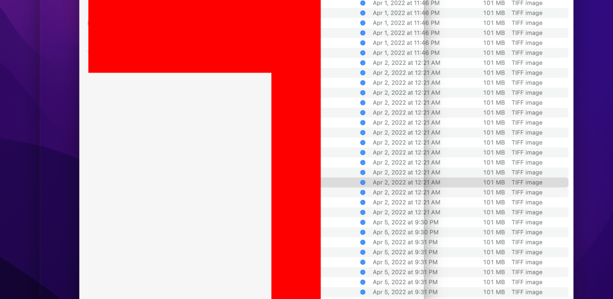

AMD gpu, preview test

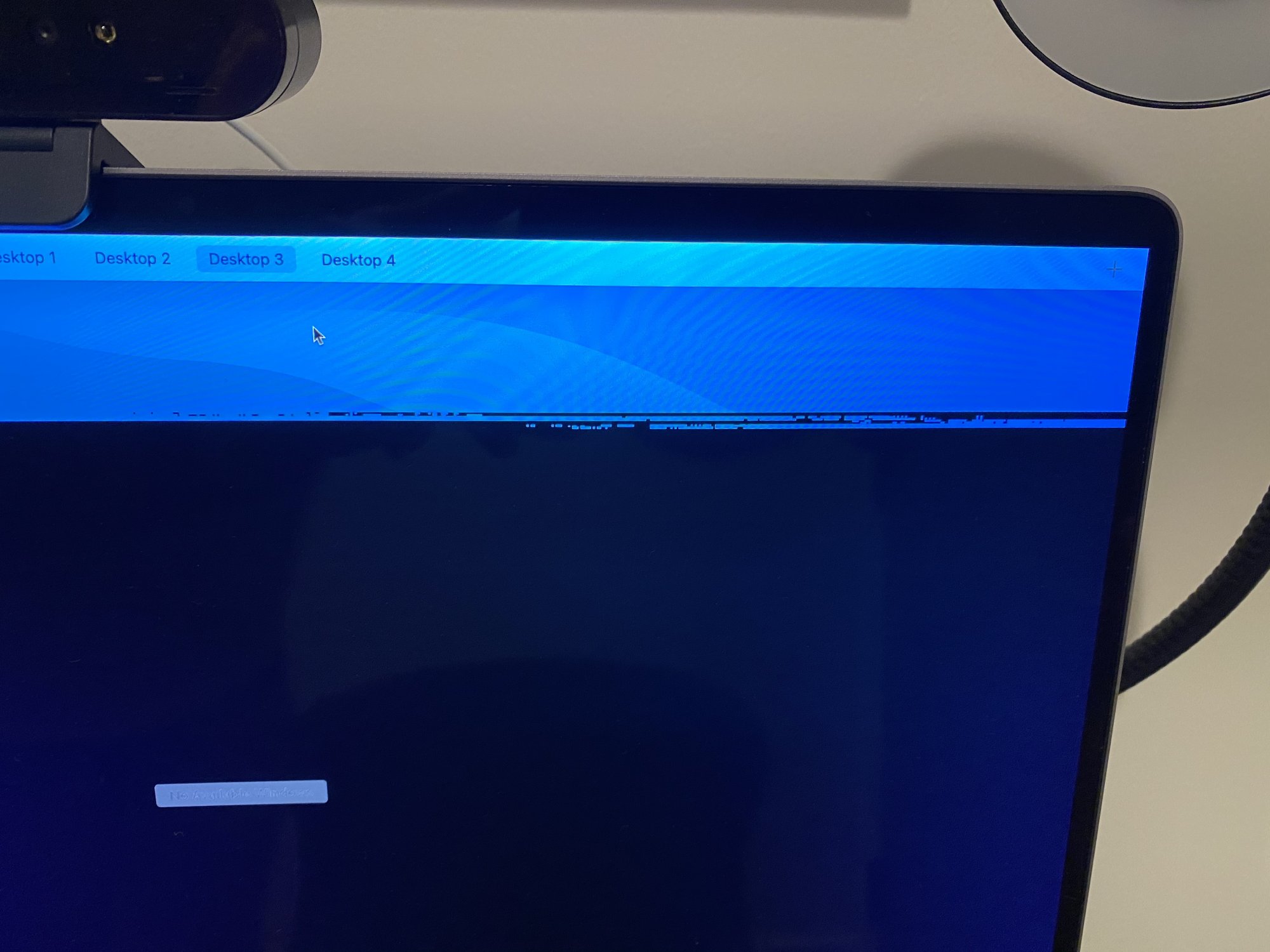

Hi,
thank you for your ideas.
what do I have to do for GPU memory overheating? Should I apply thermal paste or something?
Are you running a program to change your fan speeds? If so, turn that off and see if that helps with the issue. Did this just start happening recently, perhaps with a macOS update? If it did just start happening recently, send a bug report to Apple, and wait for the next patch, to see if it is resolved. If it has been happening since you purchased it, and you are out of warranty, a re-paste of the CPU/GPU and GPU Memory might help. Chances are if it was a sudden development, it was caused by the current GPU driver, and will need an update from Apple to solve. If it is a driver, you might be able to roll-back to the previous version of macOS (12.3 or even 11.6) and see if that works better for you. Doing that would be a lot of work though :-(.
