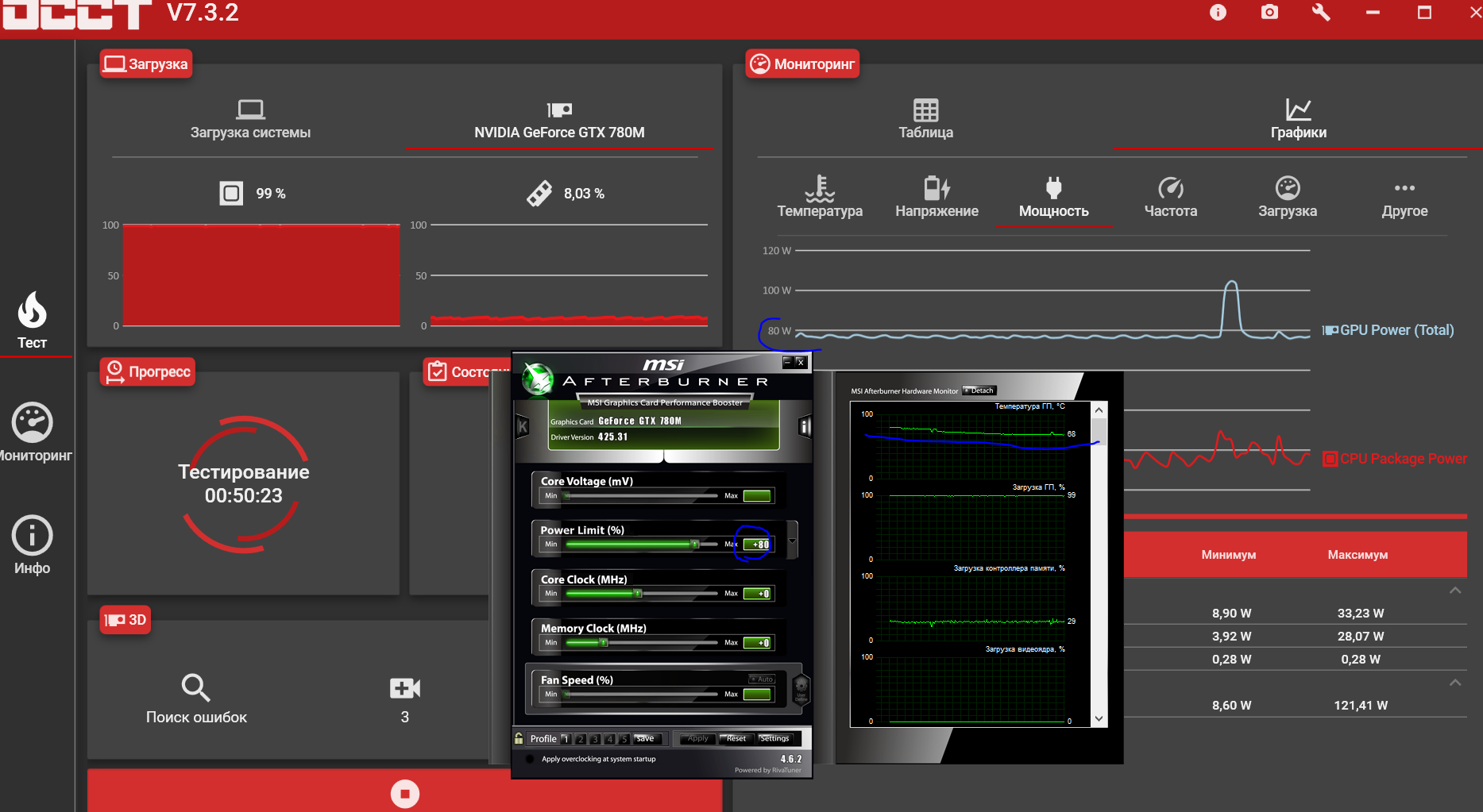

When consumed at 100w, the video card overheated over 80 degrees at any fan speed.
At 80w, the temperature dropped to 69-70 degrees Celsius and does not rise higher in the stress test. I will experiment further to get the best performance possible.
