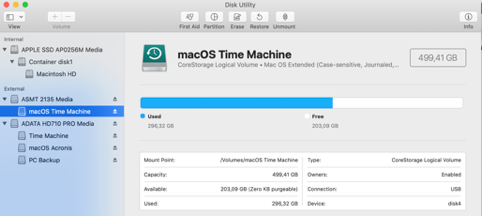

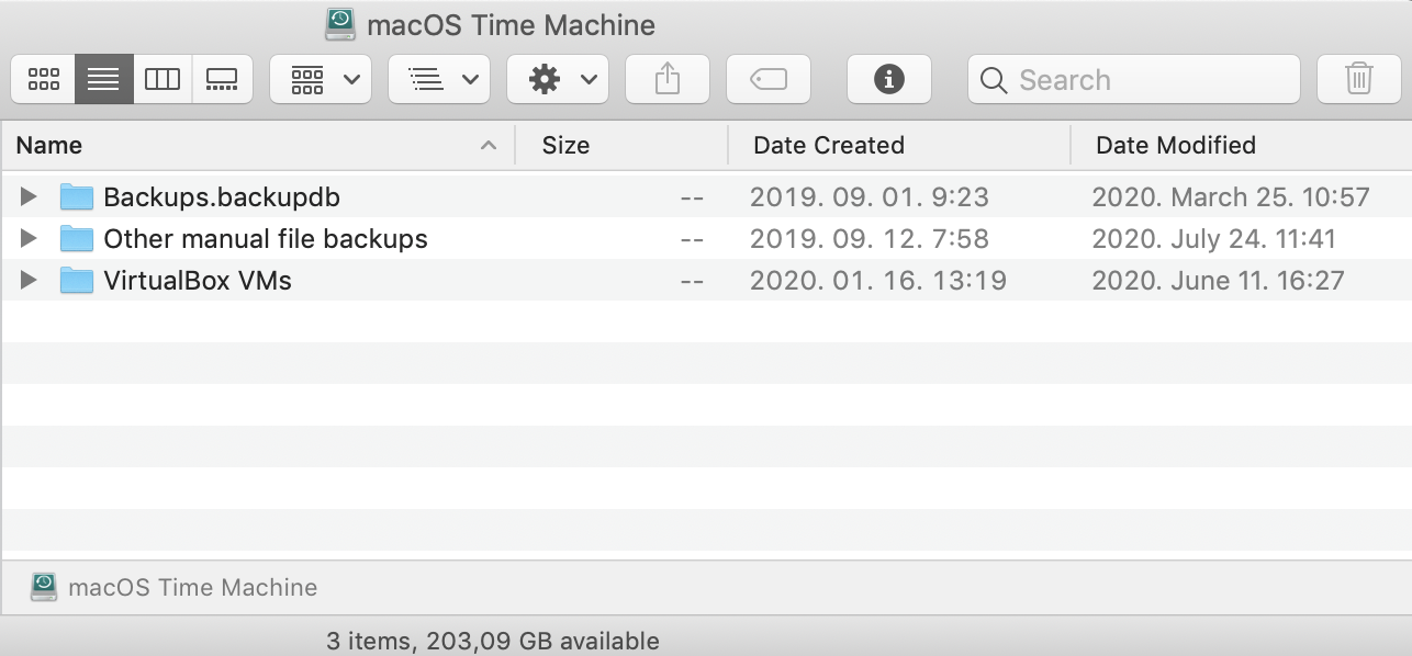

My old Time Machine backup is on a 500 GB external HDD called "macOS Time Machine":
As you see above, 296,32 GB used on this drive.
Here it is important to know that besides the Time Machine backup ("Backups.backupdb" folder) I have 2 other folders on the drive taking up 73,87 - 69,0 = 142,93 GB space:
So 296,32 - 73,87 - 69,06 GB = 152,49 GB is the size of Time Machine backup ("Backups.backupdb" folder).

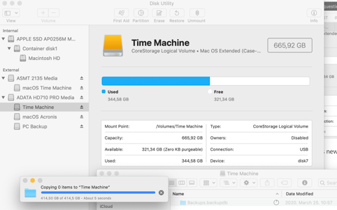

After a night of copying now I see this:

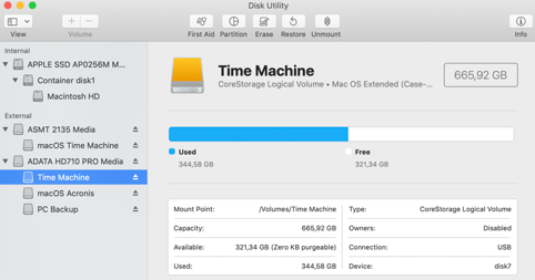

The copy window shows me that macOS copied 414,5 GB to the new drive already, but Disk Utility shows the used space only 344,58 GB. How can it be? (yes, I refreshed the Disk Utility window)
Also, on the first screenshot above I see that Drive Utility reports 296,32 GB is used on the old drive, so how could macOS have copied already 414,5 GB (and still copying) even considering that we know I have 2 other folders on the source drive that I do not copy over, so as we calculated: Time Machine folder needs to be 152,49 GB only that is to be copied?

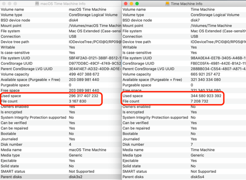

Looking at the partition information is also pretty interesting:
Source partition (left side) has 3.163.830 files while the target (right side) has 7.208.732 files and growing!
How could this happen? Where are those 4 million more files come from?!
Also, the copy windows looks pretty weird showing "Copy 0 items to..." and not being able to calculate the size of the data to be copied: the "414,50 GB of 414,5 GB" numbers keep growing in parallel and the "About 5 seconds" keep stay forever "5 seconds".
What is wrong with this simple copy process?
How can macOS report so false numbers for a simple folder copy operation?
How can Drive Utility report bad numbers?

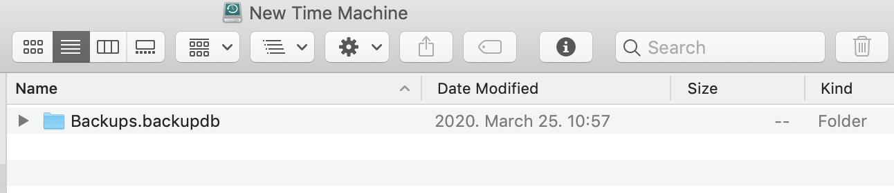

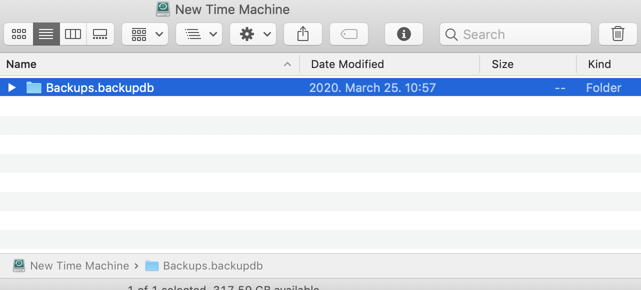

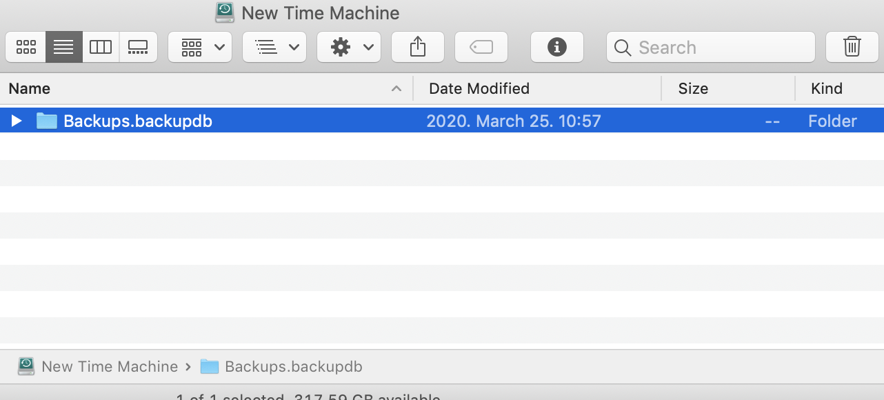

I see your drives are both formatted case-sensitive. That's unusual. Also, instead of showing us windows from Disk Utility, can you show us what you see in Finder? You should only see Backups.backupdb.
I suspect that you copied Backups.backupdb to the new drive, and then set up Time Machine again so that it's making a second copy.

I just now stopped the never ending copy process, unmounted and remounted the external drive.

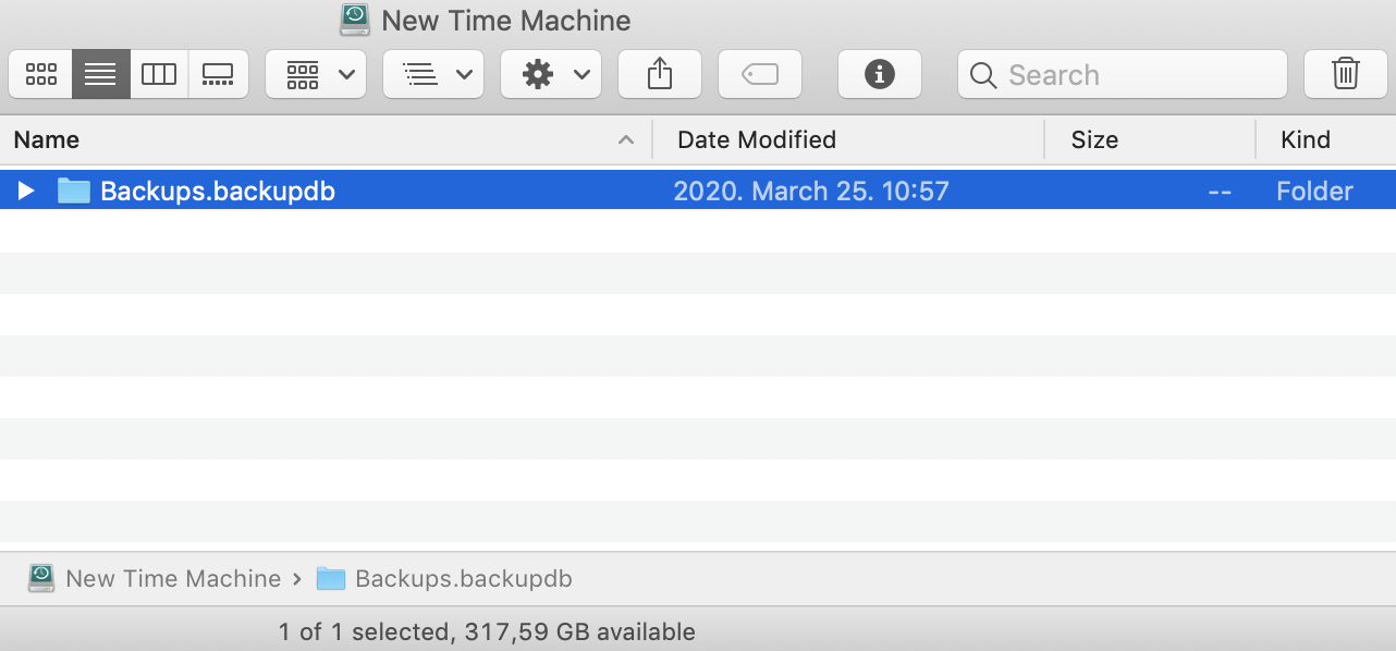

Finder shows the source drive as:

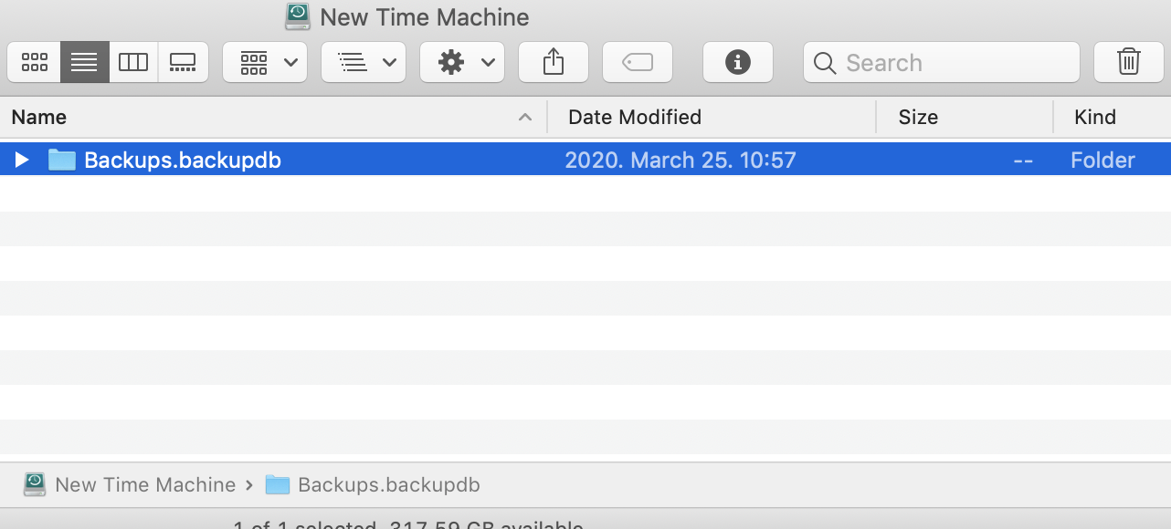

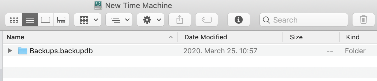

and the target drive as:
Keep in mind that I am speculating. Your target drive shows just the one folder, but it must have more files in it than the original. I don't know why.
What I would do is reformat the new Time Machine volume to Apple's preferred format, Mac OS Extended (Journaled), and let Time Machine start over from scratch. Set the original Time Machine drive aside as an older backup, just in case. While you might think you're losing years of backups, all you're really giving up is the ability to go back in time for older versions of files. The main value of Time Machine is that it protects you if the primary drive fails, and yours hasn't. That's why it's ok to start fresh.

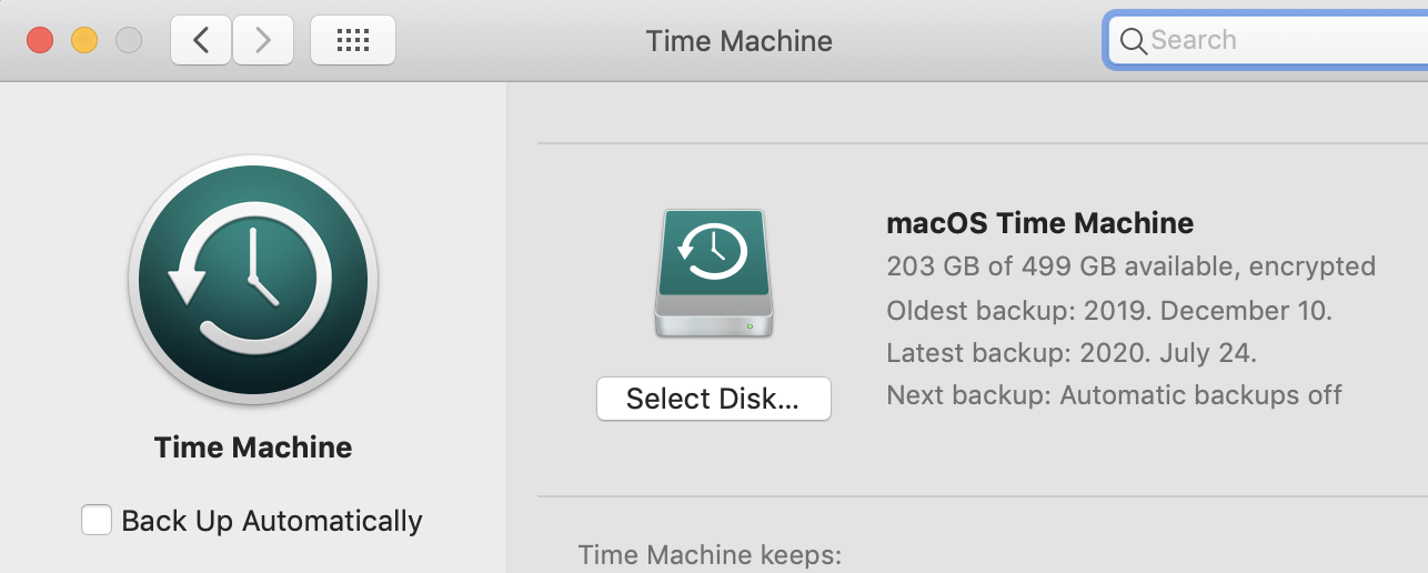

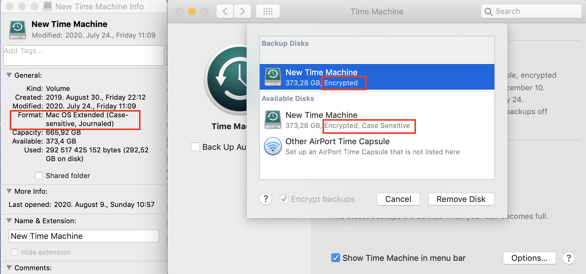

But not to let us go sleeping well with aforementioned mysteries only, now when restarted my MacBook today and plugged in the New Time Machine drive only, it looks like macOS recognised it somehow and automatically set itself up to use it as the Time Machine volume - despite all guides (incl. Apple's) that say: "After copying the old backup file to the new disk, select the new disk in Time Machine preferences"
So the last mystery for those who got this far with Apple: strangely now the new Time Machine volume is reported as
  1. "Case-sensitive, Journaled" (in Finder)
  2. "Encrypted" (in Time Machine)
  3. "Encrypted, Case Sensitive" (in Time Machine)
Last two are both within the same application! A total mix-up! Which one should you vote for now?
Looks like macOS may not even know about itself the basic things... just keep running somehow!!! Great job, Apple!
