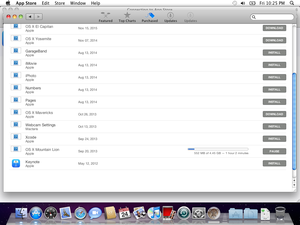

These installers are actually pretty new from June 2021 and both have the same http link
Mountain Lion 10.
I was talking about old installers from 2013:

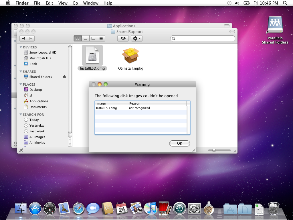

The Apple link installs in the Application folder and starts upgrading right from within Snow Leopard. No errors, no certificate issues. Everything works fine. The old installer's InstallESD.dmg does not mount because it is not a DMG:
But even that started the upgrade of SL to ML.
My conclusion for the Upgrade of SL to ML:
Any installer works on fully updated SL system.

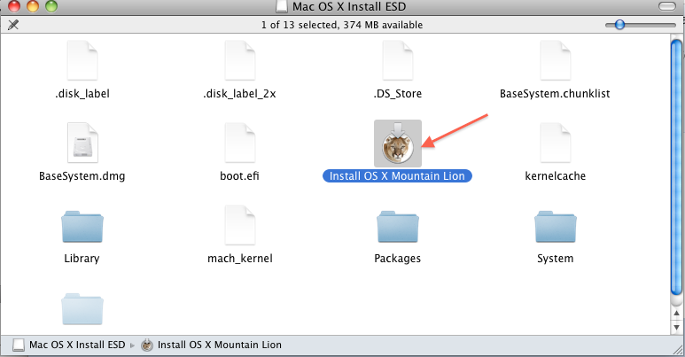

I take that back. You are correct it comes with an error on a real machine, but it works in Parallels. I found a solution for the real machine:
Code:
open /Applications/Install\ OS\ X\ Mountain\ Lion.app/Contents/SharedSupport/InstallESD.dmg
Double click:
And proceed with the upgrade.
Good catch, and interesting that it works in Parallels. It consistently failed in VirtualBox for me, on two different hosts, just the same as on real hardware.
I can confirm that mounting the dmg in SharedSupport and running the installer app there works to upgrade from SL to ML, and without having to reset the date and disconnect the network. Also, after converting the dmg in SharedSupport to an iso, it also seems to be working for a clean install of ML onto a blank virtual drive.

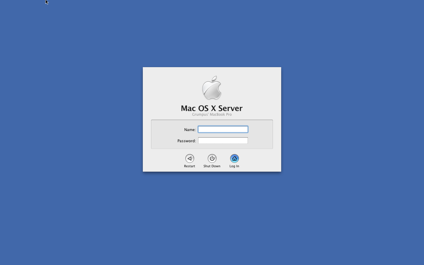

I installed Snow Leopard in Parallels using a hack:
And the installer works fine there.
Then I installed Snow Leopard Server in Parallels without any hacks and it comes with the same error. Go figure.
Well, it's still a mystery to me :oops: sl_disk_setup.applescript is somewhat opaque, being one runon line, and the blog post that google turned up doesn't clearly state what's going on. But, as near as I can tell after glancing at things, the purpose of the script is to fool Parallels into thinking that Snow Leopard is Snow Leopard Server at boot time. This is accomplished by creating /etc/rc.local containing this
Code:
/bin/rm /System/Library/CoreServices/ServerVersion.plist
and by creating /etc/rc.shutdown.local containing this
Code:
cd /System/Library/CoreServices
cp SystemVersion.plist ServerVersion.plist
So at shutdown time, SystemVersion.plist is copied to ServerVersion.plist, and at boot time ServerVersion.plist is deleted. I suppose that prior to the boot Parallels sees the ServerVersion.plist and thinks it's about to boot the Server version (which is supported) and during the boot /etc/rc.local deletes ServerVersion.plist turning it back into the regular Snow Leopard.
I don't know how this could affect the installation of ML, but maybe I missed something.
BTW, if you log on to Snow Leopard, manually copy SystemVersion.plist to ServerVersion.plist, then after a reboot you get a Snow Leopard Server login prompt and the desktop background is changed to solid blue. I don't know if any functionality is really changed though. The ML installer still fails as before. Oh well.
That is what happens yes. The version of the SL I installed is a free version in the paid developer's account.

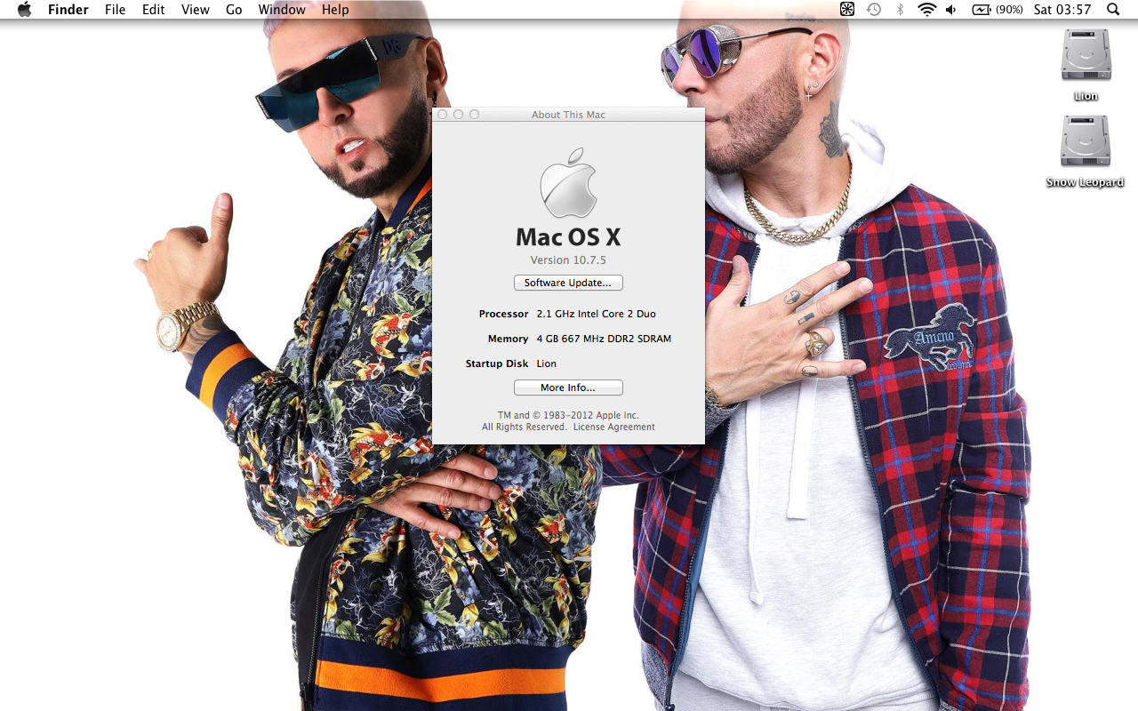

I made a partition and upgraded that partition to 10.7.5 (the other one is 10.6.8). I can still use both when I want to, but I was thinking that it might be smoother from Lion > 10.8 (Maybe I am wrong).
Maybe if I try using the code from this thread to put the ML installer to Applications (on Lion), then it might work from there, yeah? Thank you for sorting this issue out. I really appreciate it.
