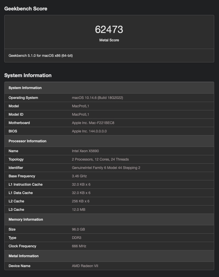

He is running an older Geekbench for that test. With Geekbench 5.1, the Metal score for Radeon VII went from under 50K to more than 68K. There were some optimizations required in the Geekbench code and they made a big difference. Here's my result with a Radeon VII: https://browser.geekbench.com/v5/compute/364729
but is not so far away from a 2.0x16 PCIe slot in 5.1 cMP

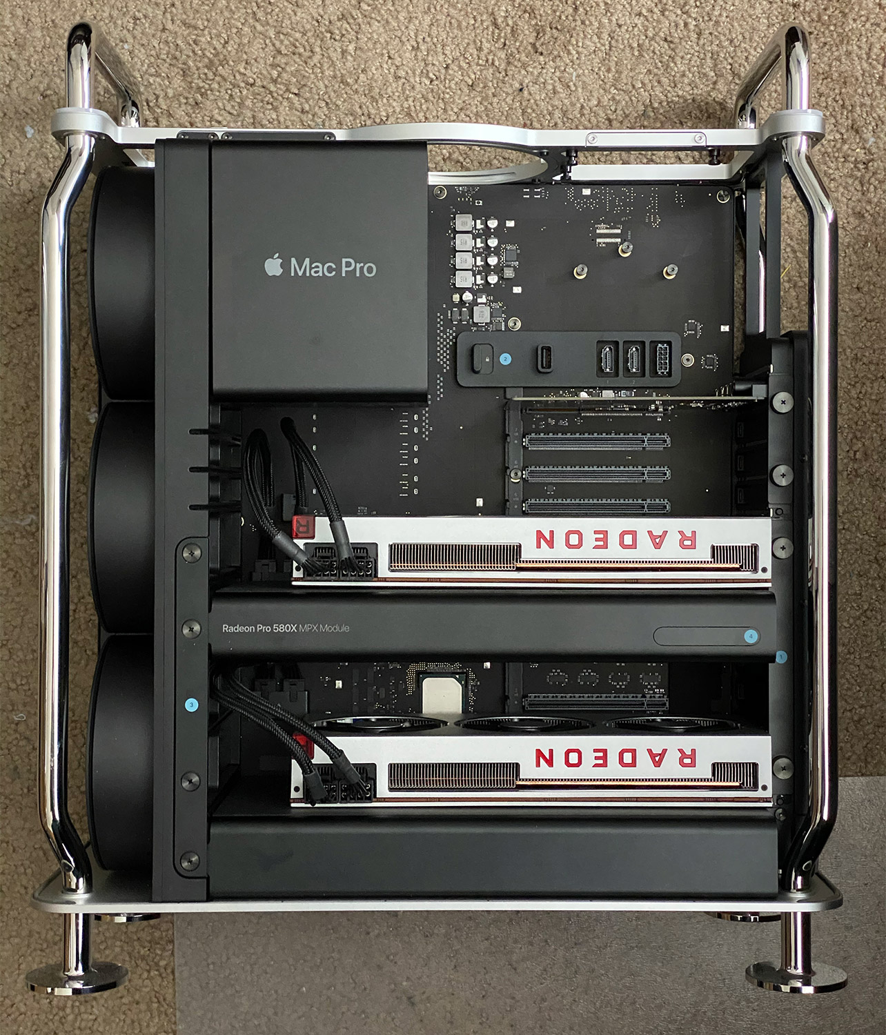

Got the ASUS R VII, will install later, and should I pull the 580 out? because of the power consumption, and LR and PS will not use multiple GPU right?
Thank you for the suggestion! I just swapped positions, and everything works fine, plus I gained an extra unobstructed x8 slot.
I am curious - with the MPX RX580 in slot 3, can you connect four displays to the four Thunderbolt ports of the I/O card and Mac Pro top?
It's interesting to know that the presence of an MPX module does not disallow usage of any of the four 8 pin power connectors. But maybe other MPX modules could have different results? There's probably some kind of protection for the total current being used - maybe the computer just shuts down if there was too much current. Something smarter than that is probably unnecessary (like turning off power to the 8 pin connectors when certain MPX modules are connected).
A GPU doesn't use much power unless it is being used for rendering or compute or display. I don't think you should remove it unless you need the slot or it causes problems or...
Does the MacPro7,1 show boot screen on the Radeon VII without the MPX RX580?
You can't connect USB-C or Thunderbolt displays to the Radeon VII (not easily anyway).
I left the 580 in place. It uses almost no power just sitting there.
LR and PS can’t currently use multiple GPUs. Capture One does, and so do most non-Adobe products. Hopefully Adobe follows soon.
[automerge]1577972325[/automerge]
I don’t have any TB3 displays, so I can’t test using 4 displays in that method.
Yes there is a boot screen, even with the 580X removed and only using a VII.

It seems power connectors still work with vega II module installed. There must be some limit though.
Barefeats has got a vega II duo working with two Radeon VII internally...
I think the power supply is capable of rerouting power however is necessary between the MPX modules and the 8 pin ports. Barefeats test seemed to prove this. The Vega II Duo had to have been drawing close to the limit of the MPX module, yet they were still able to draw full power from that 8 pin (I think it’s around 250 watt limit on each 8 pin). Meaning that MPX bay + the 8 pin adjacent to that slot was well over 700 watts combined.
Too bad he didn't have two Vega II Duos to try with the two Radeon VIIs. I don't think macOS can use more than four GPUs so the extra GPUs won't use much power.
Any type of display will work with the appropriate USB-C adapter. Some adapters make the computer think a display is connected even when no display is connected to the adapter (a cheap way to test multiple display support without having multiple displays).
There wouldn't be enough unobstructed PCIe x16 slots to run two Vega II Duos with two VIIs.
I don't have the appropriate adapters, either. :)
True. There's only one extra x16 slot. You would have to use an x8 slot. I don't think x8 would limit performance much. Slot 5 can take a double-wide card, but Slot 7 can't unless you remove the I/O card in slot 8. But slot 8 is only half length. So the last graphics card needs to be ITX sized, or it needs to be modded for single slot (liquid cooled). There's not a lot of room to add liquid cooling (maybe a 140 mm rad+fan above the I/O card?).
