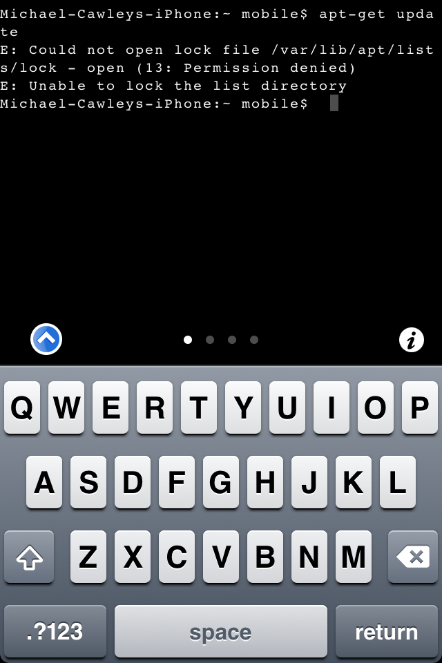

Question, I have the apt package installed and when i run apt-get update I get the below error. Any suggestions?
EDIT: nvm figured it out, have to log in as root.
