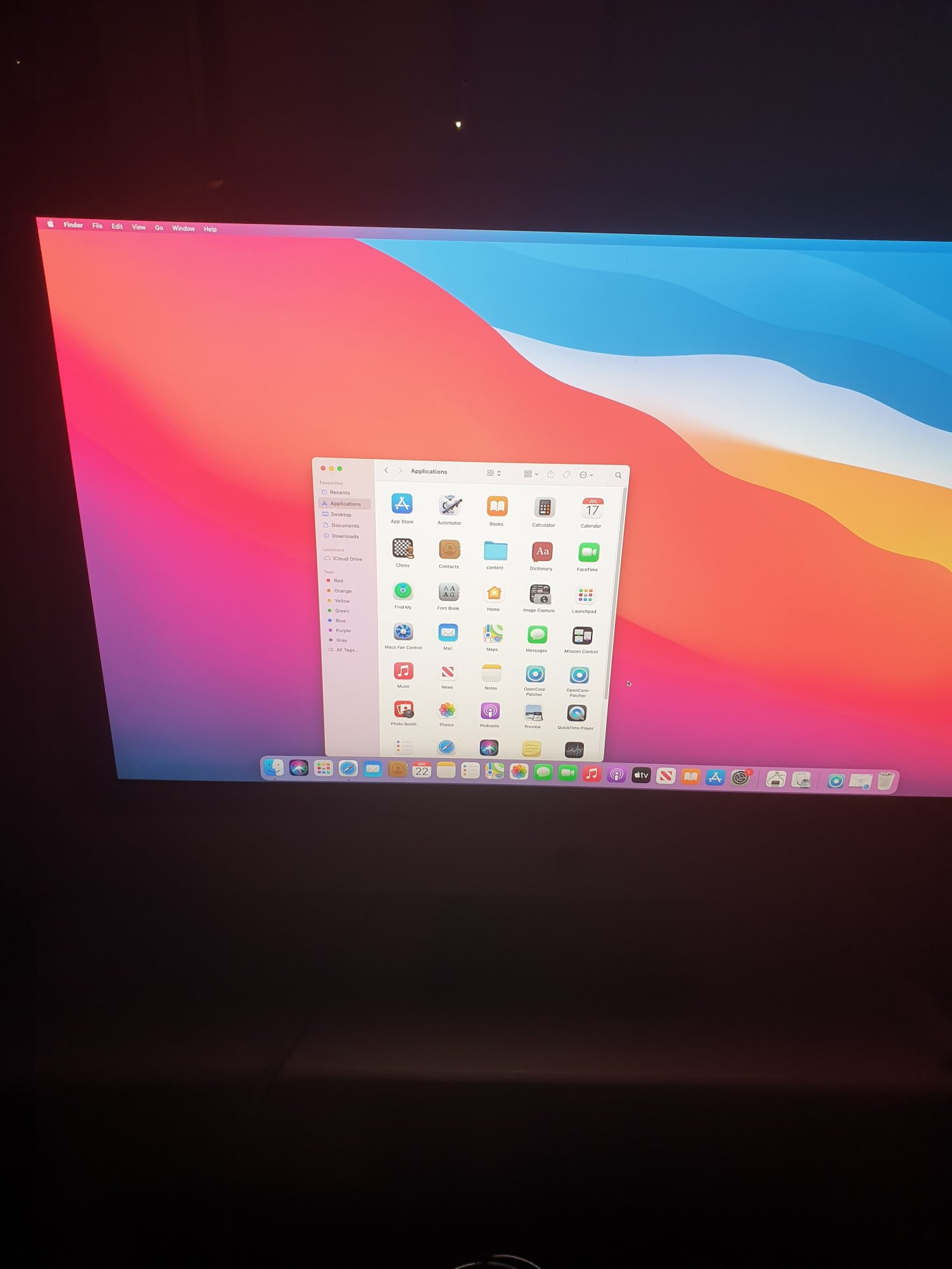

Yeah finally I waited 2 hours 45 min on 1 minute remaining done thank u for help mate
Hope your daughter will enjoy this gift :) We had a lot of work with it!
If you want to bring the system into the future spend her a small SSD instead of the rotating rust (HDD) and stick with Big Sur for the time being/coming unless all small bugs with Monterey have been solved!
Have a nice and silent time, stay healthy!
