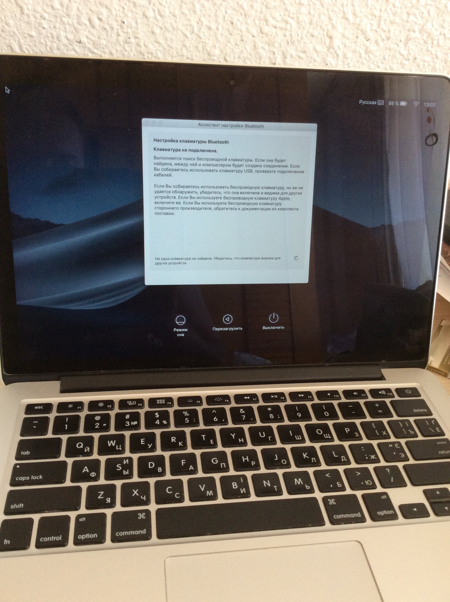

After a few seconds when I restart the computer and try to fill in the password the keyboard doesn’t working, the touchpad doesn’t work either. The computer itself starts looking for a blootooth keyboard for connecting. The only button that works is the power button, so I can only turn on and turn off the computer. Could you please give some advice on this? Thanks beforehand.

Just a random guess, but:
Check out the cable that runs from the trackpad to the motherboard.
It is just beneath the bottom cover. Running over the middle of the batteries.
Sometimes you can get it to work while adding pressure on the bottom plate right between the keyboard/trackpad.
If the pressure makes it work again order a new cable from ebay 🙂

That looks like one of the good (2012 or earlier) 13" MBPs.
Did you spill something on it?
No, I didn’t spill anything on it. The version is macOS Catalina 2015, 13”.

I started pressing random buttons and moving the courser and suddenly it started working. At times it freezes, and I press the “Command” button and touch the touchpad and it seems to help after some time.

So it's a MacBook Pro (Retina, 13-inch, Early 2015)? AKA MacBookPro12,1?

So it's a MBP Retina 13-inch 2015?
I'm thinking it sounds like a hardware issue, possibly an expanded battery putting pressure on the connections.
