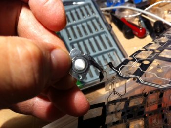

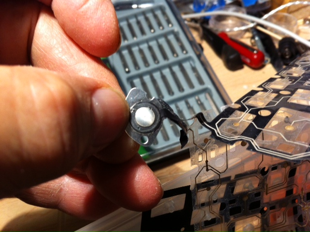

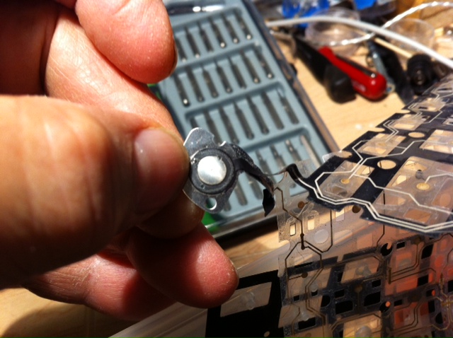

The retina MBP and Air route the power connection through the keyboard and a defective keyboard can affect the power button.
Does the power button work at all?
I have a macbook pro 2012. The powerbutton worked on the old keyboard but doesnt on the newer one
It's a pain but re-installing the replacement keyboard may fix the issues. An alternative solution would be get another replacement keyboard.
