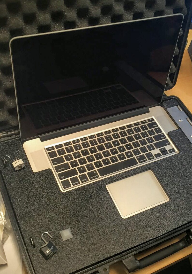

So, a bit more information: Its not an actual 'Kiosk' machine for random people. We know who will be using it but we dont necessarily trust them.
We need to make sure the software and/or data we load stays on that box and isn't tampered with outside of what's been provided. That's why no network access or communication of any kind is allowed be it Ethernet, WiFi, Bluetooth etc.
They won't be using USB mice or keyboards; in fact the machine will be physically secured to help prevent actual use of the ports. (See attached)
I just want to do my part on the software side just in case. (Every layer helps)

I would check the usb ports on the mouse and keyboard every so often if they are usb, for a keylogger could be inserted between the device and the usb port. Never mind...just looked at your picture.....😵🙂
Keep in mind that even the internal keyboard and trackpad both use the internal USB bus, so disabling that bus would essentially not let anyone do anything.
I think that standard user accounts, plus parental controls, and a firmware password (although your physical installation should go a long way to prevent intentional access without damaging the MBPro) will leave you with a fairly secure portable.
