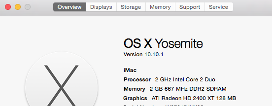

Testing kext replacement with iMac 7,1 running Yosemite (OS X 10.10.1)
Thanks to @barryburek for spelling it out on this thread (and all those who have gone before him), I was able to install the 10.6.2 (ATI) kext files for my ATI Radeon HD 2400 XT 128 MB card on my mid-2007 20" iMac running Yosemite.
I have the same specs as @barryburek:
iMac 7,1
20-inch, Mid 2007
Graphics ATI Radeon HD 2400 XT 128 MB
Except that I am running OS X 10.10.1.
Here is what I did to update my kext files (following @barryburek):

At this point, after I rebooted my machine, I noticed that the graphics response was VERY slow. When I ran kextstat | egrep 'ATI|AMD' only the com.apple.ATIRadeonX2000 (10.0.0) came up. The other 10.6.2 ATI kexts I had previously installed were not loading.
So, after you reboot your iMac (if you are running Yosemite), this is what you need to do:
8. From Terminal, run: sudo nvram boot-args="kext-dev-mode=1" Enter your password when prompted.
9. Reboot your machine.
At this point, your 10.6.2 ATI drivers should load. Here is what I now show when I run the kextstat | egrep 'ATI|AMD' command in Terminal:
122 2 0xffffff7f8246c000 0x45000 0x45000 com.apple.kext.ATISupport (6.0.6) <81 12 11 7 5 4 3 1>
123 0 0xffffff7f824b1000 0xca000 0xca000 com.apple.kext.ATI2400Controller (6.0.6) <122 81 12 11 5 4 3 1>
124 0 0xffffff7f81a9f000 0x233000 0x233000 com.apple.ATIRadeonX2000 (10.0.0) <81 12 7 6 5 4 3 1>
126 0 0xffffff7f8257b000 0x12000 0x12000 com.apple.kext.ATIFramebuffer (6.0.6) <122 81 12 11 7 5 4 3 1>
Of course, since I just recently stumbled upon this thread tonight after living with iMac freeze issues for several months (if not the last year or two), I do not yet know if I am freeze free. But already I feel as though my system is both booting up and responding much more quickly than it did before.
Here's to hope!
