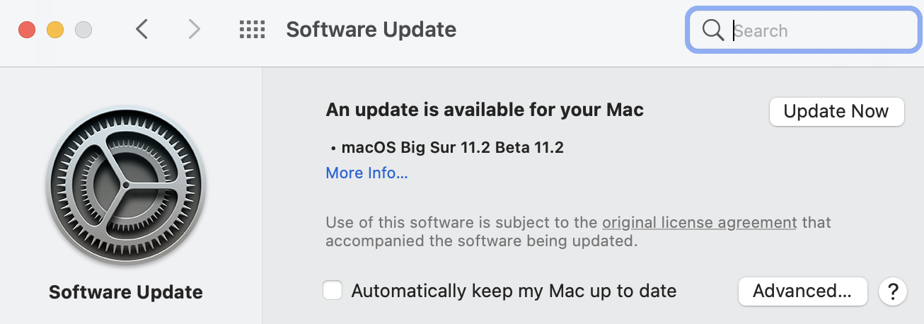

So, I restored back to the release of 11.1.
I left the beta program, both on the MBP and I unenrolled on the Apple website.
I can not make the update notification for the 11.2 beta to go away...
Any ideas?
I'm on the public build of 11.1 from Apple. I installed it from the app store itself.
Thanks. I don't think the unenroll procedures are working.
I wasn't actually enrolled in the Beta scheme but I too had this problem (for another reason).
I can tell you what I did but you may not like it :)
First I tried to re-install using the "re-install macOS" option in the recovery environment but that only offered me Big Sur Beta. This was on a brand new, out of the box M1 MBP. You could try that first but I suspect you'll find it offers the Beta.
I didn't want that so to cut a long story short I downloaded 11.1 from the App store and made a USB installer from it (after 2 failed downloads) and re-installed 11.1 from that using the second procedure in the link below (from "Or follow these steps").
That completely solved my problems with Beta seeds.

Mine said beta too, when I started the process. I'd imagine it may still say that if I boot to recovery.
I am indeed on the release, as I double clicked to see my build number after I went through all of that.
It's not hurting anything, I'm just a bit OCD about badges. I may just turn that off until 11.2 comes out.

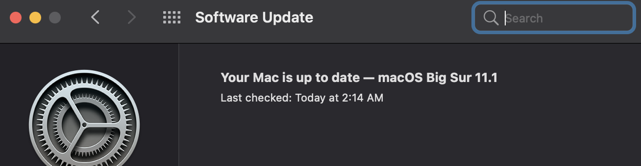

I'm in.
I still didn't do the iCloud sign out.
The erase twice seems to be the key for whatever.
I have a fresh, 11.1 release with no beta flags.
I'll grab Office and Jump Desktop from the app store... Install M1 Google Chrome (necessity), tweak my settings and take a fresh TM backup.
Thank you so much for working with me on this.
I'm glad to have this level of experience on M1 now. Still odd that I could have done this on an Intel Mac like a robot.
This is an iPac. lol. I don't know if I like or dislike that part. If I had a second Mac, though, this seems to be much easier.
That has never looked so lovely to me.

I'm in.
