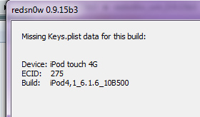

Hello all, I really welcome any thoughts on getting past this wrinkle in jailbreaking this ipod, with redsn0w. I've had luck with a few other ipod touch 4s, but getting stuck here.
redsn0w seems to successfully JB it on the first run, but when you go to "Extras ... Just Boot" after the initial jailbreaking, I get this error every time (attached file) ....
I heard that installing Itunes 11 could help with this, and it didn't seem to hurt, but I still get this error. Maybe I'm doing something wrong that's a simple fix -- any ideas, or other ways to approach this? Thank you for your help!
Wasn’t it the case that you needed to point redsnow to 6.1.2/6.1.3 IPSW instead?
Yes, you are totally right, I understood I needed that for the jailbreak but didn't figure out it also needs to be done for every boot. Thank you!
