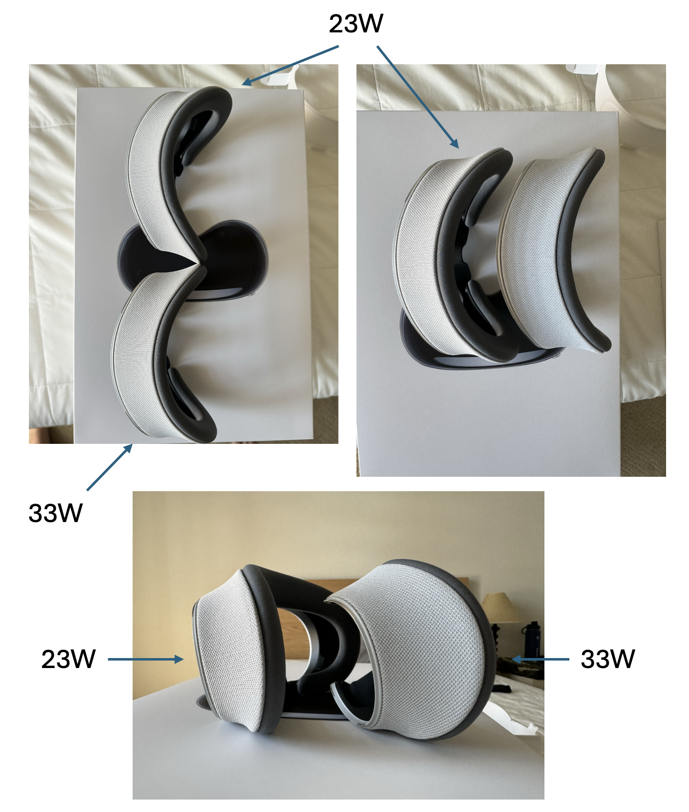

I've also replaced 33W with 23W (my initial scan was 25W). 33 was a bit more comfortable on cheeks, but the forehead part was protruding too far. 23W also seems to be a bit shallower.

Mine has always been like this last pic and I've had mine since the Wednesday after launch. I use Weiss readers and the 23W. If you used the 33W I can see where it could have been a good part of the issue you initially had.
Since I still have both units on hand, I tested them both with both seals. There is no difference in blur pattern between the two. The glare is also about the same.
When you say both units, you mean the light seals, right? So on the 3rd VP, the 33W and 23W both show the same blur pattern?
I meant two AVPs. I bought a replacement before returning the second one. My second one with 33W and my third one with 23W (I don’t have my first one anymore). The blur pattern stays the same on the same unit regardless of the seal, which makes sense, because it’s the lens issue.

Good to hear you got a better unit! But yeah, different light seals offering a different angle of attack and differing distances from eye to lens can place the blurry section of the lens in a different area of your view or possibly reduce it, but as was the same with mine, it was easily identifiable as a defect that was always present in some way.
I've now moved from 23W to 13W, the FOV has reduced a little but the angle of the headset has changed for the better on my face. There's less depth on the forehead part and more depth on the cheek part, and I was advised by Apple that the Solo Knit doesn't always need to sit on the upper part of your head but can be adjusted up/down and then re-tightened so achieve the optimal fit and clarity for my specific eyes and head shape. 13W has the headset tipped slightly back on my head for even contact on the cushion, and the solo knit pretty low on the back of my head - but I notice better clarity when worn this way. Even contact on my face with the 23W had the solo knit all the way at the top of the back of my head, which was comfortable but didn't offer optimal clarity 100% of the time like the 13 does.
Seem the first digit in the light seals is essentially angle of attack. "1" seems to be shallower forehead cutout+more depth at bottom, "2" seems to be closer to equal depth on top/bottom, and "3" seems to have the most depth on the forehead, with the shallowest bottom. The second digit seems to be the overall depth of the entire design. I tried 11W in-store and this adds up, as it has the same more favorable angle as 13W but with my eyes much closer to the lens (likely too close with inserts, felt a bit weird). I plan on going back and seeing if 12W is the sweet spot for me.
That's about right. The middle number is not absolute though, it seems to be relative to other light seals of the same design, as my eyes are closer to the lens with 23W than 33W.
Here is the comparison between 23W and 33W:
