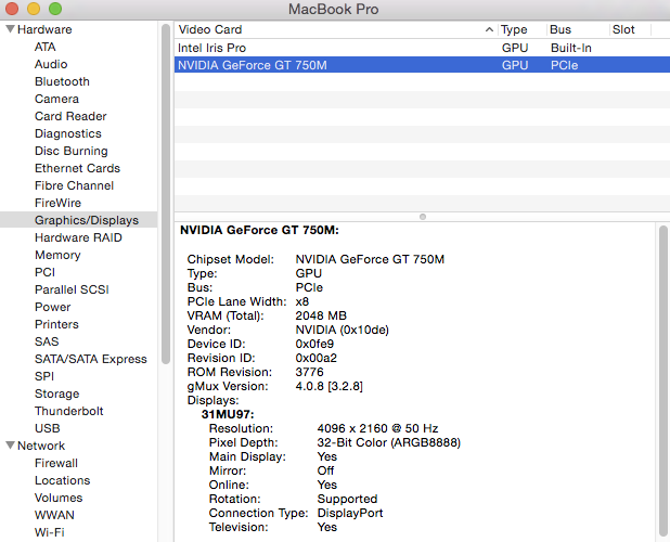

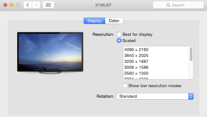

That file enabled more scaled resolutions (that are the correct aspect ratio)...
But I got dropped to 50hz ...
Removed that file and I'm back to perfect 2x 1080p resolution @ 60hz..
Got to be a way to get the scaled resolutions above retina 1080 desktop space working at 60hz.
Perhaps an upcoming Yosemite update will remedy?
I take it back

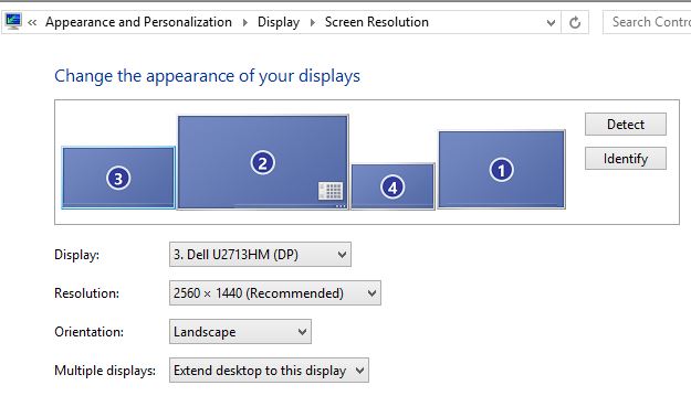

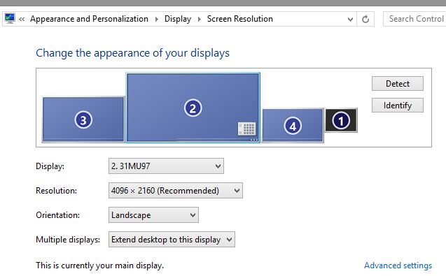

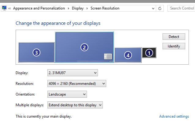

Just completed the unboxing and installation of the 31” LG. Thus far, a great experience. However, a word of caution.
I have a rMBP Late 2013. I’m connecting the 31MU97 via the thunderbolt 2 connector and I am able to reach the 4096x2160 @ 50hz without any settings changes on OSX Yosemite and on Bootcamp running Win 8.1 However –
When I attempt to connect another monitor to the second thunderbolt 2 connector, under bootcamp/Windows this works fine (at 2560 x 1440 and 60hz), yet under OSX … nothing. Its as if the port is shut off.
Moreover, under windows, I am able to connect a third monitor via the HDMI cable and get a 1920x1080 resolution. (Three monitors working)
And finally, under Bootcamp/Windows I can also get the laptop’s retina display to work (a fourth display) at 2880x1600 – yet doing this causes the 31MU97 to degrade to 3840x2160.
Given this, are there any other owners out there who have been able to get two of the thunderbolt ports working with the 31MU97 and another monitor under OSX? The hardware seems to support this, as Windows is able to drive the displays.
Thanks in advance.
Thanks in advance.

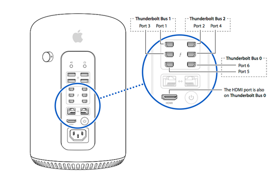

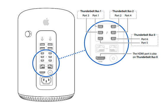

Are you connecting the monitors to different buses on your nMP (see attached)? Apologies if you're already aware of this - I only mention it on the off chance that you're not.
rMBP - ThunderBolt2 /BusCount (2/1)?
Just completed the unboxing and installation of the 31” LG. Thus far, a great experience. However, a word of caution. I have a rMBP Late 2013. I’m connecting the 31MU97 via the thunderbolt 2 connector and I am able to reach the 4096x2160 @ 50hz without any settings changes on OSX Yosemite and on Bootcamp running Win 8.1 However –
It looks like Charles-C is rocking a (rMBP)MacBook-Pro(Retina)2013, and not an (nMP)Mac-Pro(6,1). Please correct me if wrong, but I suspect that model only runs the one TB2 bus. In which case, his multiple-monitor-menage is quite surprising.
