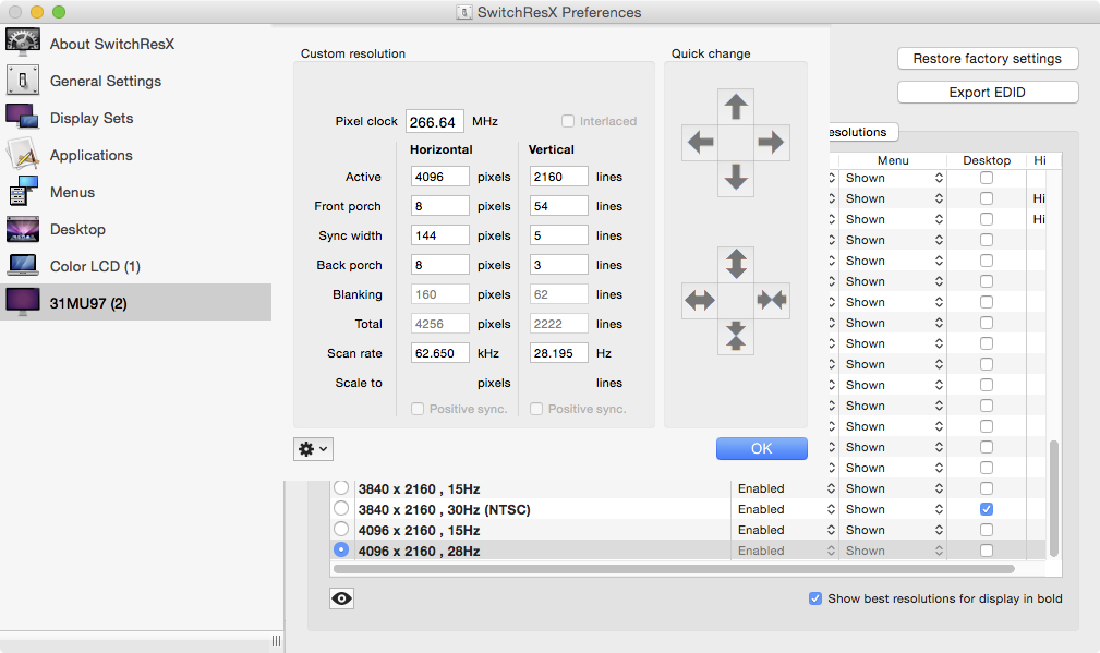

I have a 2012 macbook retina and I seem to be limited to 3840x2160. I cannot for the life of me coax the full resolution out of this monitor. Right now I'm running at 1:1 pixels so the left and right hand sides are black. Any ideas? Is my macbook retina too old to get the full resoulution?
Thanks!
I also have a late 2012 macbook pro retina.
I spent around 3 hours messing with SwitchResX before I found a setting that works at 4096x2160 and runs 1:1. Attached is a screenshot of the custom resolution I made. Hopefully it will work for you too.
Tried the settings, still no luck for me.

(disclaimer: I'm the developer of SwitchResX, I was directly implied in this with drecc)
We tested that file with drecc on his Retina MBP, and I in parallel I tested the same file with a second user (Not sure if he's following this thread also) having a MacPro with 2 D700 Graphic Cards (that's what the user reported to me as graphic cards in his config).
His feedback was identical. He also sent me screenshots that proved that only 50Hz (PAL) was possible, not 60Hz (the menu was grayed out in System Preferences)
I'm confident that it will work on both these machines, but none other. And 10.9.5 or above is required, it will not work on 10.9.4 or below.
