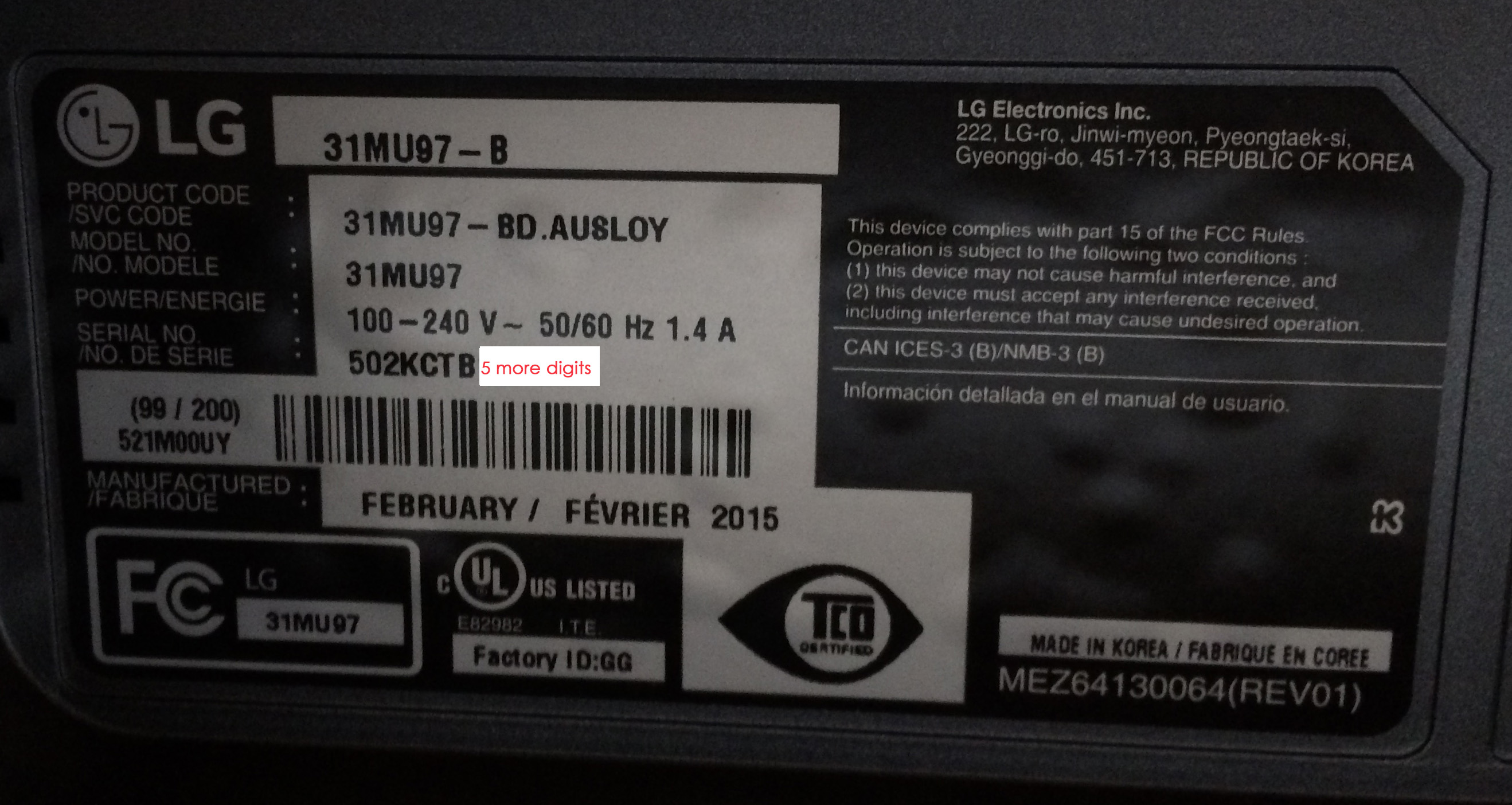

I would like to pursue an exchange if that would help. I've gone back through the last three pages of the thread twice, but still have the following questions for you and Sharkey:
1-How did you manage LG? Looks like Sharkey kept getting 2nd-hand garbage monitors. From LG, or the retailer?
2-What version of the monitor do you two have? What should I be looking for? If it's the "B" version, I think I have that, too. My label is attached to this post.
3-Any other recommendations?

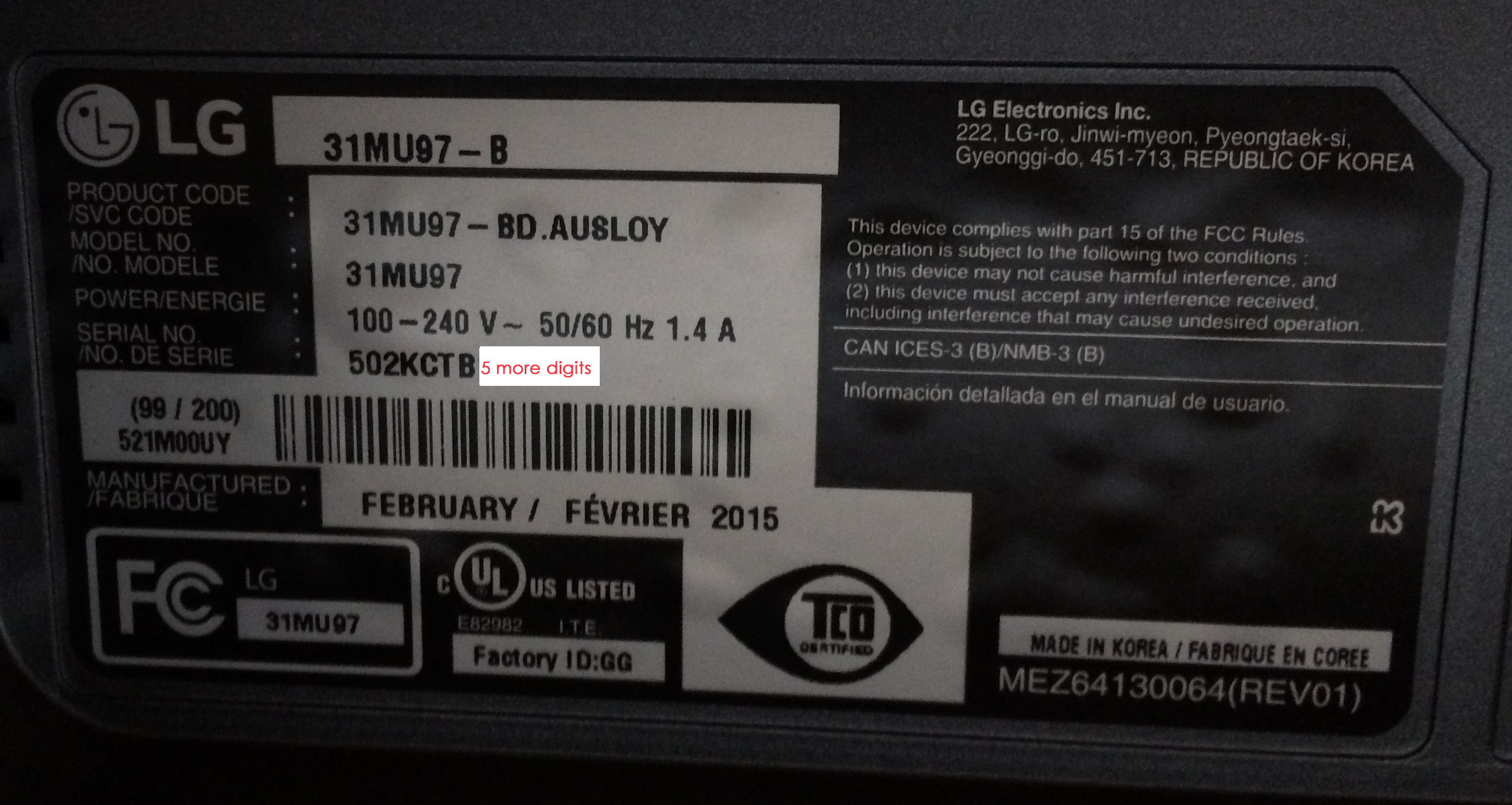

1 - I didn't have to contact LG as my monitor worked fine from day 1
2 - I have a "B", although my monitor is older than yours. My manufacture date is October 2014 and the revision number (bottom right of the label) is 00 where yours is 01.
Sharkey's original monitor was newer than mine too so it doesn't look as if the date it came out of the factory is relevant unless the newer models are the ones with the problems which although unlikely isn't out of the realms of possibility.
