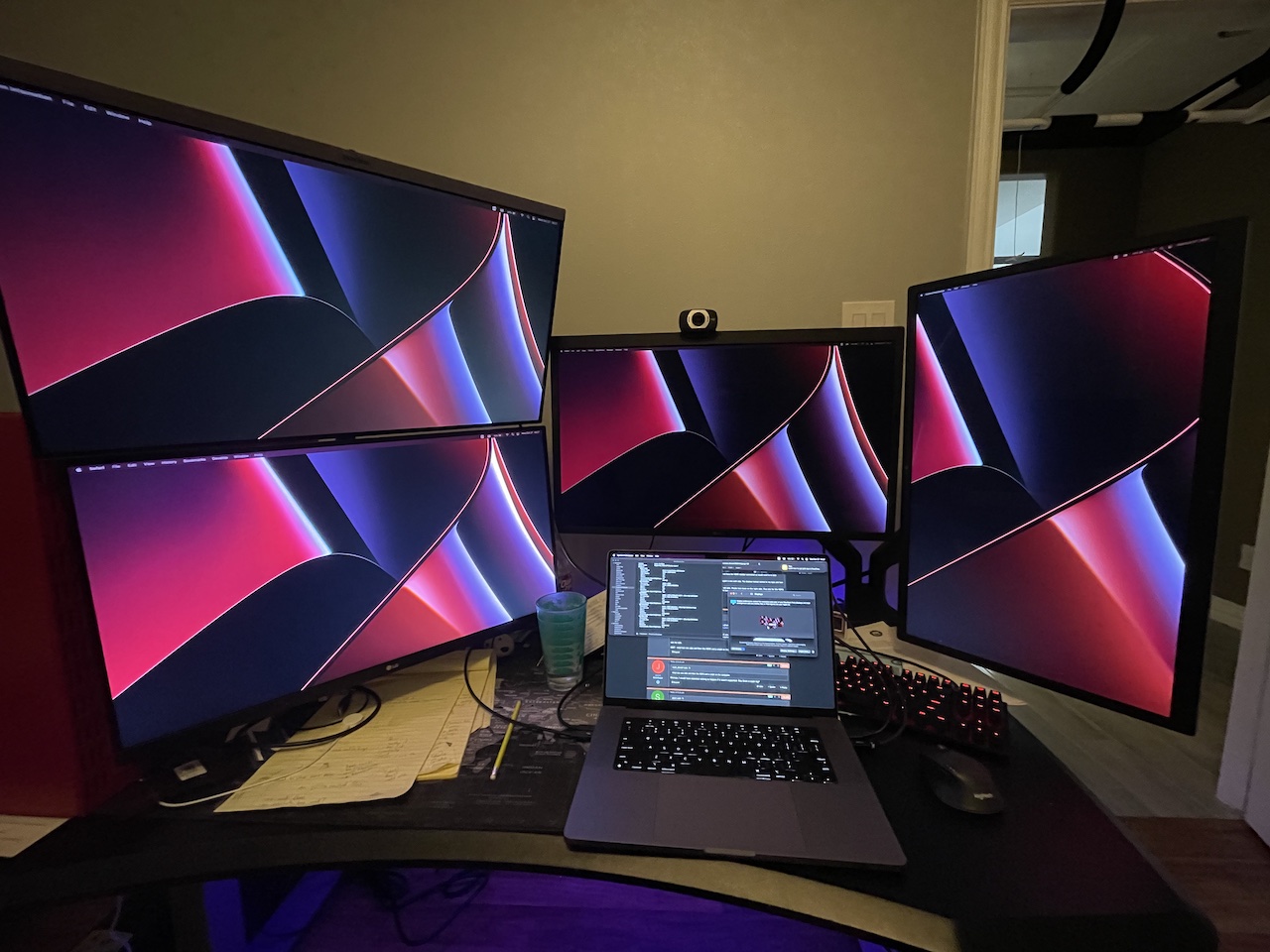

View attachment 1881364I just got my MacBook Pro 16 Max and reading this thread got me curious. My old MacBook Air could only handle one external display. The MacBook Pro 16 max was able to handle 4 displays. One new LG 5k, one old lg 5k, and 2 4K monitors.
The 5K monitors are connected on opposite sides.
I wonder which display it chooses to charge from. Does the Mac figure out which one has the highest charging capacity and go with that one or is it the first one that is connected.

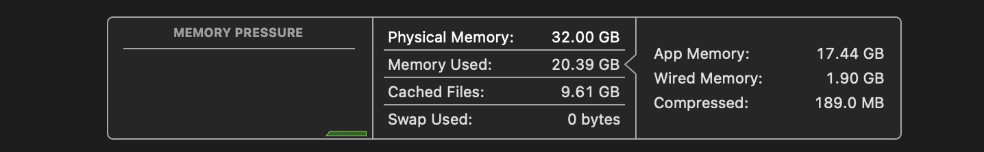

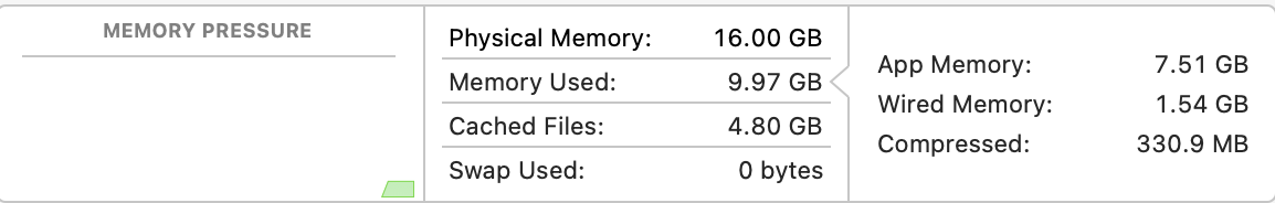

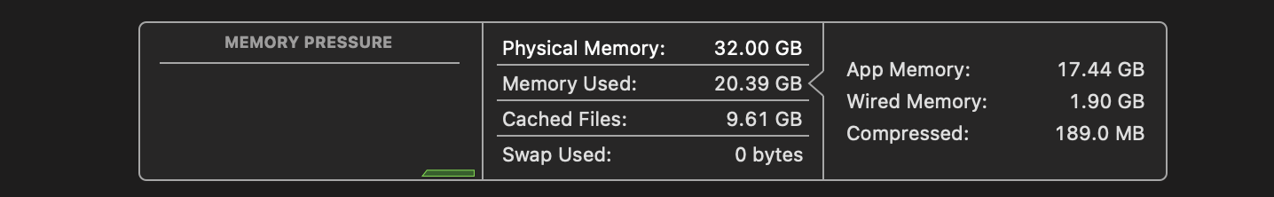

Folks that are lucky enough to be already in possession of the new M1-Max/Pro chips! Can you comment on the efficiency of unified memory? My 16" intel (i7) machine with the AMD 5300M 4GB gfx, struggles to push my dual Ultrafine 5k setup, especially if I'm not using in clamshell mode (and thus also using the 16" built-in!). GPU memory is always full (at 99-100%), fans frequently spinning up etc for very basic workloads.
Is the Unified Memory architecture better at driving these external 5K's? Specifically, I'm wondering if the base 16 GB memory is enough in this scenario or I need 32GB? Rest of my workload is programmer-like, although there's also lots of tabs with complex web apps, business apps (like Outlook), but not a lot of virtual machines.
Standard 16 Max.
I currently have 2 x5k monitors and a 1440p HDMI monitor attached, having my breakfast; 1 monitor is showing the Rogue invitational fullscreen on YouTube in chrome, 1 web browsing and email and the 1440p monitor is idle with VPN and Finder up.

I am still yet to hear a fan but again done nothing extensive yet on the computer.
Looks like a good deal of memory is already used up (20GB!) before you’ve opened anything much! So I suppose I better look at that 32GB version myself - maybe spring for more if I plan on any virtualisation…
Here is my base model 14" with the LG 5K in clamshell running a couple days and no memory pressure issues and I have yet to ever hear a fan come on.
I think the more memory you have the more the OS will take advantage of that and use it for caching, so it is expected to see what you do in @scott_donald's screenshot.
try not to worry about the memory used its about the pressure. My 8gb M1 air sits basically around 50% hovering between green and yellow. Yes mine uses swap but look how low scott's is...half yours and neither of yours even go above the S haha
