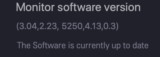

Edit: I decided to install the LG Screen Manager to check my monitor's firmware. The app claims the monitor has the latest firmware installed, as per below:

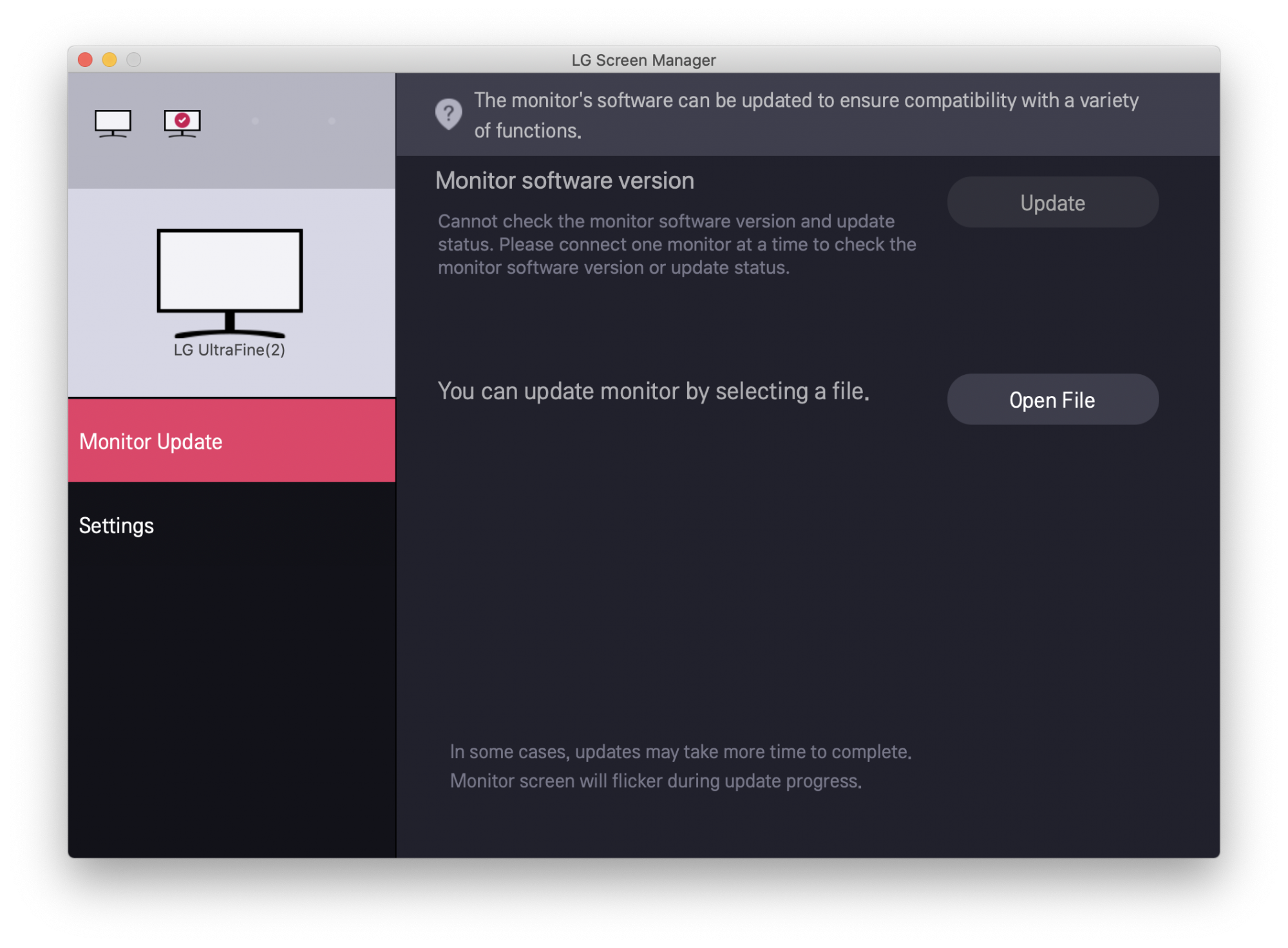

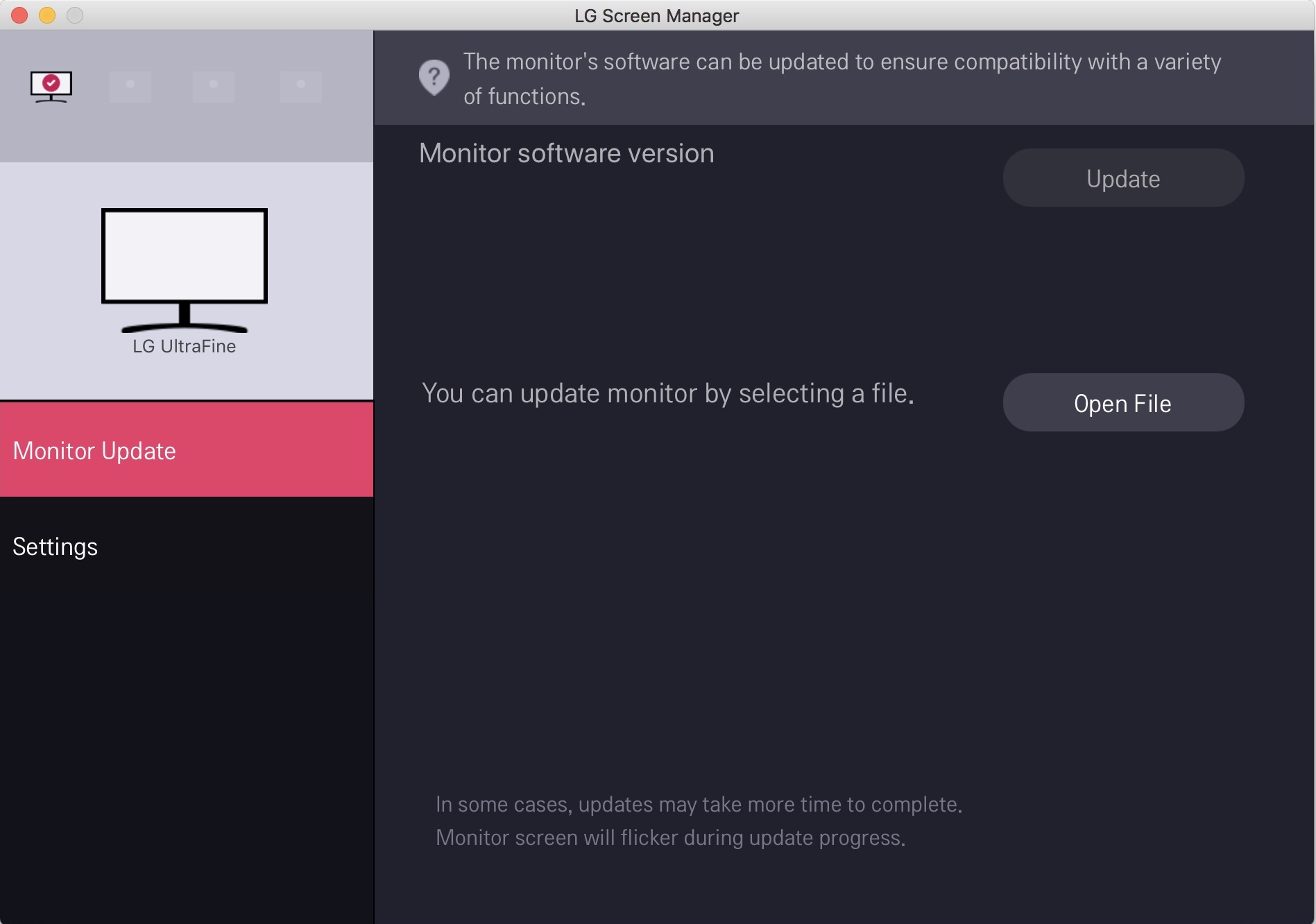

PSA: on the Mac App Store, their is a new update to the "LG Screen Manager (LG Monitor)" app.
- version: 2.79.
- updated: 13 Mar 2019.

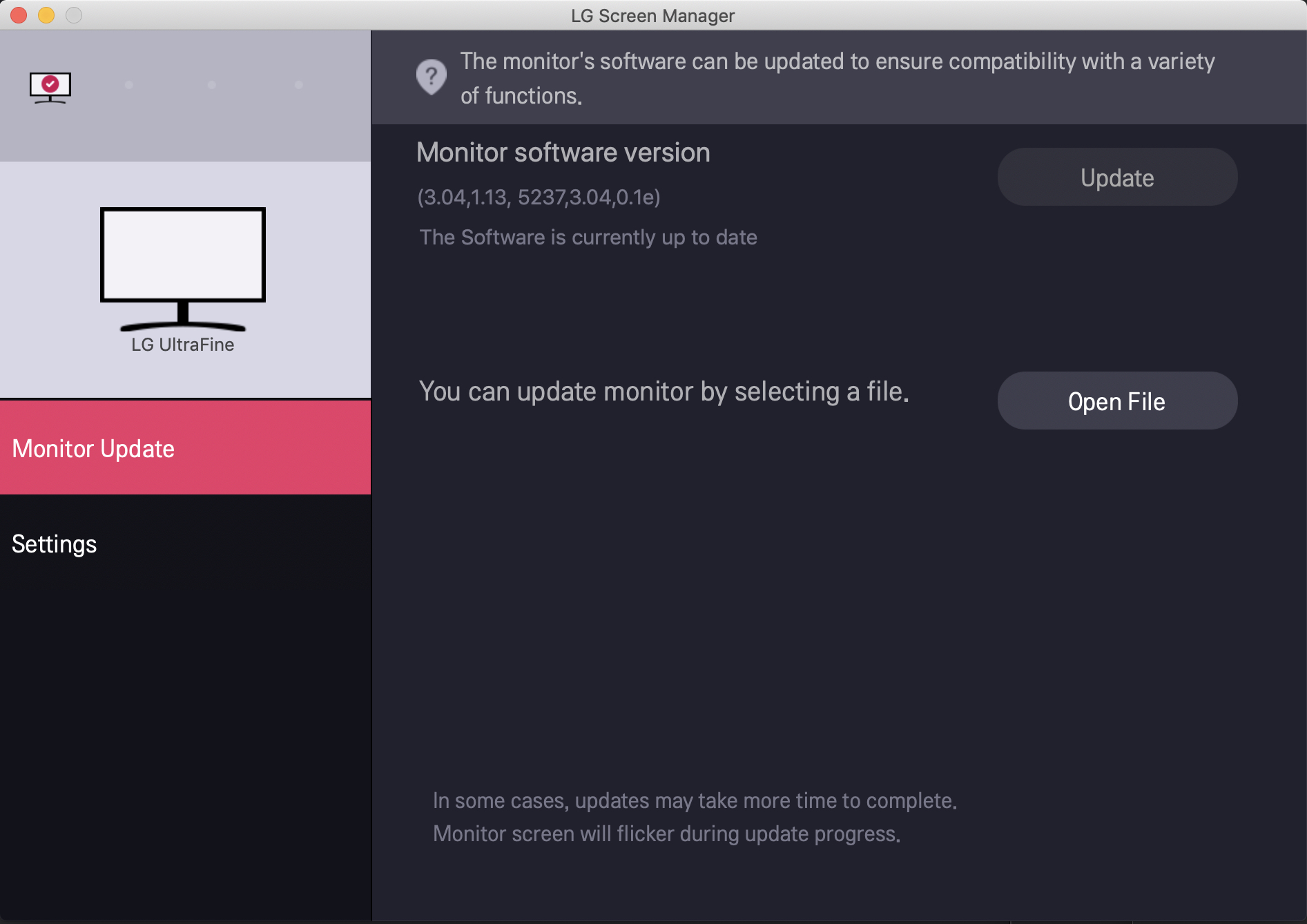

After updating to 2.79...
Mac Mini 2018 (10.14.6, Mojave) shows this: "3.04,1.13, 5237,3.04,0.1e".
MBP 2016 (10.13.6, High Sierra) shows this: "(none!)".
^ i.e. the MBP refuses to show what version I'm on?? Gee thanks LG, well worth upgrading to (not)!

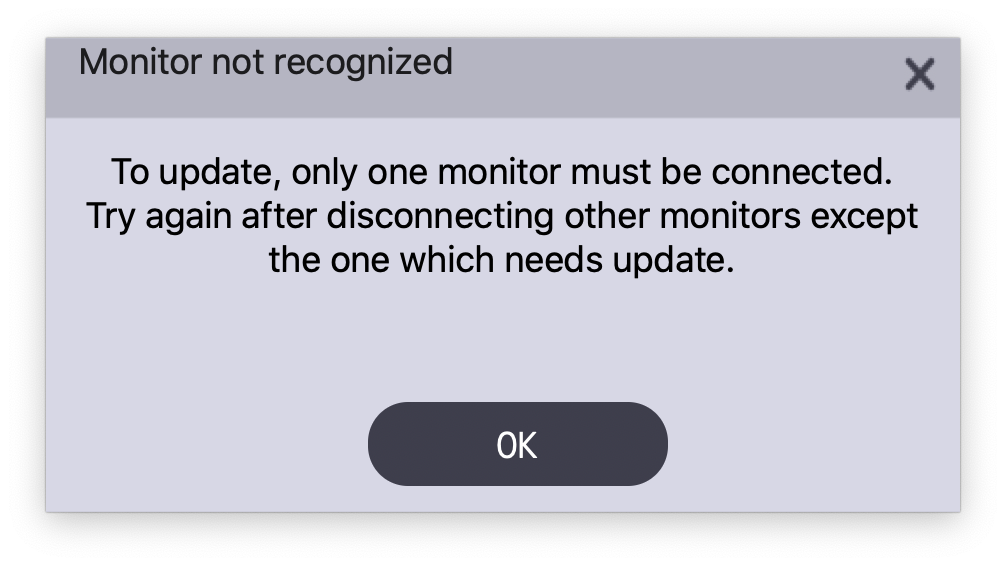

Thanks for the heads up. LG Screen Manager in App Store shows as 2.79
Under version history:
LG Screen Manager - Multi monitor
When 1 or more (max 4) connected monitors, you can update monitor firmware.
But when I installed it while connected to my two monitors the app still shows doesn't work completely:
NB: macOS version+machine?
...so it doesn't work at all or properly. Now there's a surprise.:rolleyes:
I suppose I could muck around doing a restart, setting everything I have running up again afterwards, just to see if this little crappy app suddenly works properly. Let me think...mmm, no!
