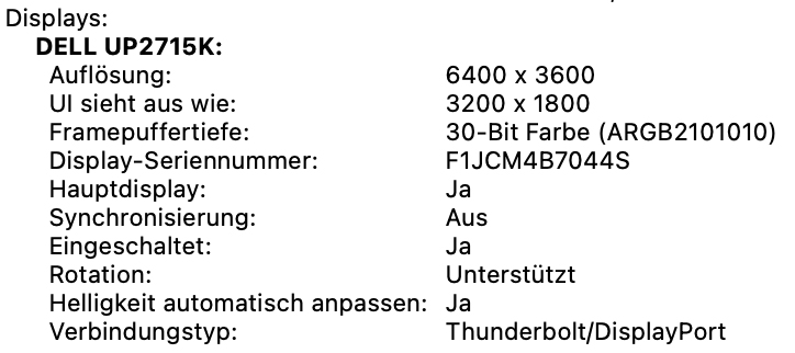

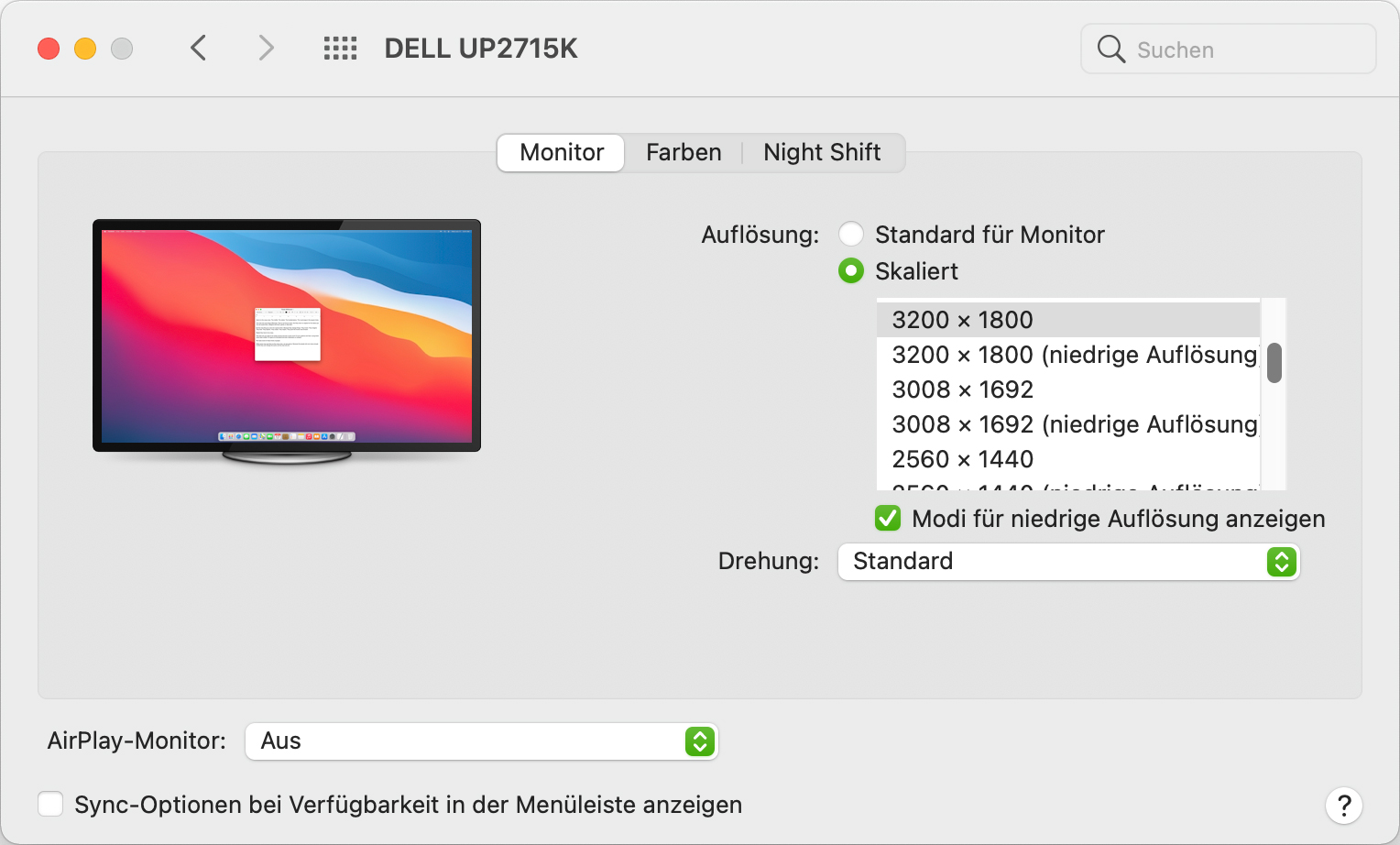

Which Mac model, version of macOS and connection type are you using to drive the LG?
Can you make a screenshot of your display settings?
In case you press opt-key + "scaled" make sure you use the 3200x1800 option that does not say "low resolution".
The OS itself should be rendered at 6400x3600 (framebuffer) and scaled down to 5K.
Provided you use an adequate connection, it should look (almost) the same as on the iMac / Studio Display (sharpness wise).
Unless the LG performs some additional processing (check that the sharpness/contrast setting on it is set to the minimum for testing).
