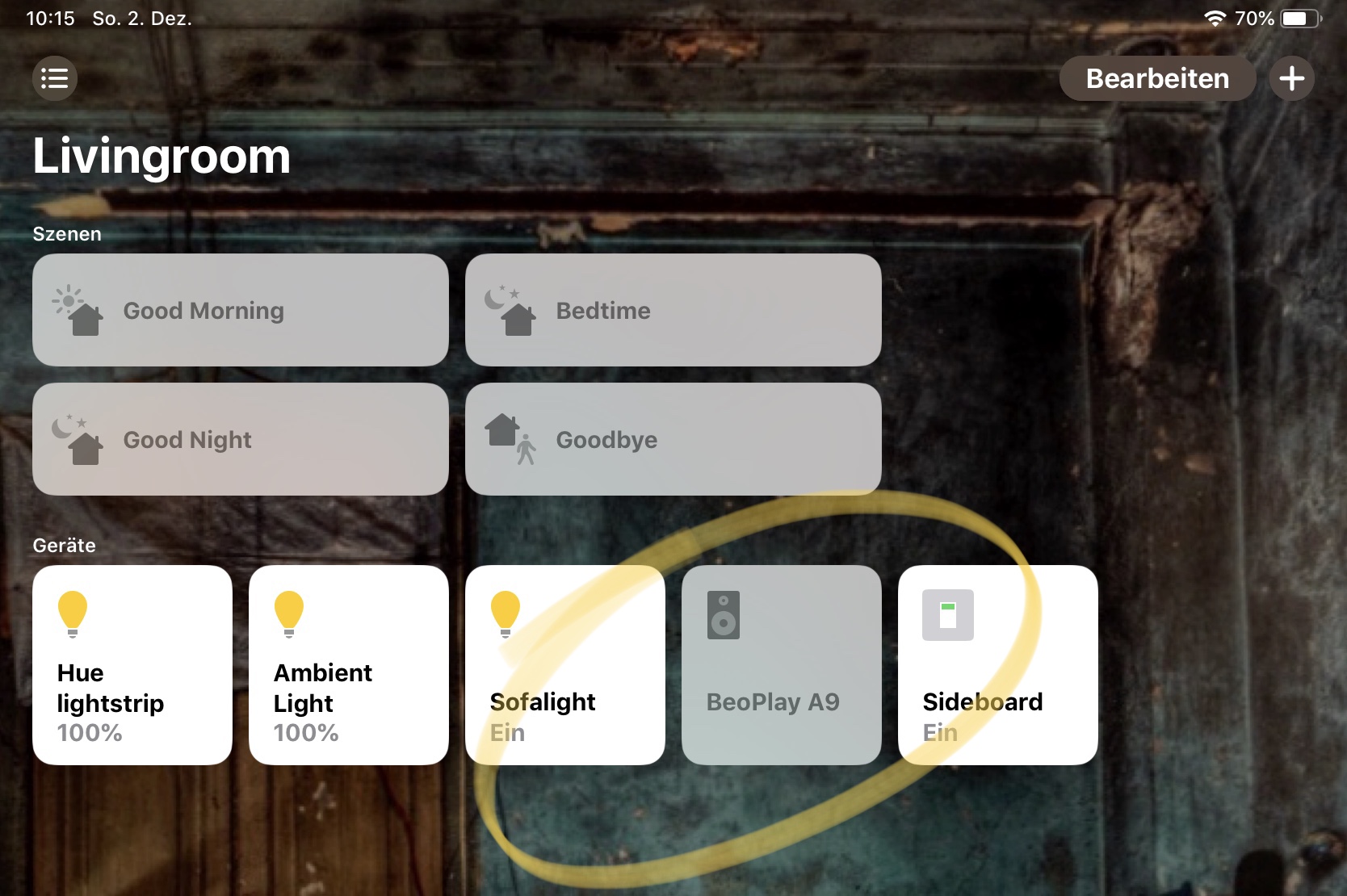

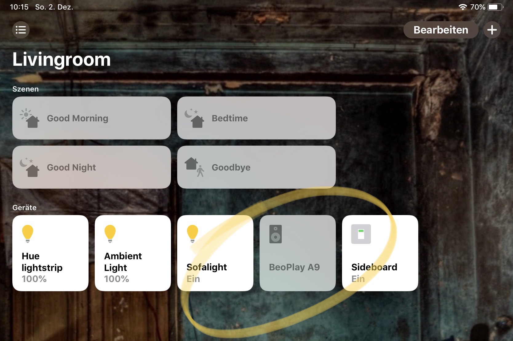

Beoplay A9mk2
09648F04-C7A8-4383-83CF-447E15E75873.jpeg 1BB61F35-9C80-477E-97D2-73B96FD6D2E2.png

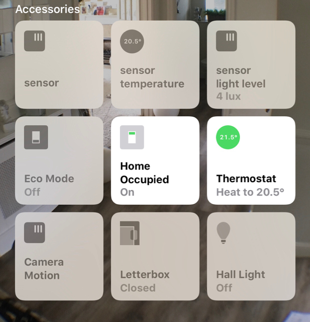

Yep all you need is a Raspberry Pi and a whole new world of products are HomeKit compatible.
Been using it for about 2 years now and a great product.
In this photo there is a Nest thermostat, a nest camera motion and a Xiaomi sensor on my letterbox.
