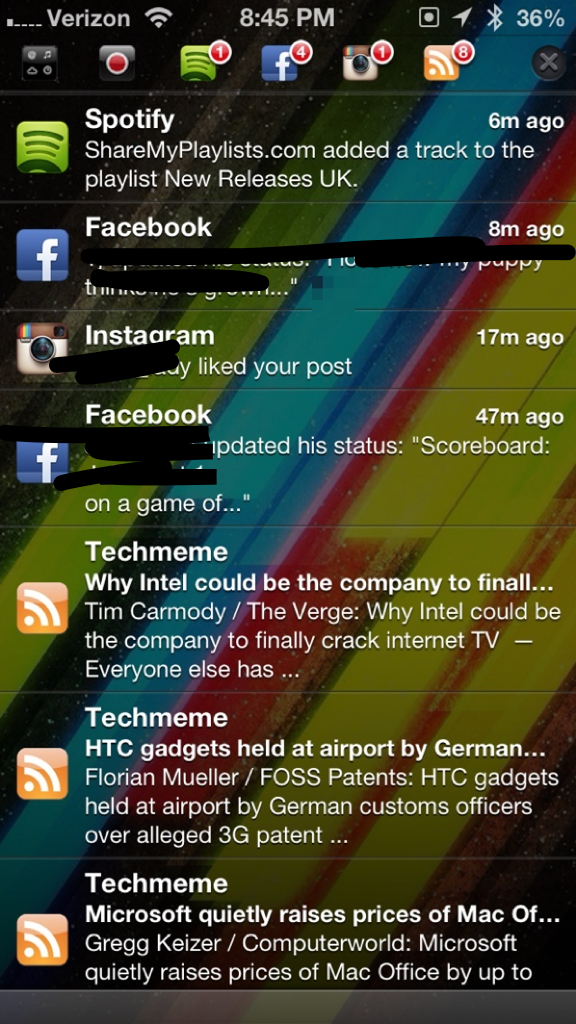

Any idea on why my LockInfo looks like this?
I had the previous version of LockInfo (paid) so I upgraded for free to this one. But as you can see..... 0.o
