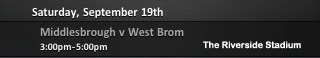

Changed mine again. Happy with it now except for one small annoyance .How do / Can I change the calendar events to look like the attached image( I added in the location in photoshop)
You will have to fix this in the .html doc usually named lockinfo.html
It is the longest document in the theme and a real pain to edit because there are so many commands in there.
Good luck.
Edit: Should read Lockinfo.js

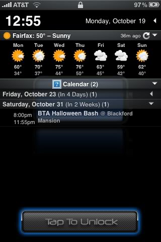

Attached are 2 screens of my final theme setup.

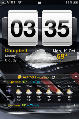

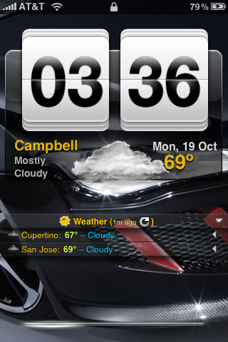

I'm having some trouble with collapsing/expanding.
Right now it looks like this by 'default':
but I want for it to look like this by default, but I can't seem to find the correct option in config.js.
I also want this to apply to call, SMS, etc...
Thanks for any help.
There's a section that gives you the option for which fields you want to auto-expand. It's just like most of the other options that use either "true" or "false". I wish I could tell you exactly where it's at but I'm at work and have no access to my phone's files.
I'm guessing it's somewhere in here (these are my current settings; can't figure out how to get Cupertino weather collapsed):
