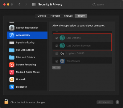

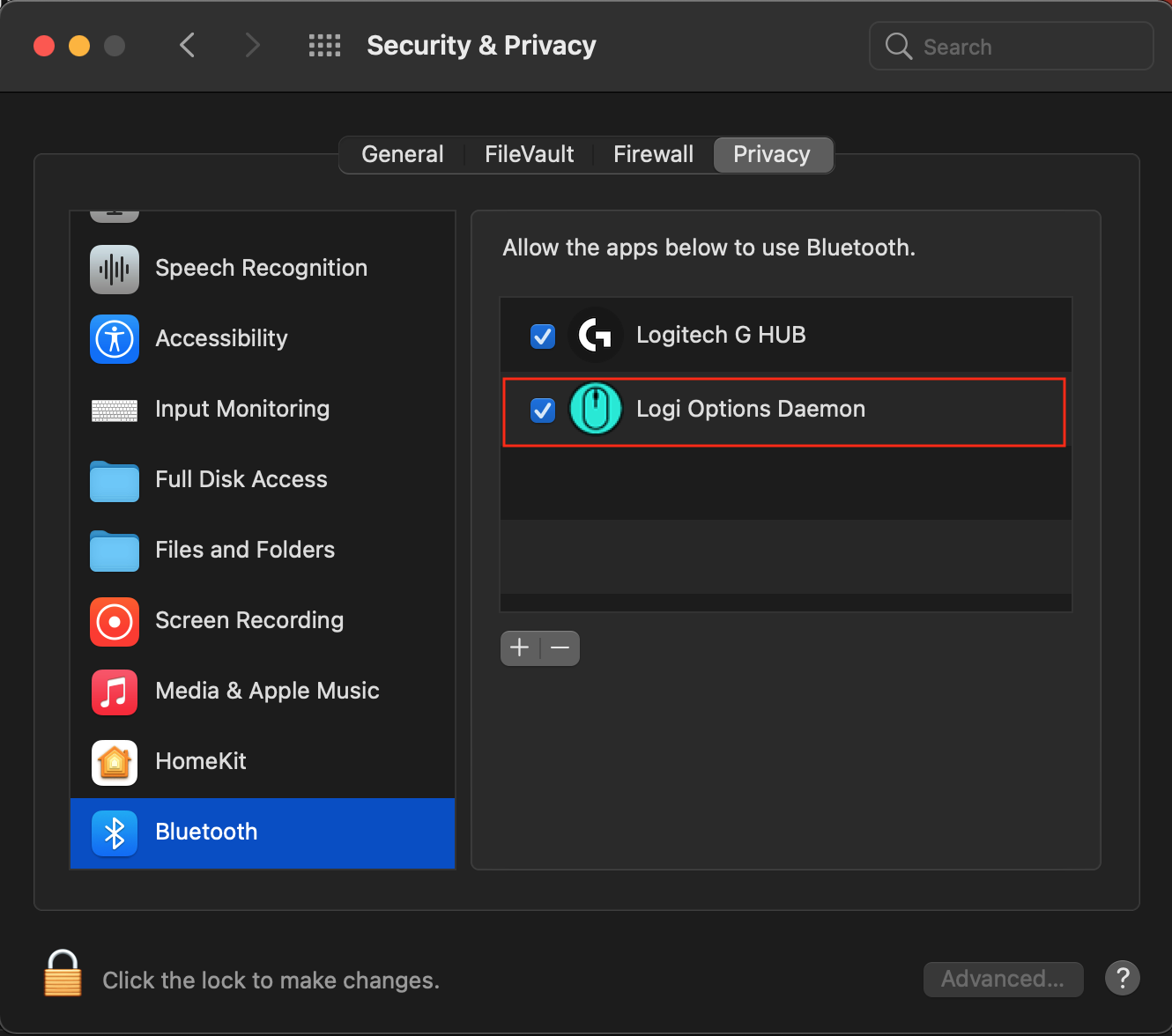

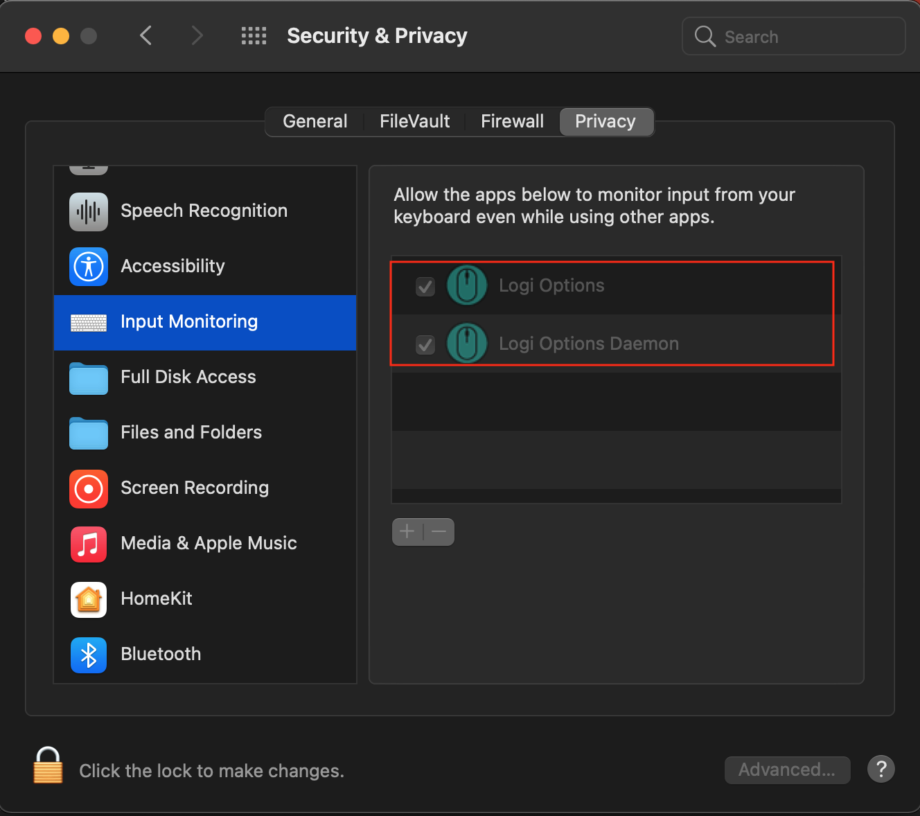

After updating to 11.2, the horizontal scroll, forward and backward buttons are no longer working. I have the mouse connected via Bluetooth.

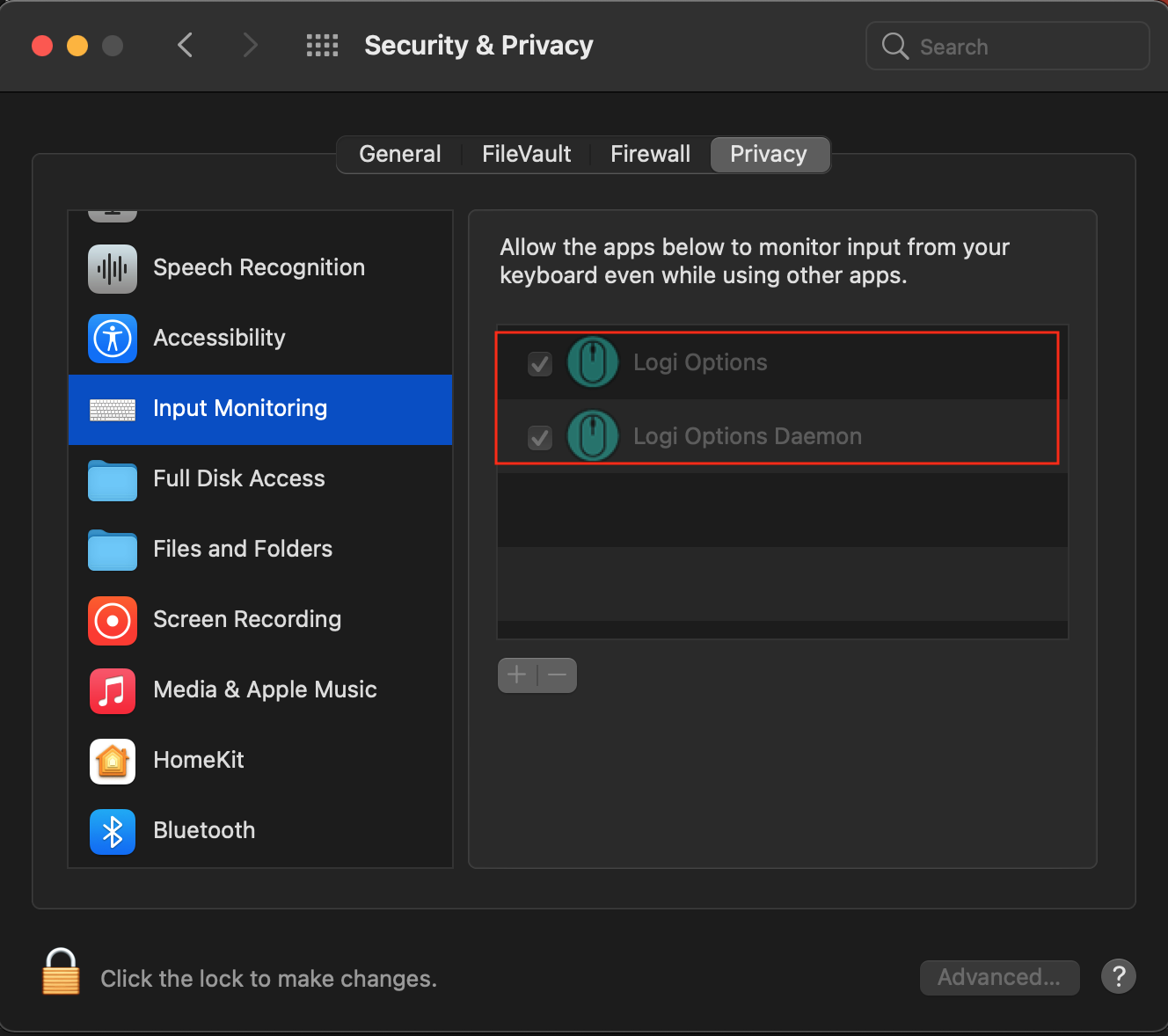

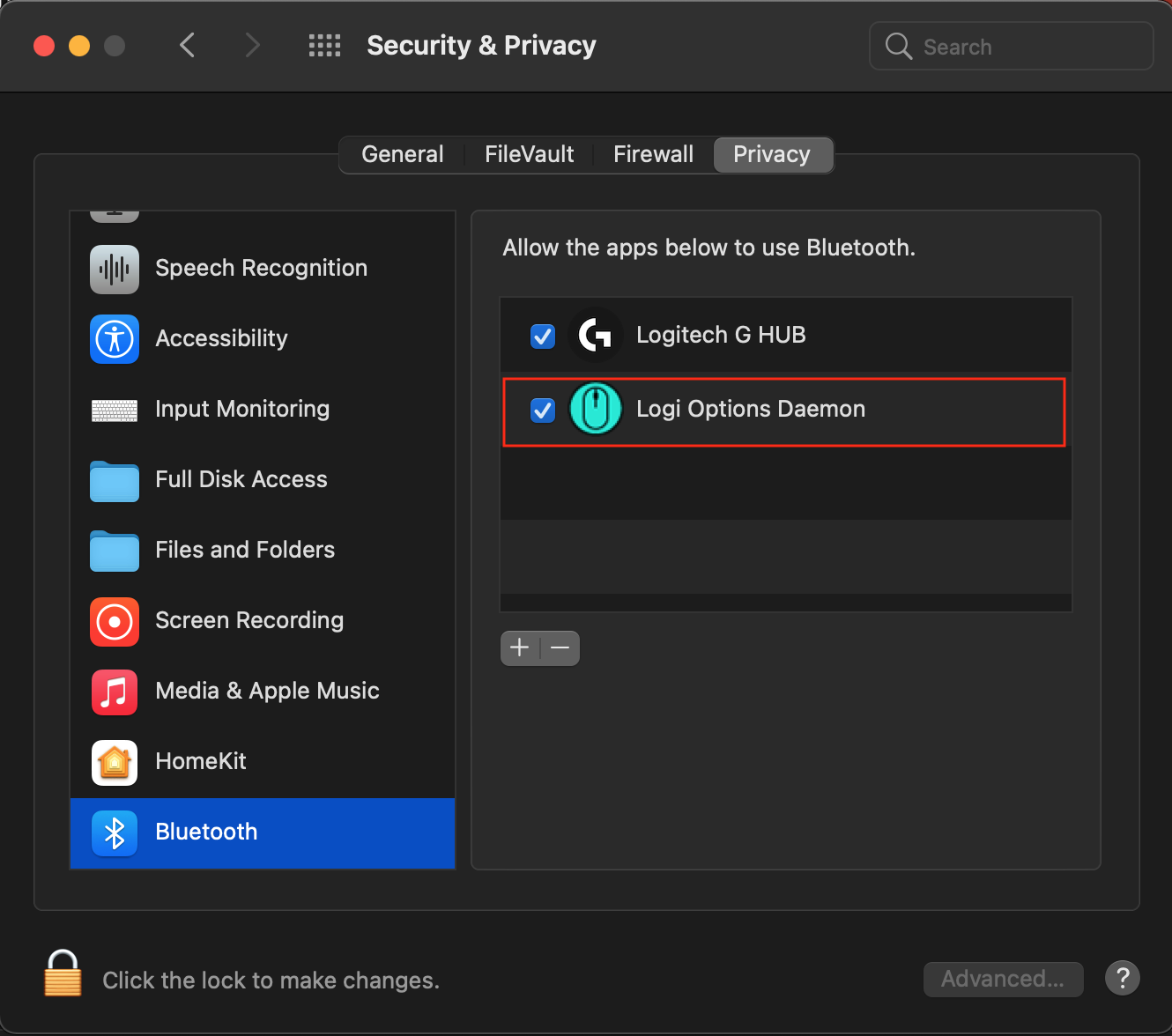

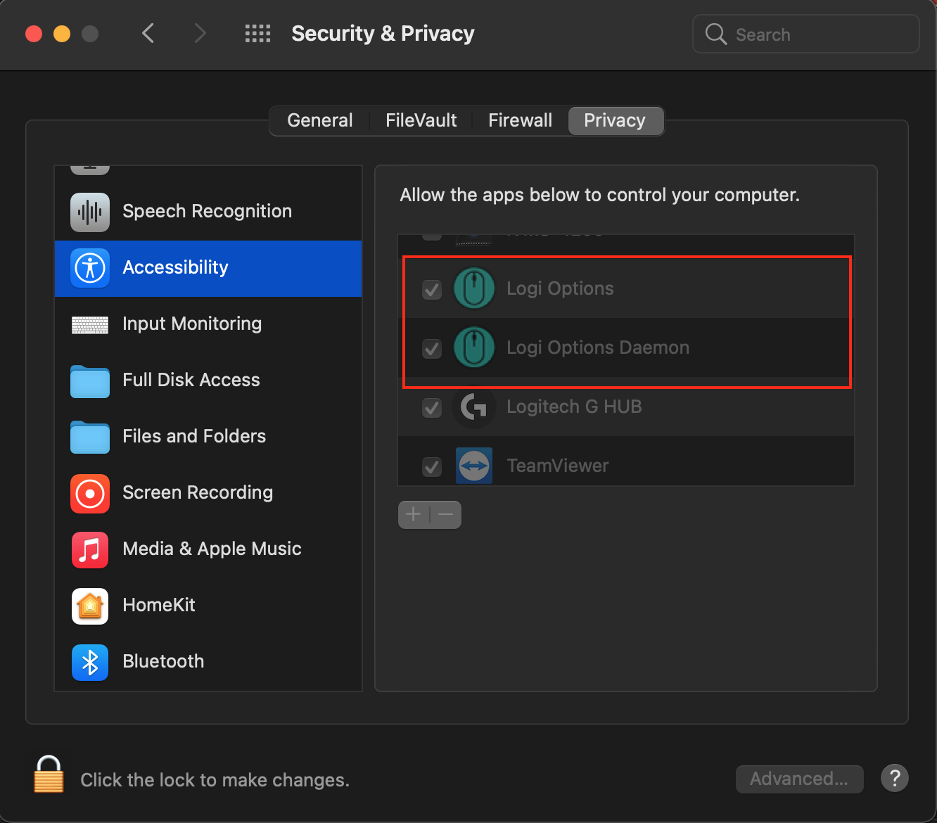

Logi Options and its daemon require permissions to control certain aspects of your Mac, described specifically in the Accessibility, Input Monitoring and Bluetooth modules.
So go to System Preferences, and make sure you add Logi Options in these modules, and make sure they are checked.
I have attached some screenshots for you to follow.
Screenshot 2021-02-03 at 6.31.24 AM.pngScreenshot 2021-02-03 at 6.31.33 AM.png

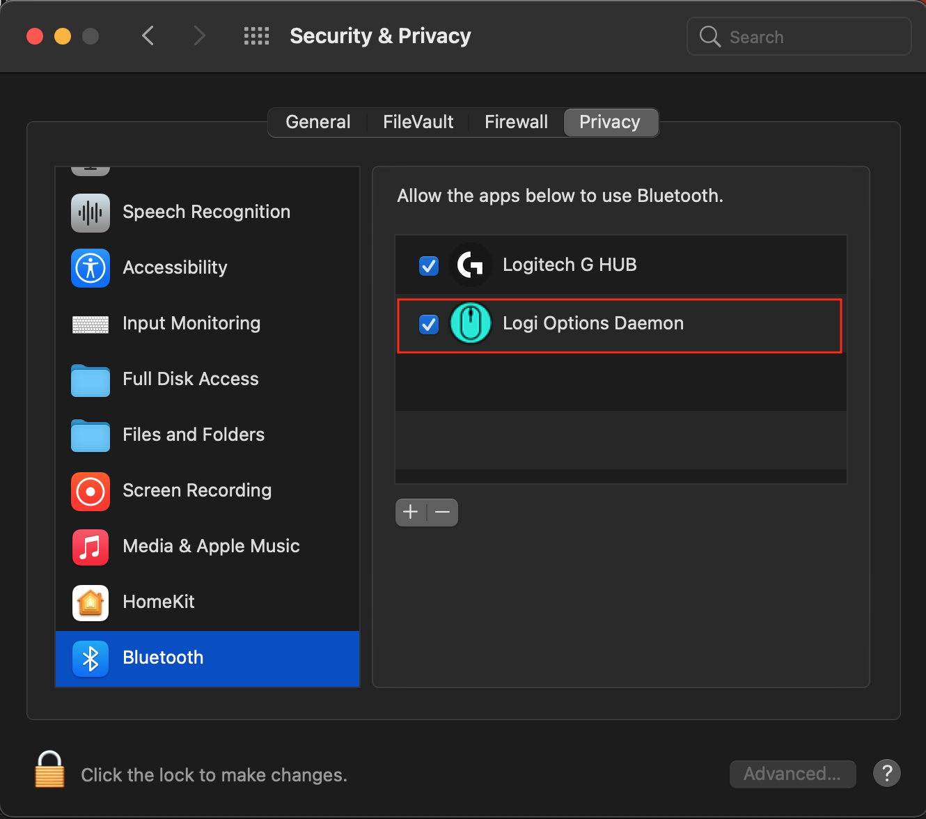

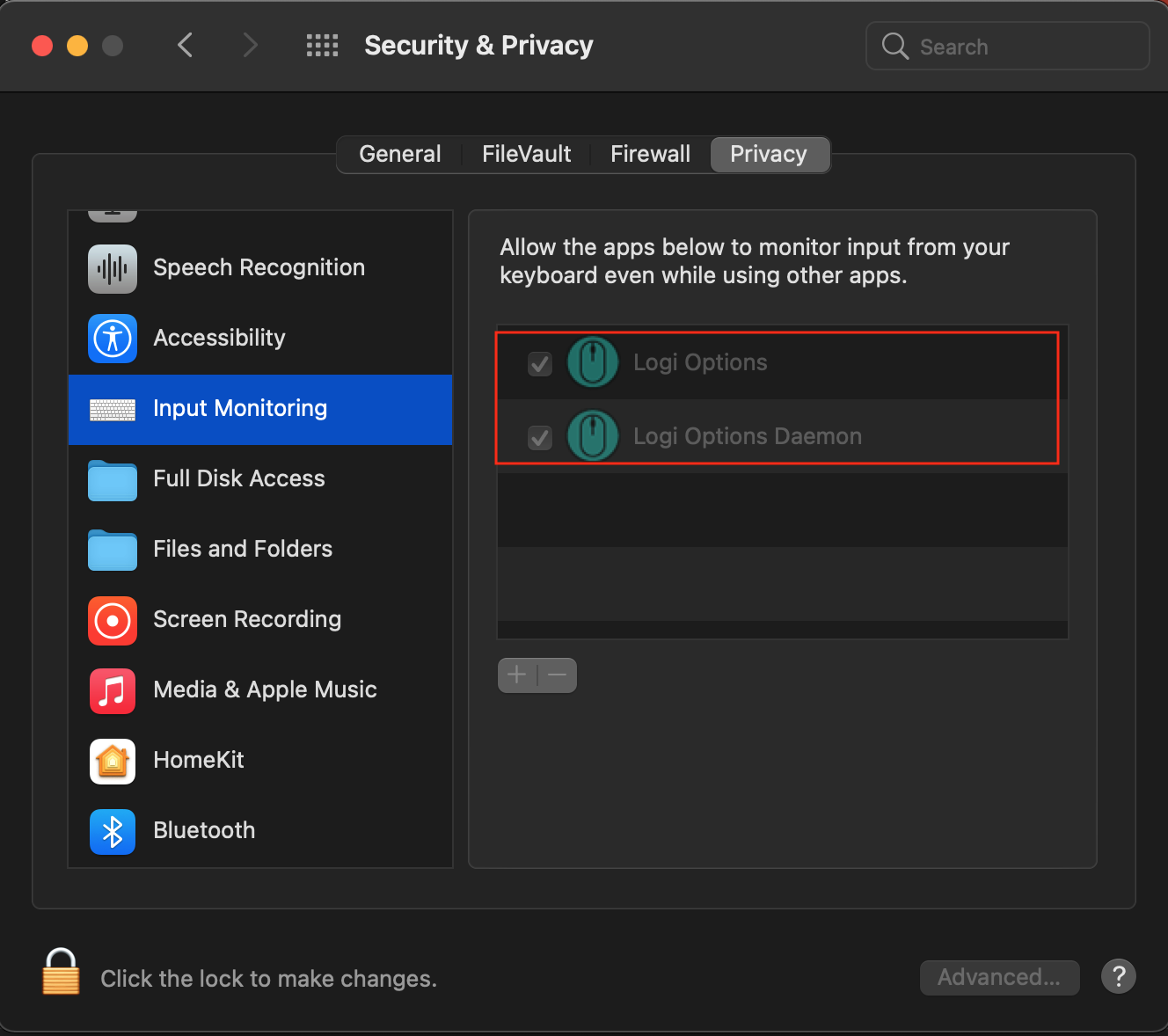

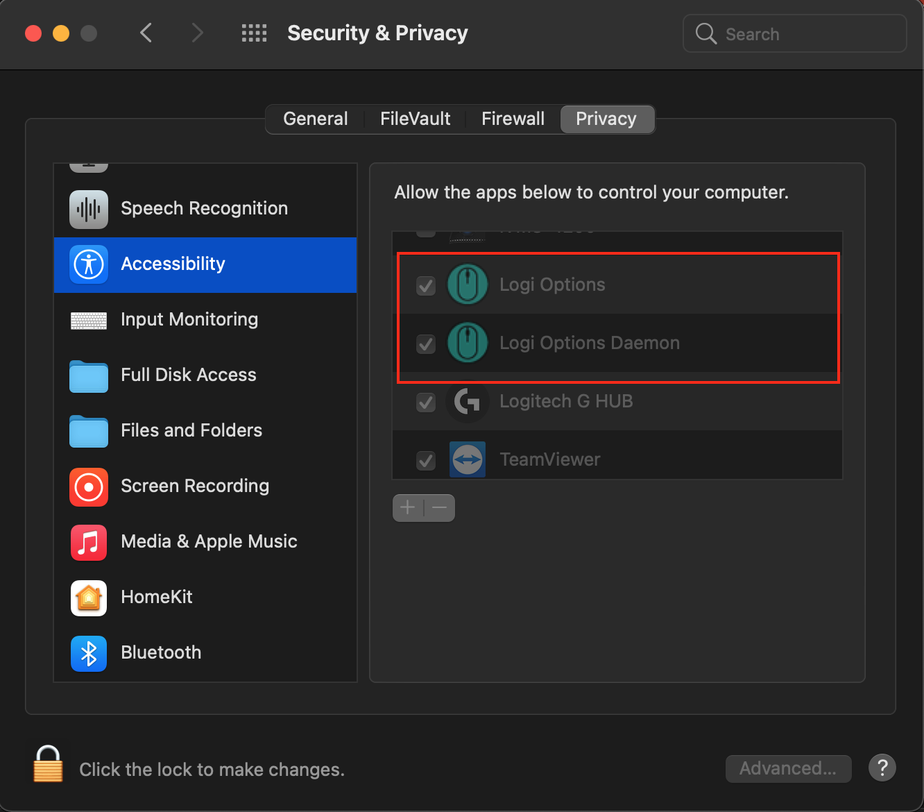

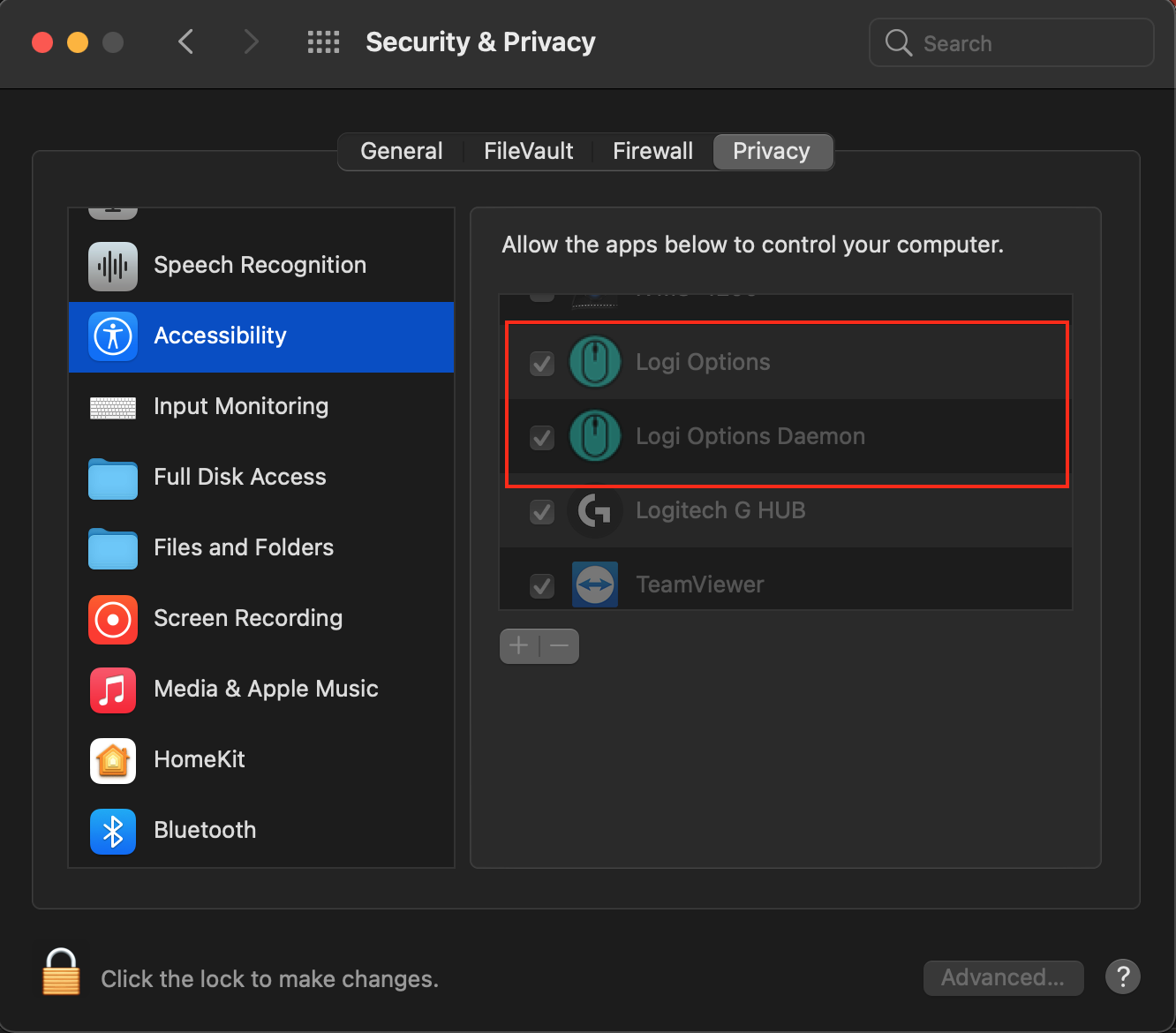

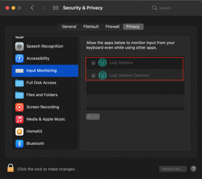

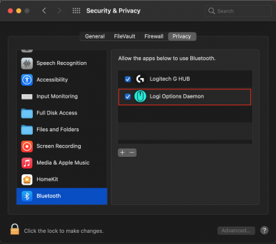

View attachment 1723832View attachment 1723830
Thanks for your screenshots. When I first installed the software, it didn't ask for these permissions therefore I had to manually add them back. But unfortunately this did not help reduce micro-stutters and did not solve the issue of Logi Options not automatically applying my custom settings after boot. I am still on 11.1 and going to update it in the next coming days.
