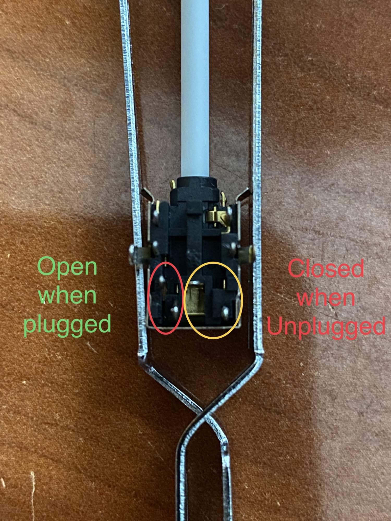

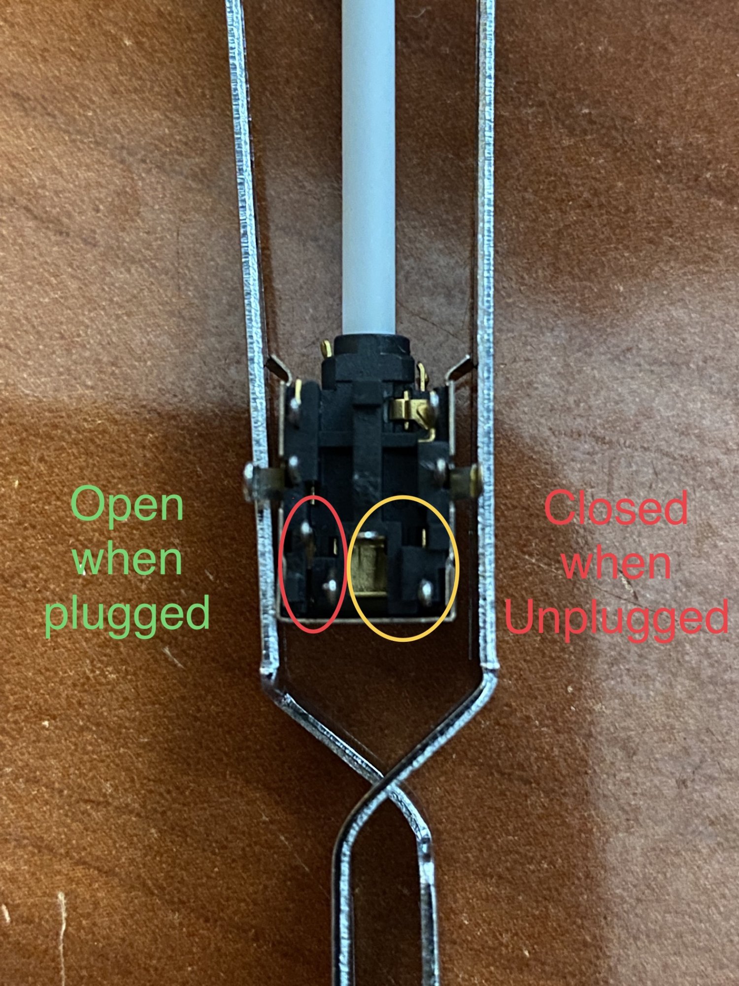

Just a follow up, had to sacrifice a PowerMac G4, it was a low spec model at 800MHz and the connector is black instead of white. Just as a reference, I found the pins that tell the OS if something is pluggged in or not.
Hi, From the picture above, I am to understand that both sets of pins behave in the same way. Meaning the are open when plugged, but closed when un-plugged. Otherwise I do not understand the logic as open when in = closed when out. No?
Oh man, it's been years since I fixed this port. As far the left and right channels I believe those are the pins above the circles, which one is left and right I do not know. Unfortunately, I should have specified what the port does when a jack is plugged in and unplugged as it's been so long that I have forgotten.
Thank you. I'll try with an oscilloscope, but I'm afraid the computer will mute the audio if speakers are not detected.
