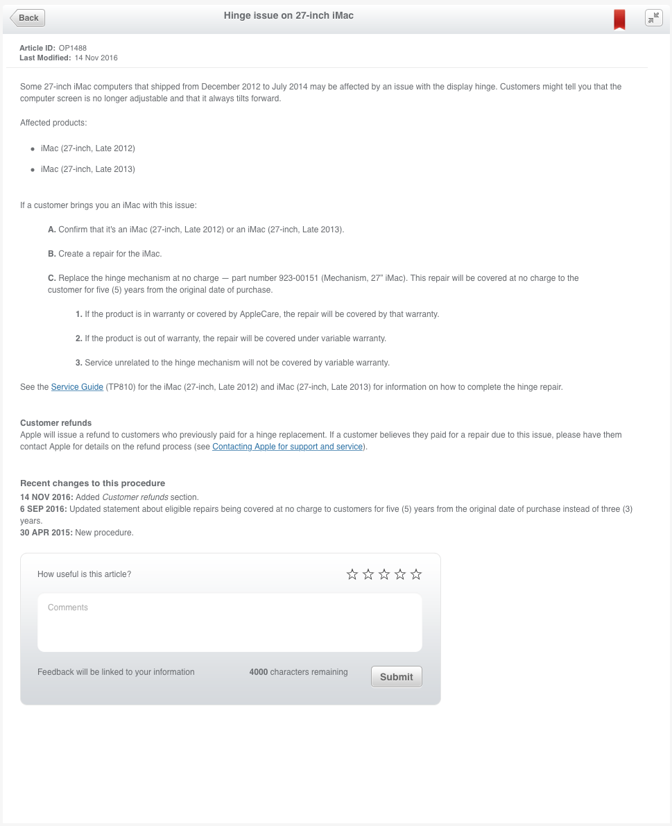

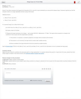

This is covered still. I have two iMacs in to a local Apple Store for this exact issue. See attached for GSX (Global Service Exchange) on this exact issue.

They won’t charge you for the parts or labour.
You shouldn’t share this.
Thanks for sharing this. My late 2013 iMac 27" has this problem - I heard the 'snap' one afternoon about 8 months ago! Sure enough, broken neck iMac. I have crammed several books of just the right height below the bottom of the screen and the foot. This keeps it propped up. I haven't wanted to take this in to Apple since I don't want to be without my computer for a week. But since I purchased in early 2015, I still have time to take this in and have Apple fix it. I do hope the 'fix' is now a permanent solution with an improved part.
Thanks for
[doublepost=1515636858][/doublepost]Thanks for that. With your attached note I was able to get it repaired free of charge. My 5 years expire in 1 month. Thanks again
Thanks for posting this... Trying to contact Apple local store now in regards to this.
The mechanism is unchanged with the replacement on the 2012 and 2013 iMacs with one exception: the retainers are now metal instead of plastic. Having worked on machines from 2014 and 2015, they came with the updated mechanism from the factory. I would imagine the iMac Pro has a better mechanism as well.
