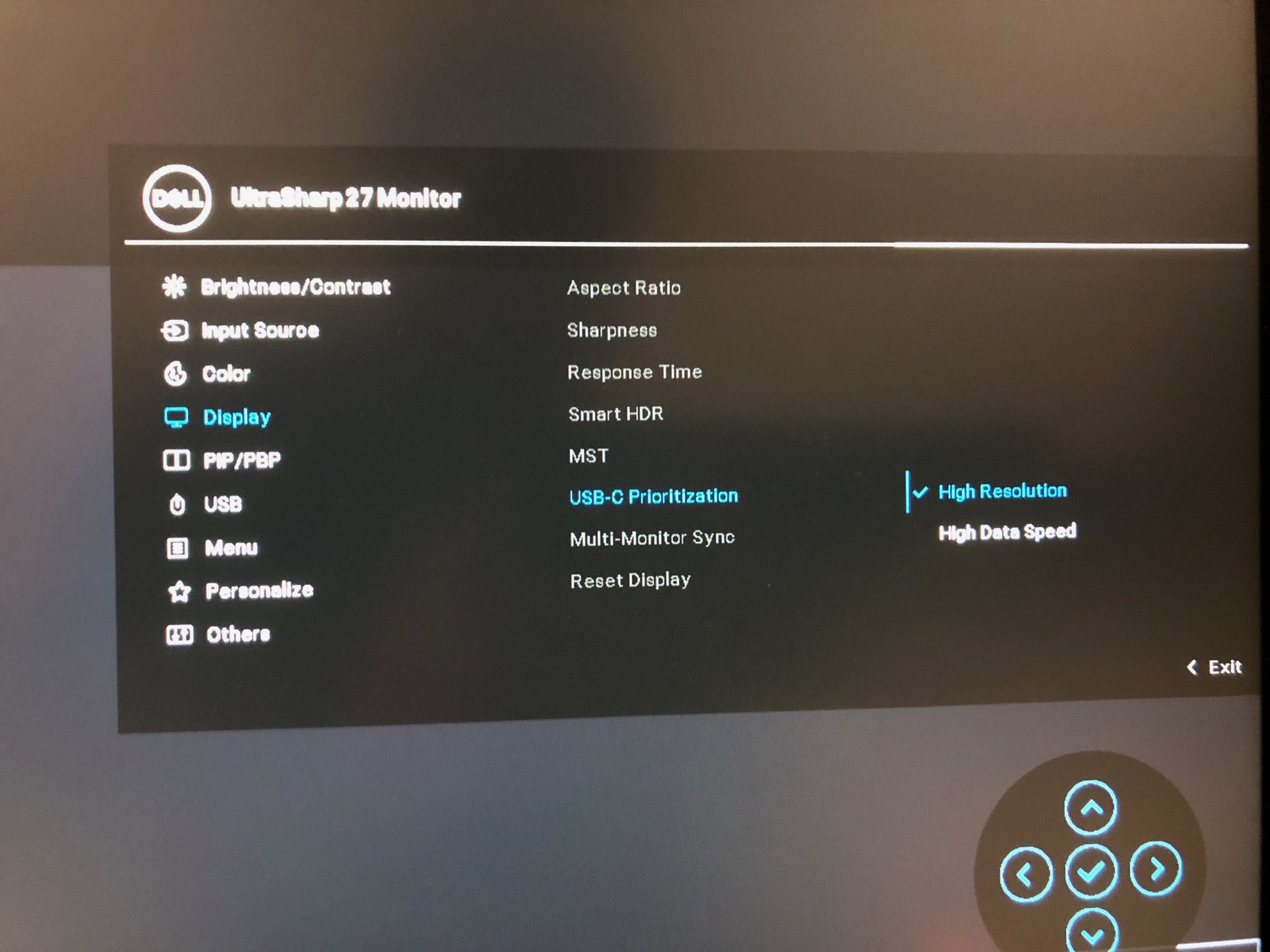

I'm using Macbook Pro 13 2020 (Intel Thunderbolt 4 ports) and DELL U2723QE 4K Display connected via USB-C.
I just updated to Mac Os Ventura and figured out that I cannot use HiDPI on 60HZ.
Usually, I set 2k HiDPI 60 HZ, but after the update, there was no same option no matter how I connect display HDMI or USB-C. Spent almost all day fixing it.
So what I did - I just changed in display settings (not mac os display settings) USB-C Prioritization from High Data Speed to High Resolution and that's it.
On Monterey everything worked well with High Data Speed
I hope this help
Thanks, this has resolved the problem for me using the same monitor. Funny, because I am sure I tried changing this setting before and had no luck, so not sure what I actually did. Curious to know how it affects data speeds...

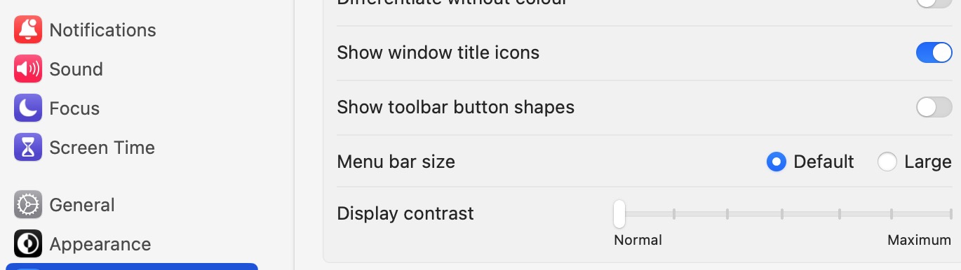

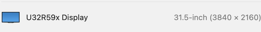

Struggled with this problem for a few hours as well using an Anker USB-C hub with a high speed HDMI cable.
The Macbook Air M2 was only recognising the Samsung 4K display as 1980 x 1080. Finally discovered I'd set the Menubar size to Large in Settings -> Accessibility.
After login and logout the display is now correctly seen as 3840 x 2160.
Bizarre.
