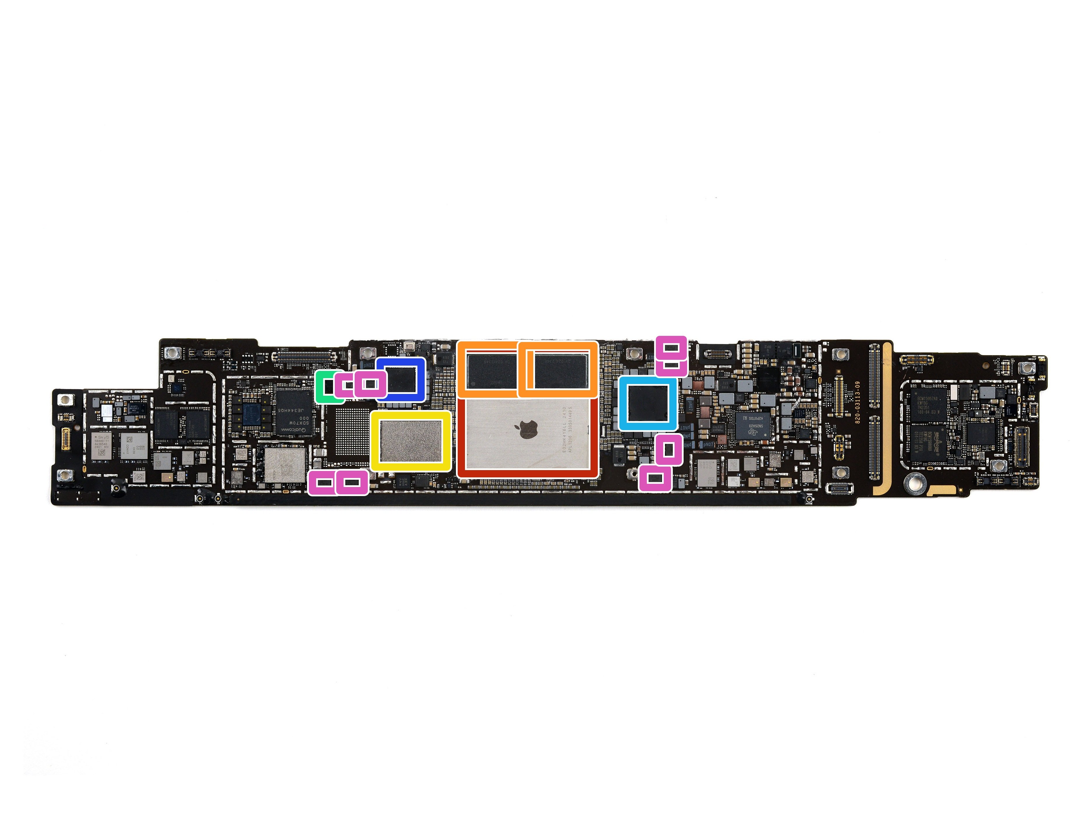

Based on Teardowns.
- The 2023 M3 Pro/M3 Max ships with LPDDR5 RAM.
- The M4 iPad Pro ships with LPDDR5X.
Obviously, one is a tablet where the other is a computer. We have a 50/50 chance that the 2024 M4 Pro/M4 Max ships with either LPDDR5X or LPDDR6.
The M4 iPad Pro's are just using LPDDR5.
The RAM chips clearly show the 5 digit FBGA code on them (D8DNV and Z8DMS).
Insert those in the Micron FBGA lookup table here and you get the following part numbers:
5 digit FBGA codePart numberMemory typeDensity (Gbit)
D8DNVMT62F1G64D4AS-026 XT:CLPDDR564 Gbit (8GB)
Z8DMSMT62F768M64D4AS-026 XT:BLPDDR548 Gbit (6GB)
Reactions: Chuckeee

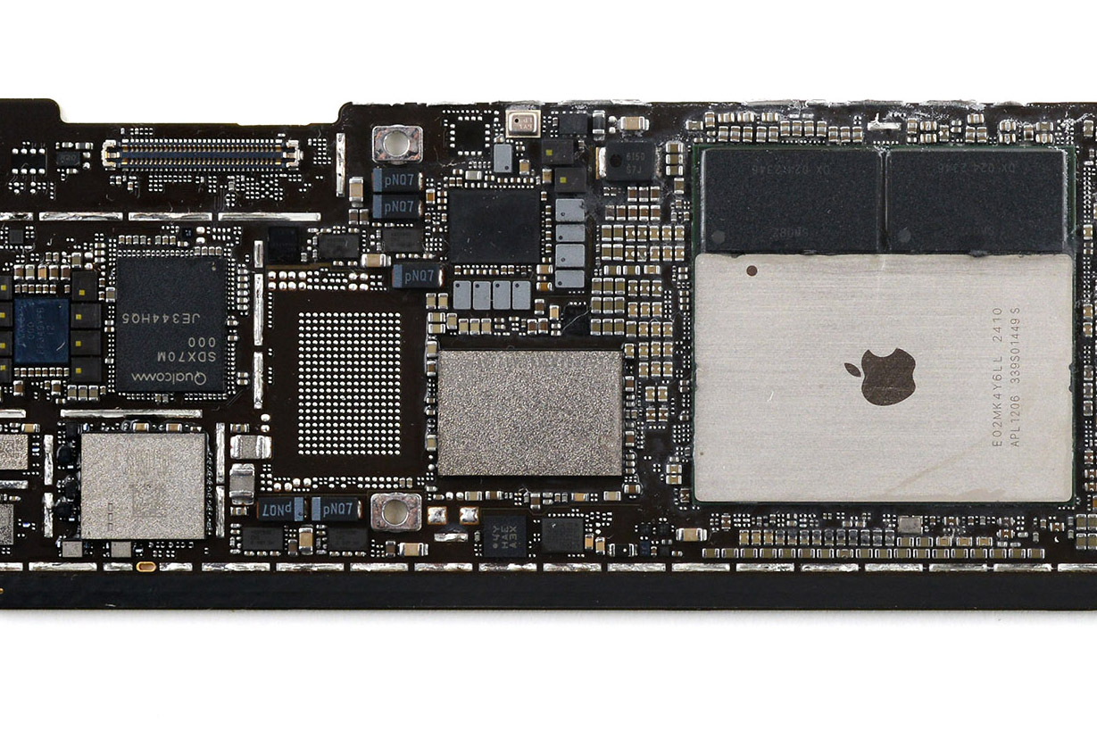

Incorrect. The M4 iPad Pro uses LDDR5X RAM. This information comes directly for iFixit
Apple uses Micron MT62F768M64D4AS-026 XT:B 6 GB LPDDR5X SDRAM memory
Pressure
macrumors 603
May 30, 2006
5,178
1,544
Denmark
The image I posted is directly from the iFixit teardown 🧐
It clearly says Z8DMS as the FBGA 5 digit code on the memory chips.
The part number for Z8DMS is MT62F768M64D4AS-026 XT:B, which is what iFixit clearly has right but that is LPDDR5-7500 and not LPDDR5X.

Yeah, that makes sense, thank you.
It is consistent with a 256-bit bus and newer LPDDR5X-8533. The RAM itself is 13% faster and the wider bus would double the throughput.
I also hit confused first, because that looks like quite a jump, but it makes sense.
Yeah, that’s a logical explanation.

@leman's answer is correct. The direct answer to your question is "no", you can't do it just by raising clocks. Nor would you want to, as your imaginary silicon would have a very very high power budget...
According to Wikipedia, they could have gone all the way up to LPDDR5X-10700 (where LPDDR6 will start). But yeah, all the power data for this stuff is confidential, and who knows what sort of production volume those parts are at. I’m happy with LPDDR5X-8533 for the Mini, but I’m hoping for 9600 or 10700 for the Ultra.
