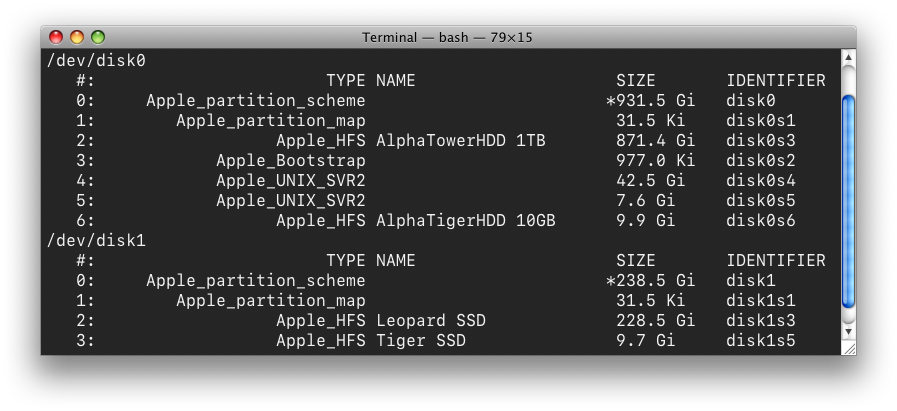

Going back to the beginning now... The first line on your screenshot of the OP indicates it wasn't able to read/write 32MB(?) of data. This could be due to the bootstrap HFS partition being too small?
Huh.
From what I saw in GParted, I thought Yaboot only took a couple hundred kilobytes of space. So, I thought it was OK to make it small.
Guess I was wrong.

No, you're right. It doesn't need to be any bigger. I confused myself (MorphOS required a 64MB boot HFS partition).

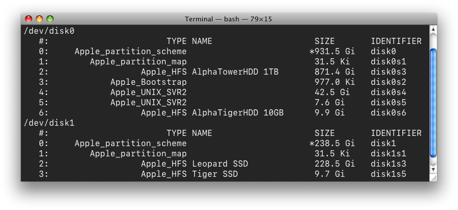

Here's a screenshot of my partitioning on the DC G5 (11,2). Slot A is a 1TB WD Green HDD with triple boot (Ubuntu Mate 16.04, Tiger and Leopard), Slot B has a 256GB Kingspec mSATA (in a 2.5" caddy) with just Tiger and Leopard.
When I setup this Mac, I performed 6(?) different PowerPC installations (3x G5s, 3x PBG4s) around the same time and they all had slightly different partitioning configs.
I can't be sure exactly, but looking back at my notes for this G5, it looks like I used Leopard's Disk Utility to initially setup the partitioning and installed Leopard first, then divided things up during the Mate installation. I believe I divided up the partitions again and added a 10GB volume for Tiger last.
You've got yourself a real head-scratcher of an issue here. You may need to seek advice with the Ubuntu/Mate/PPC gurus. Either on their forums or on IRC?
