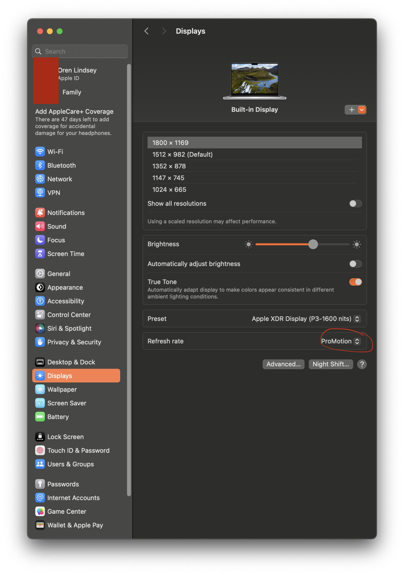

A "Fishrrman dumb question":
With Sonoma, where is the option to enable/disable Pro Motion?
I looked in "displays", and can't find it.

You’d only see that setting on M1/M2/M3 14 or 16 inch MacBook Pros.
OP wrote (regarding Pro Motion):
"You’d only see that setting on M1/M2/M3 14 or 16 inch MacBook Pros."
I have a MacBook Pro 14" m1pro.
I still can't find where to change the setting (in Sonoma).
Can anyone help?
Can anyone help?
It's in Settings > Display > Refresh Rate
Reactions: Fishrrman

Oren wrote:
"It's in Settings > Display > Refresh Rate"
Thanks for pointing the way.
I looked in MY display settings, and I had that same popup menu set to "60hz".
BUT... with 60hz selected, there's no indication of "Pro Motion" to be seen anywhere else, nor any cluse how to make it active.
Only if you "mouse down" on the popup does it become visible or choose-able.
Thanks again.
