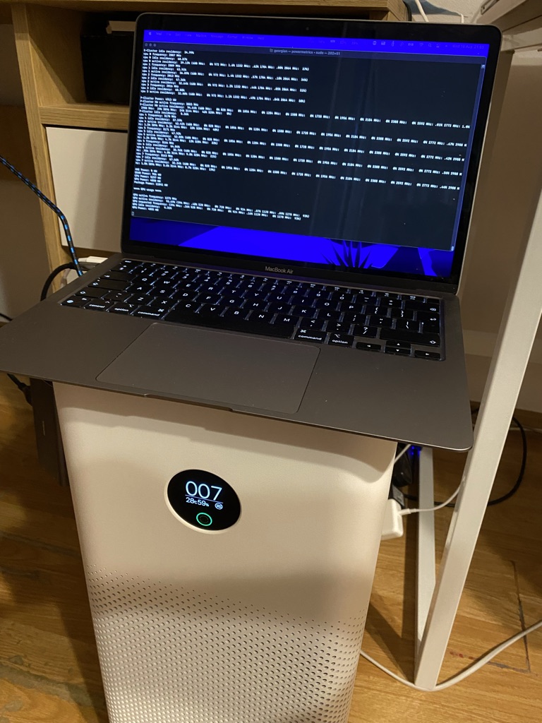

I did another experiment. I wanted to play some dota2, but my gaming laptop is in for repairs (battery change), so i played on my Macbook Air. Initial game was as the rest of them, high fps during the first 5-10 minutes then crawled to 40FPS and even lower in team fights.
I have a Xiaomi air purifier so i put the laptop over that purifier exhaust as you can see in the pictuer below.
The result is that i had constant FPS and powermetrics reported a constant 11W draw (opposed to 4W).
The room temperature is 28C.
I am still having some doubts if something is messed up within the laptop or it's just the room heat.
I also remembered something, before when the laptop was on power sometimes i used to feel the case a bit tingly. Now i can't remember the last time i felt that.
It's the ambient temperature simple as that, placing the Air on the air cleaner clearly illustrates this. The Xiaomi can push a fair volume of airflow (I have one) out the top cooling the chassis of the Air which helps to cool the internals. The tingling is related to earthing and not uncommon for Mac's to do so.
Simply elevate the rear of the Air off the desk and use a USB Fan or try a cooling pad that can push 100cfm preferably with a single large fan. This should help to maintain FPS, the Air is passively cooled therefore the ambient temperature is a major factor. I'm not far behind as local temperatures are around 32C with the AC bring the temperature down indoors to 26C/27C, however from experience I know that passively cooled systems struggle in warmer climates so opted for the M1 MBP.
