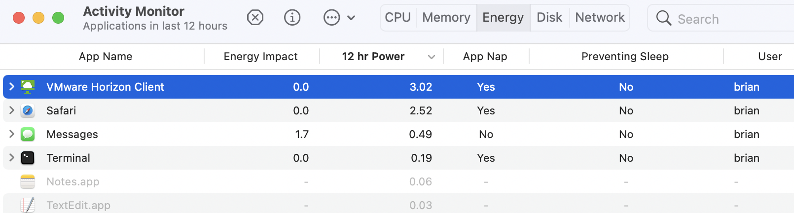

Here is my experience and it is good enough. Using Zoom and VM Ware Horizon, I can sign into work at 7:30 ish and make it to 4:30 EASILY on battery and still have enough to spare for using the computer in the evening for other things. Like the iPad, the M1 battery is an all day battery. And, that is all it has to be.
