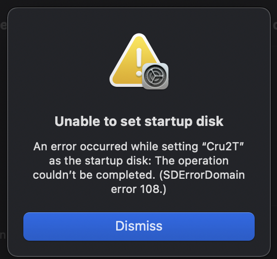

So I got a crucial nvme and the owc name express. Formatted to APFS and loaded Big Sur onto it. Rebooted holding down option key did not show it. Tried to select it as a startup disk in the pref pane and got this error:
help?
help?
Bootable drives have been hit and miss on the M1. Even a drive that works today may end up refusing to work tomorrow.

I was impatient.
I reformatted the drive and reinstalled Big Sur. I waited for the the install to complete. There were three big pauses and the first time around I thought the process was done when it was not.
During the initial install, when it finishes it asks you to reboot. You must say yes and wait (I tried rebooting manually so I borked the install) When the system finally finishes up, the screen goes dark gray(not back).
It hangs out here for awhile and then reboots. The progress bar is slow but when it completes, again the screen goes dark grey.
Again it reboots, the progress bar moves along a little more quickly, but still slower than normal. Halfwaythrough, the screen blanks. and then it comes back. The system reboots a third time.
Now the new config screens are presented-localization, assisted features, password. appleID, etc.
Now the external drive works.

Glad you got it figured out. Many people on the forum over the years have made that same mistake. It happens to the best of us at times.
